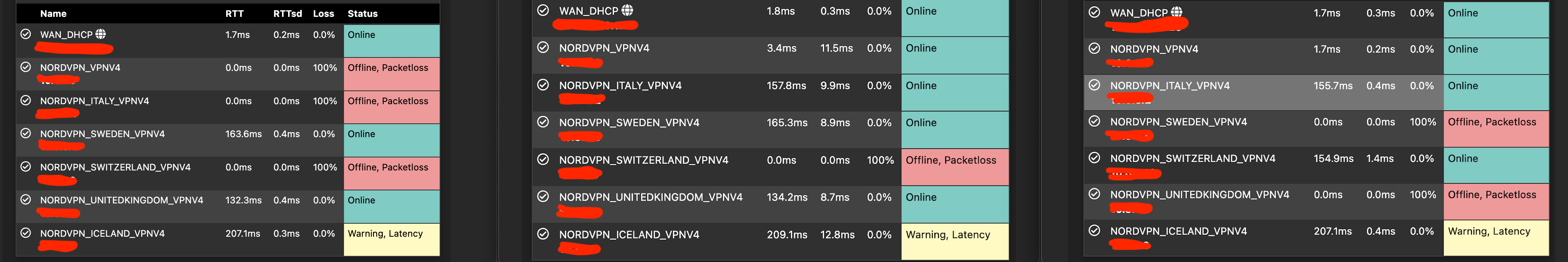

  • OpenVPN RTT Way Too High
    UmerFU
    @viragomann alright, I looked up for MTU/MSS keywords under OpenVPN for system logs in pfSense, and keep seeing this pop up. [image: 1691521933819-26ddef79-e9ae-4386-888d-bf5ab2d9a251-image.png] Does that tell us anything that we need to know? From my understanding, my PC has a 1500 default MTU, and we probably want to keep it that way. If not, I'm open to making changes. As for pfSense, which MTU/MSS would I want to change? Is it the OpenVPN gateway or my WAN? It's blank in there for it all, and I'm assuming that's also set at 1500? The screenshot above mentions the payload being 1600 and 1768. Does that mean I have to increase my MTU or something? I'm sorry; first time dealing with this stuff, and I really appreciate your input.
