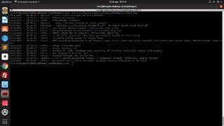

    @Simbad said in Snort v3.2.9.9 Package Update - Release Notes (for pfSense-2.4.4 RELEASE): Thank you, I'll bury my head in logs like an ostrich in the ground,... [image: 1566154485077-7566b68f-a11d-4f84-9fca-df8455d0a495-image.png] I would recommend first temporarily turning off the option for sending alerts to syslog. Do that for all interfaces and then restart Snort on all interfaces. That will make for a quieter log where other messages will more easily stand out. Once you track down the problem with the troublesome interface, you can re-enable the syslog alert output.
