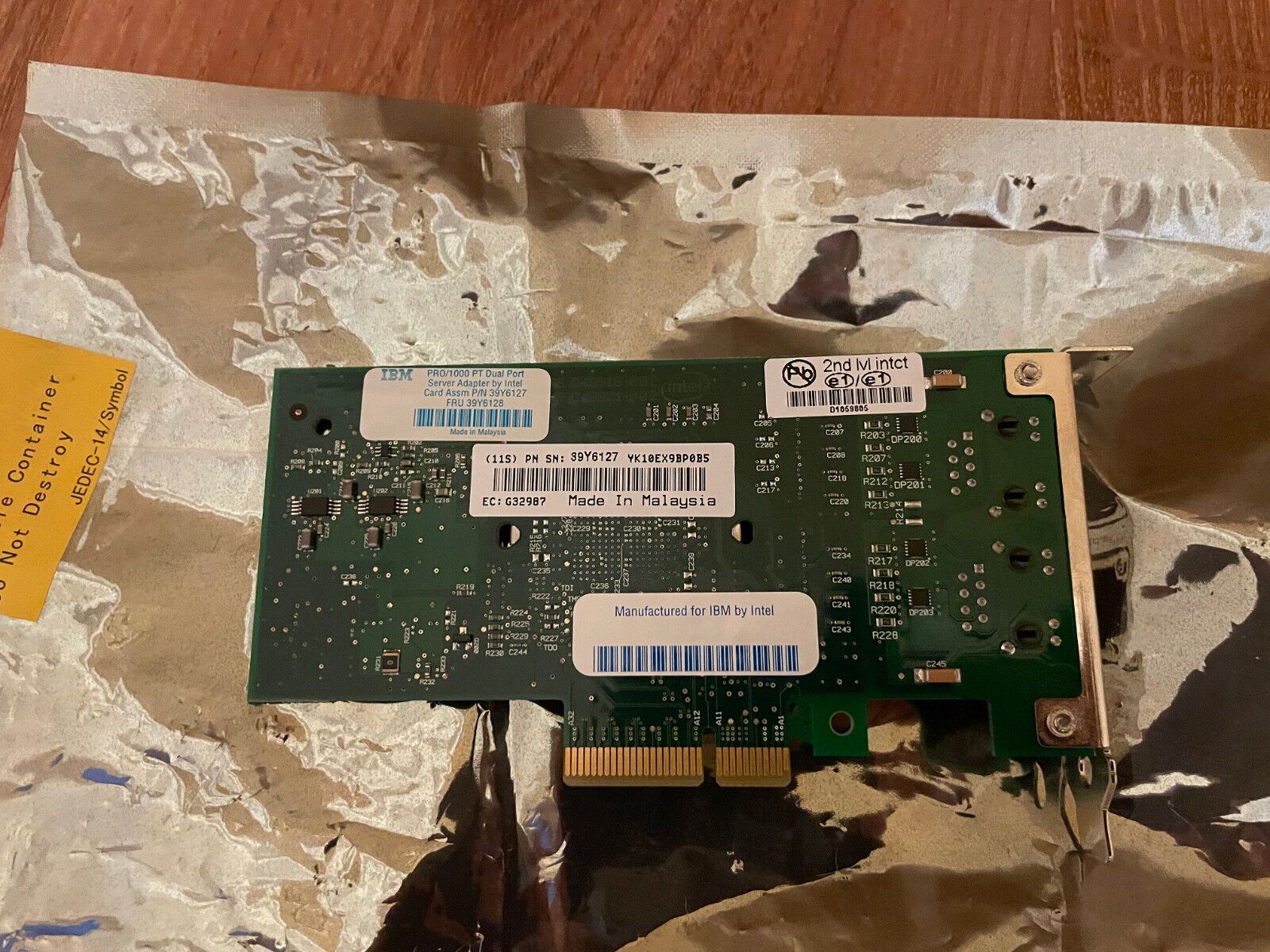

  • Intel IBM PRO 1000 PT Dual Port Server Adapter 39Y6127 FRU 39Y6128
    670 Views
    @abdenour said in Intel IBM PRO 1000 PT Dual Port Server Adapter 39Y6127 FRU 39Y6128: @stephenw10 said in Intel IBM PRO 1000 PT Dual Port Server Adapter 39Y6127 FRU 39Y6128: Yes, I would expect it to be. Thank you Intel FreeBSD EM driver Scroll down and find your adapter is well supported by the em driver. If you comes into trouble you should perhaps have a look for an original Intel firmware image, you could try to flash on this card.
