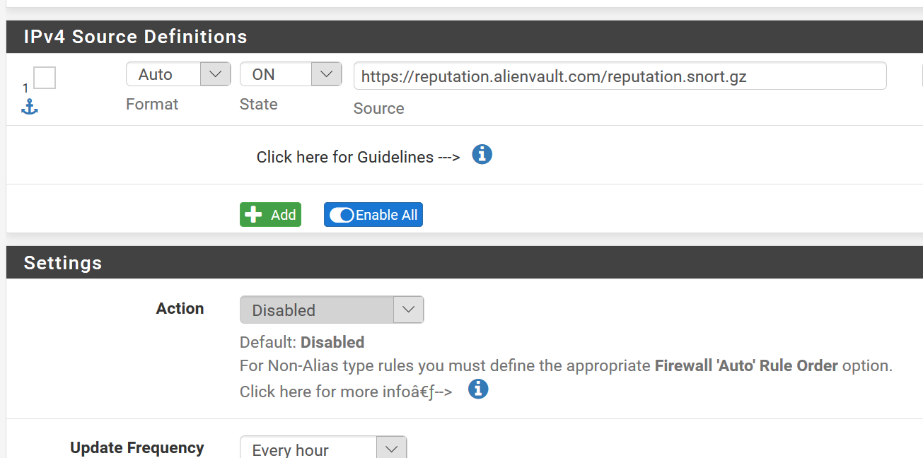

    @iyad:
    Please i got this message and i can't find the issue
    ===[  IPv4 Process  ]=================================================
    [ forbid ] Downloading update  .. completed ..
      Empty file, Adding '1.1.1.1' to avoid download failure.
    [ Badsites_custom ] Downloading update [ 05/14/18 12:52:00 ]connect: No route to host
    . completed ..
    [ pfB_Badsites Badsites_custom ] Custom List Error ]
    In the IPv4/6 tab, click on the blue infoblock icons and you will see the correct format for adding URLs. It looks like the pfSense box can't connect to the URL you entered:
    Local file:    http(s)://127.0.0.1/filename  or  /var/db/pfblockerng/filename
    For the customlist, you need to enter one IP per line (also click on blue infoblock icon for details)
