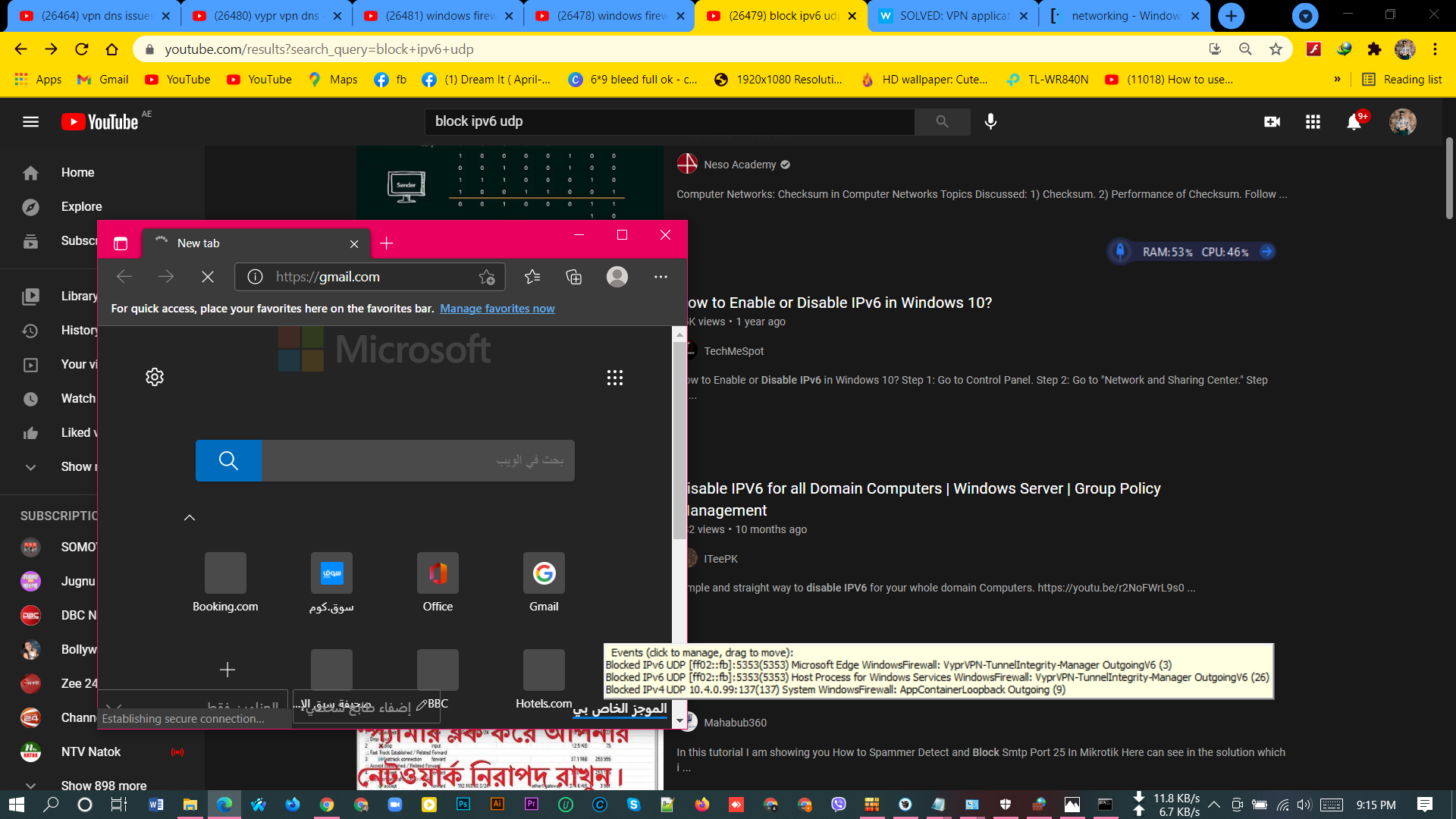

  • Wireguard not access gmail
    876 Views
    cmcdonaldC
    @gertjan Could also be TLS failing because of MTU issues.
