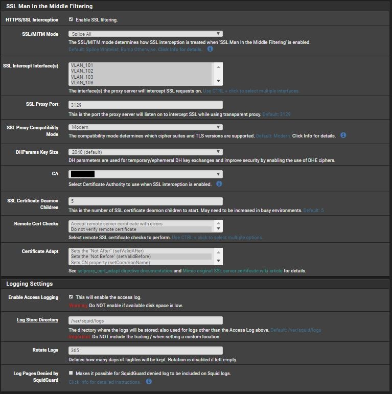

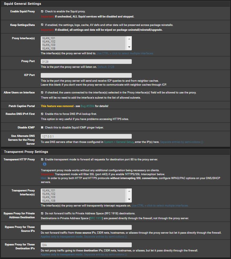

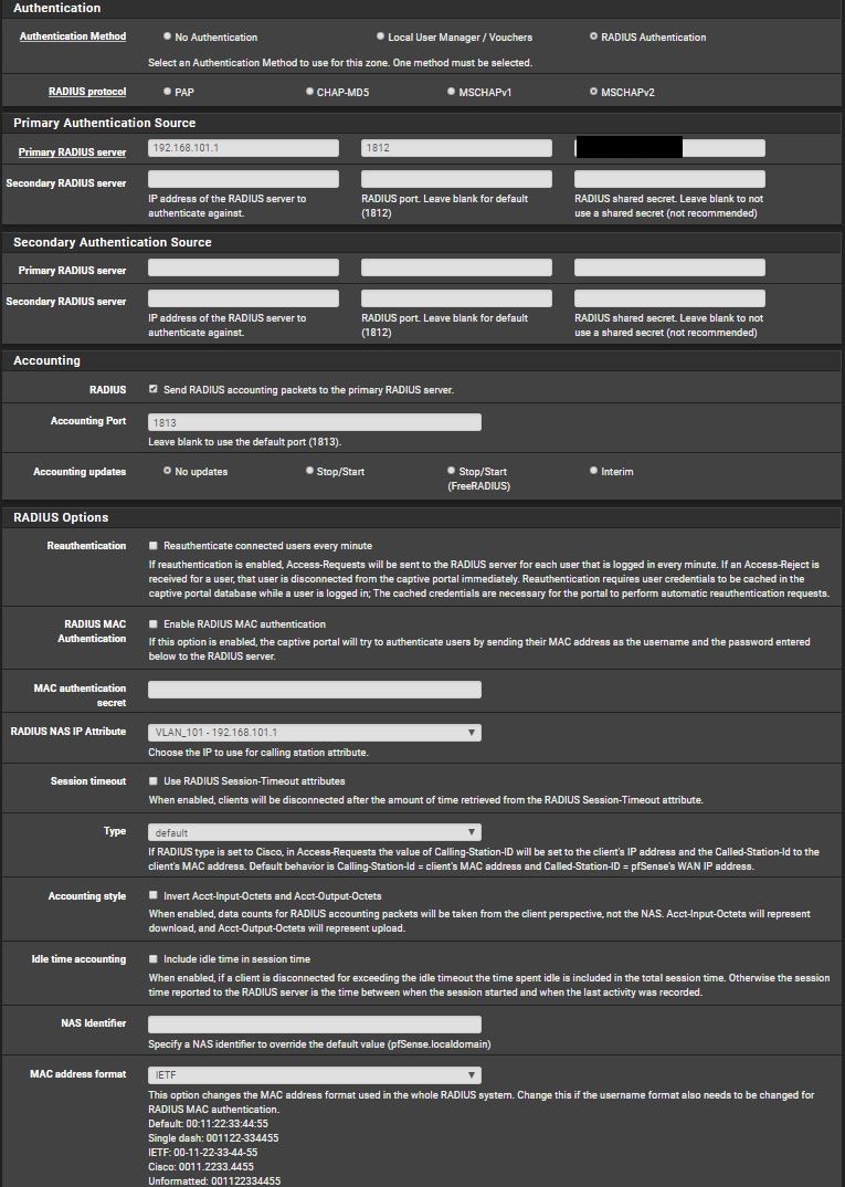

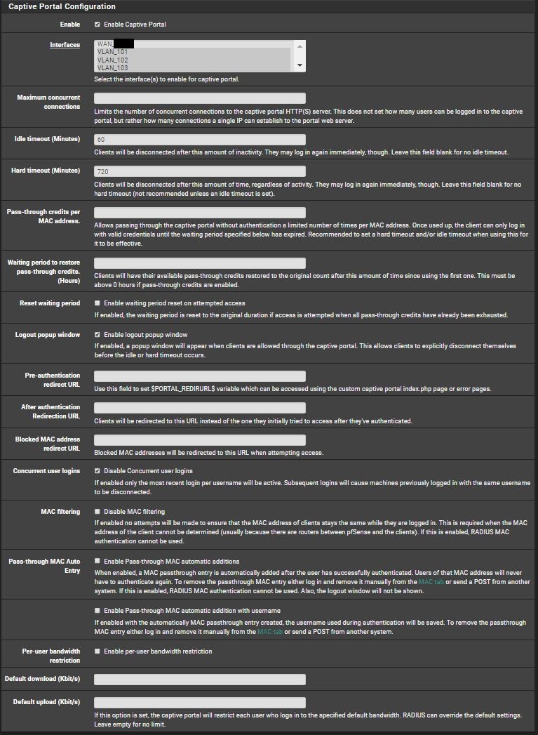

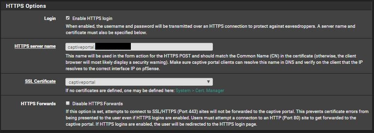

        Vlan 101-103 are on “CP1” and Vlan 108 is on “CP2”

          Why did you post your CP settings of one of your CP zones ?
          @jimp said in Multiples CP Not Working:
          That’s a squid problem, not a captive portal problem.
