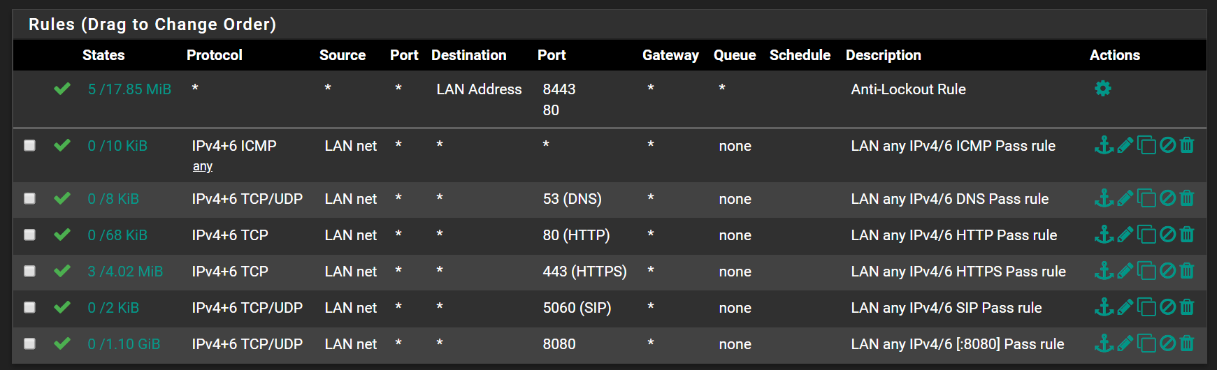

      Hi all,
      I am wondering why my upload speed in my PFSense box is slow.
      I am configuring my PFSense box and have ran a speedtest on ookla.
      My Ping 11ms and download 192.77 Mbps are OK but my upload speed is really low (0.8 Mbps).
      Currently I have my old network running in parallel and the result are pretty much the same except I get 19.29 Mbps upload. (as expected)
      I have a 200/20 Mbps connection. So I guess I can rule out my ISP.
      I browsed this forum and found that the MTU could cause this. So I determined the max MTU before fragmentation to be 1472 thus I have set 1500 in the WAN interface page.
      These are my LAN firewall rules. No traffic shaping done.
      I also tried different interface combinations (since I have 6 in total) for WAN and LAN but they all result in the same low upload speed.
      I started from a fresh install running version 2.4.3_1.
      System : Gigabyte z370n-wifi, i5 8500, 8Gb DDR4 and Intel i350-t4 NIC.
      Thanks.
      • JKnottJ Offline
        JKnott
        What type of Internet connection do you have? 1500 is common for cable, but ADSL usually requires 1492.

        • P Offline
          Patpop
          I have cable... determined the MTU using the ping method.
          Ping www.google.be -f -l 1472 is the highest value ping command without fragmentation.
          • JKnottJ Offline
            JKnott
            One other thing, a slightly smaller MTU will not cause a significant decrease. The problem likely lies elsewhere.

            • H Offline
              heper
              Wiring issue? Duplex issue?colored text
              • P Offline
                Patpop
                Found the problem. Purchased 5 cat7 patch cables. Tested them all with a wire ethernet connection tester and all were fine but 1 of them fails somehow when in use. Replaced it with an other one and the issue is solved. Thanks for all the help.
