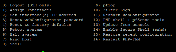

      Web GUI does not come up, or I cannot ping after installing a package and it froze. Upon reboot, its in this state. I can get to the interface via Serial but no options work to factory reset it, load recent configurations, etc. The physical reboot button in front doesn't do anything either.
      I keep getting the error attached 0_1537909193526_error.txt
      What are my next options here? Is there a way to load defaults via USB or reinstall? I can't seem to find a viable solution at this point
