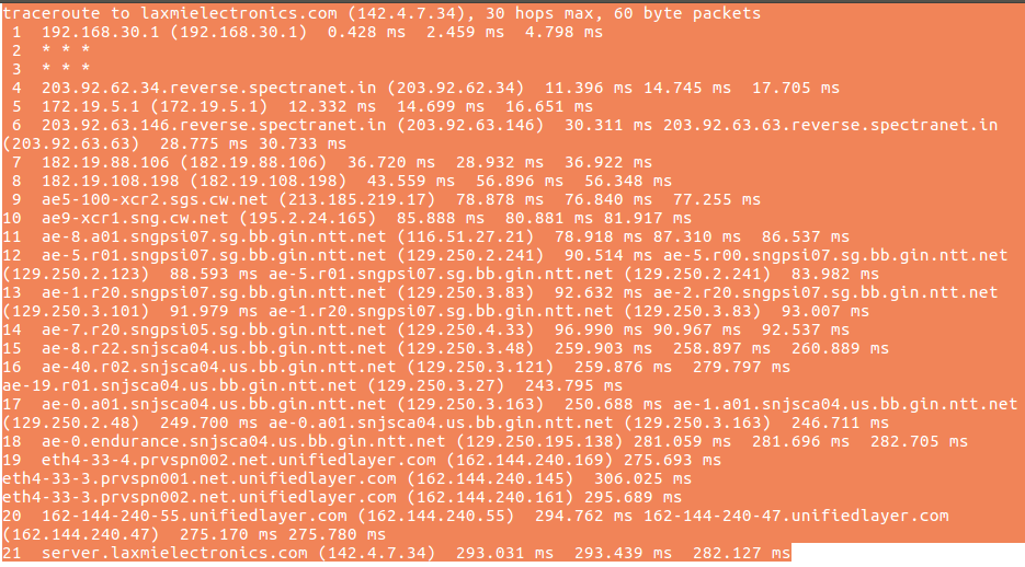

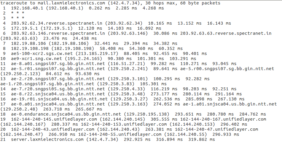

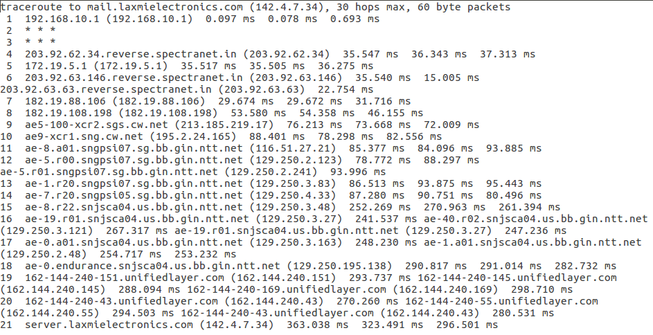

        Traceroute Output.
        LAN Traceroute
        Marketing Traceroute
        Purchase Traceroute
        Lokesh Kamath
          Does it work when you did those traceroutes?
          slkamathS 1 Reply Last reply Reply Quote 0
          • slkamathS Offline
            slkamath @johnpoz
            @johnpoz
            Thank you.
            Yes it is working when i give traceroute mail.laxmielectronics.com.
            Lokesh Kamath
              Well there you go then you have your root cause - users not using your connection when they fail ;)
              The HUGE delays in that network could be a problem, or more than likely that isp they are going out blocks outbound 25.. If that is the port your talking to vs say 465 or 587 which are typical ports talking to smtp server when using encryption..
              So now you need to figure out why that one that was failing was using that other network..

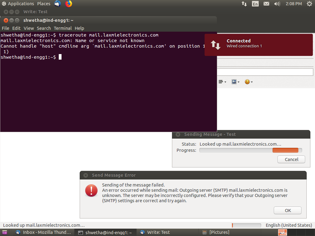

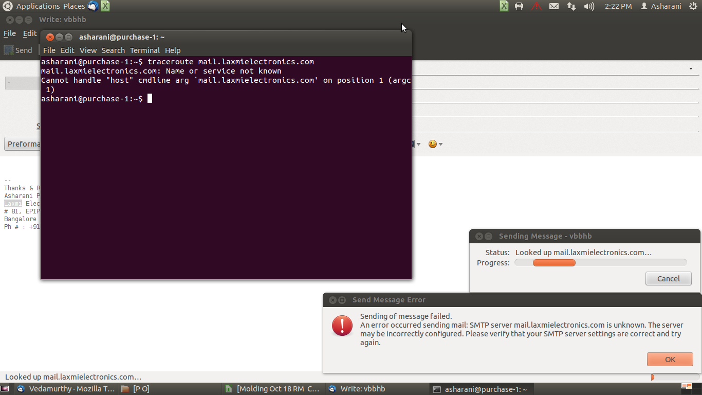

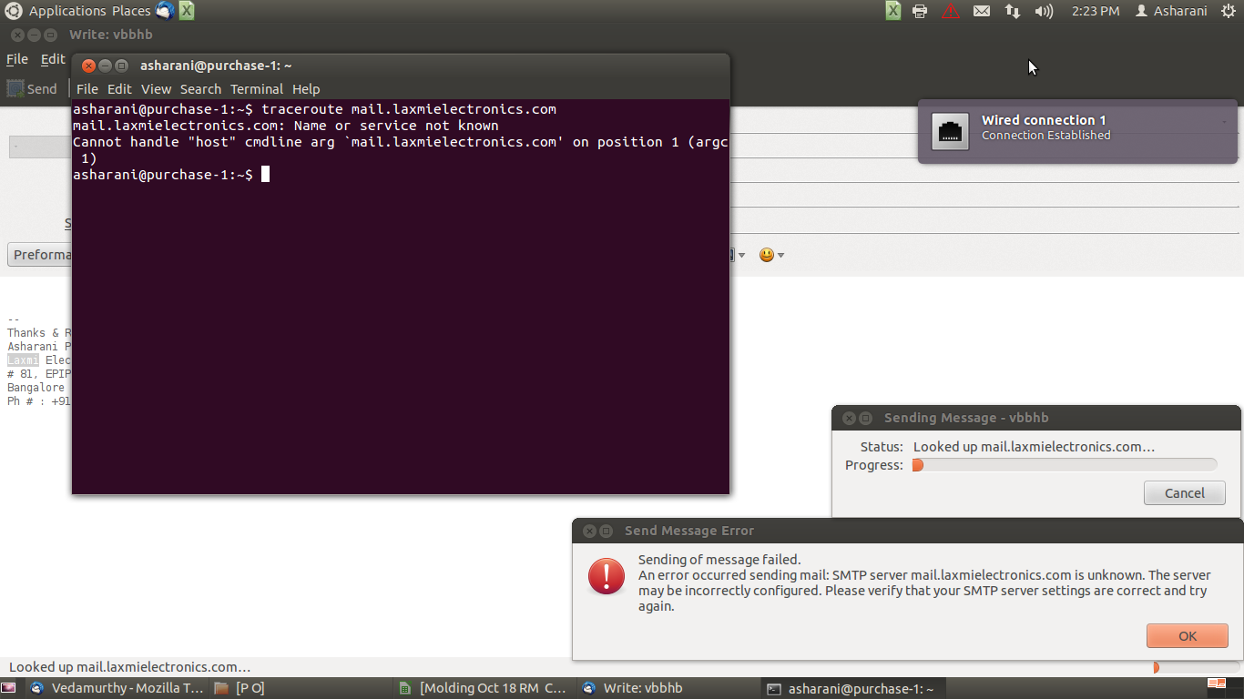

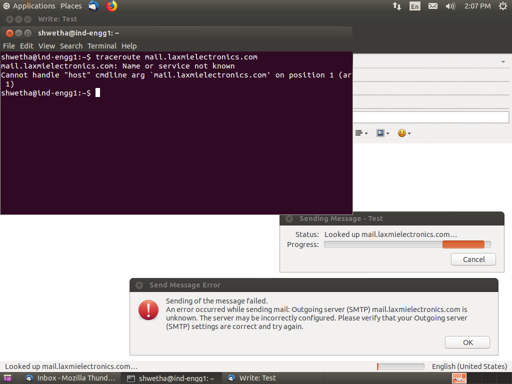

                      If VLAN Clients are idle for 10 to 15 min we are facing the issue of disable & enable network.
                      Please find the below picture for better understanding.
                      Marketing-VLAN
                      When it is not working if i run traceroute command
                      Before Disable & Enable Network
                      After Nework Disable & Enable (in Picture you can see wired connection connected)
                      Traceroute After Nework Disable & Enable
                      Purchase-VLAN
                      Before Disable & Enable Network. Printing also holding. In picture you can see the print icon
                      Printing is completed After Nework Disable & Enable
                      Traceroute Output after Nework Disable & Enable
                        So from that you can not just resolve it?
                        Can your clients resolve anything? Do a simple nslookup or dig for mail.laxmielectronics.com
                        Can you traceroute to its IP vs its name.. 142.4.7.34, Can you ping IP of pfsense - oh prob not because you are not even allowing basic icmp for troubleshooting..
                        And lets go over this yet AGAIN!!!~~ your rules are pretty much pointless... Those allow rules mean zero when below them you have an ANY ANY... Other than you saying your limiting bandwidth on that rule? Is that the case?
                        So your clients are pointing to DC for DNS? Thought you removed them? Where do the DCs get their dns - do they forward do they resolve? What network segment are they in? What are their rules for outbound to dns if resolving.

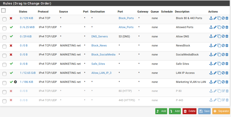

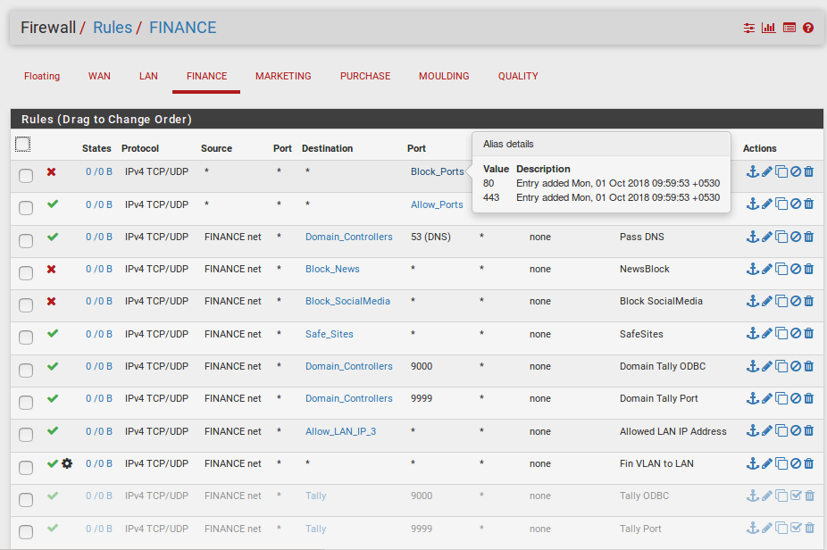

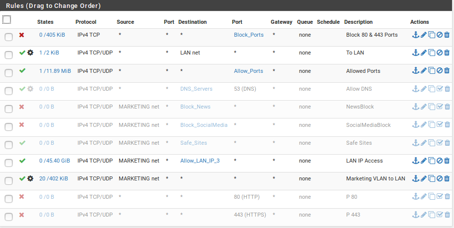

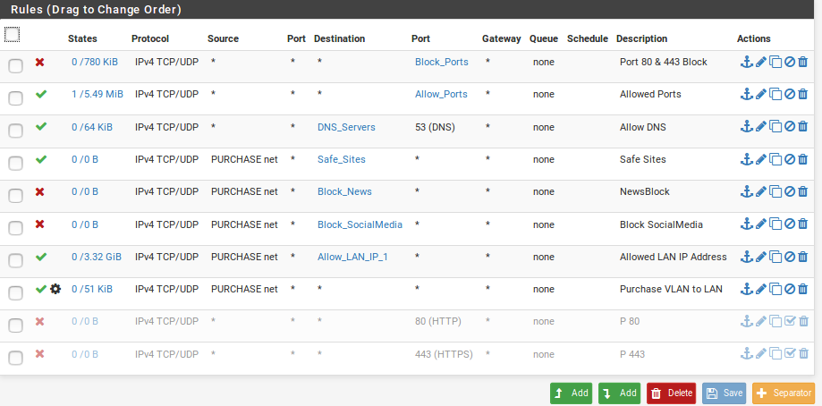

                            Rules of Marketing-VLAN
                            Rules of Purchase-VLAN

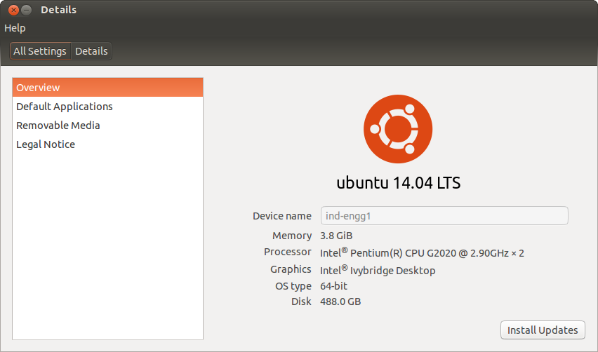

                            System Info
                            Marketing
                            System Info
                            Purchase

                                Ok, so I think what you are showing there is that the machine in the Marketing VLAN is working and the machine in the Purchase VLAN was not able to resolve the mail server until you disabled/enabled the adapter, right?
                                Both those machines are configured to use external DNS servers. If that Connection Information screenshot was taken when it was not working it looks OK though. So you have some DNS issue.
                                Is there some reason you're not handing out the interface IP as DNS in DHCP?
                                Also both those machines are now out of date, the one in Purchase by a long way!

                                  5. Firewall VLAN Rules did few changes. (Same for other VLAN too)
