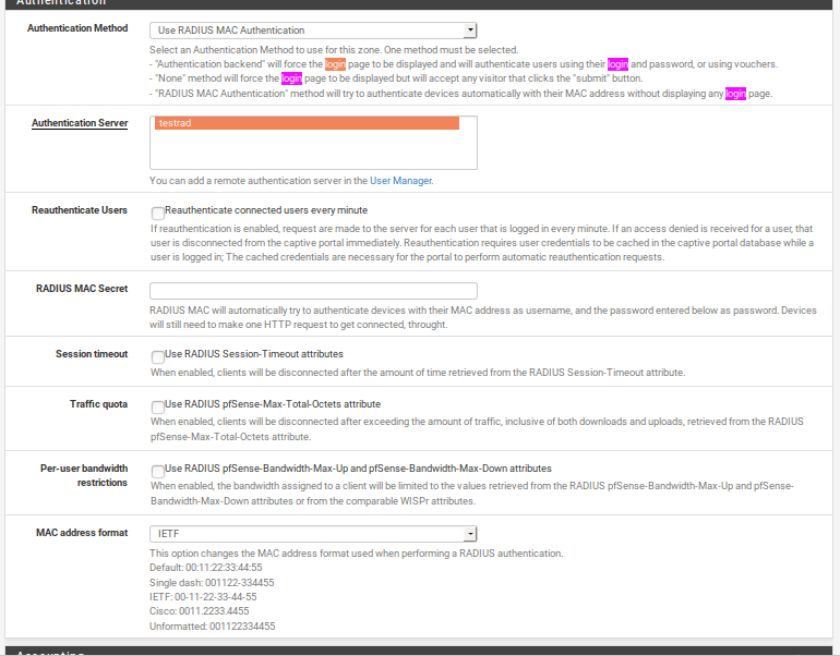

                      meanwhile, I was downgraded to 2.3.4 via a snapshot / and tried to day to perform a normal upgrade via the GUI.. everything goes fine, but there is no option for login fall back.
                      Do I still need to perform a fresh install?

                        I have tried the latest 2.4.4 image to a fresh install, and it doesn't have this feature, do I miss anything ?

                              I have applied the patch using the system patch and it looks working on a fresh install, will apply this in a night action.. and will get back if there are issues.
