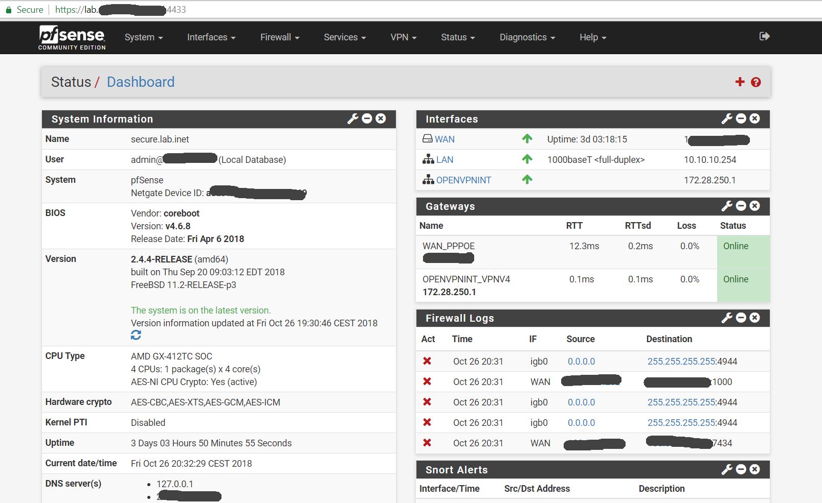

            • boukeB Offline
              bouke
              A small update about my experiment with APU4C4 boards.
              My lab router is up and running 3 days and >3 hours now.
              I am relieved it's running stable and smoothly with BIOS v4.6.8 and pfSense 2.4.4 ☺
              alt text
              I did also speak to my colleagues of technical services. They are running an APU4C4 in production. The did not encounter any problems.
              boukeB 1 Reply Last reply Reply Quote 0
