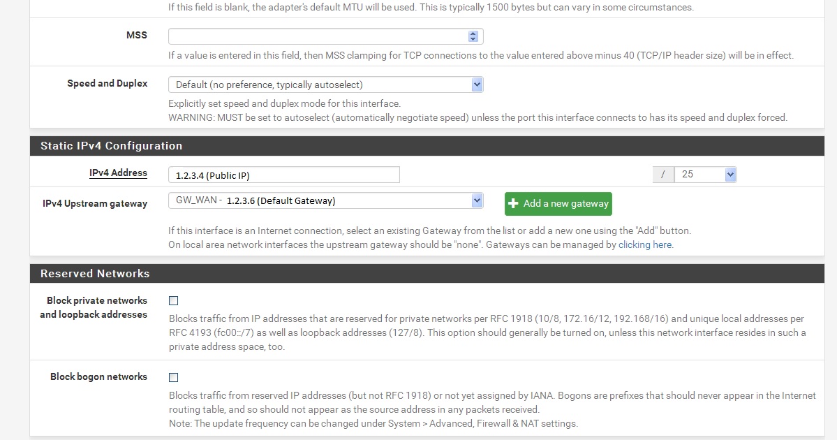

      WAN - Static Public IP /25 with gateway specified

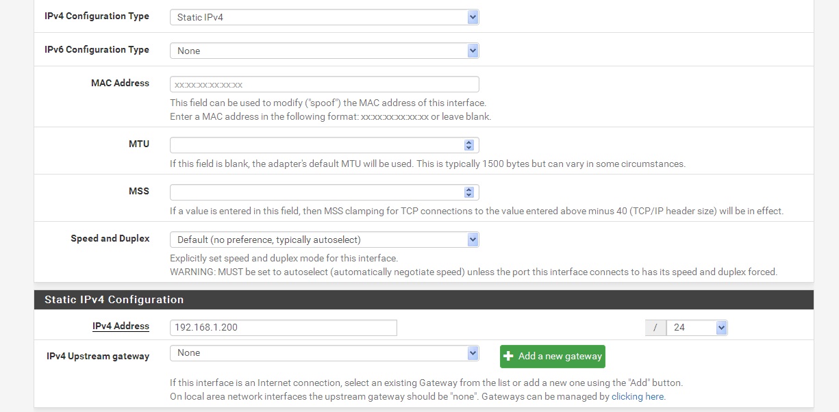

      LAN - 192.168.1.200 /16 no DHCP - no gateway

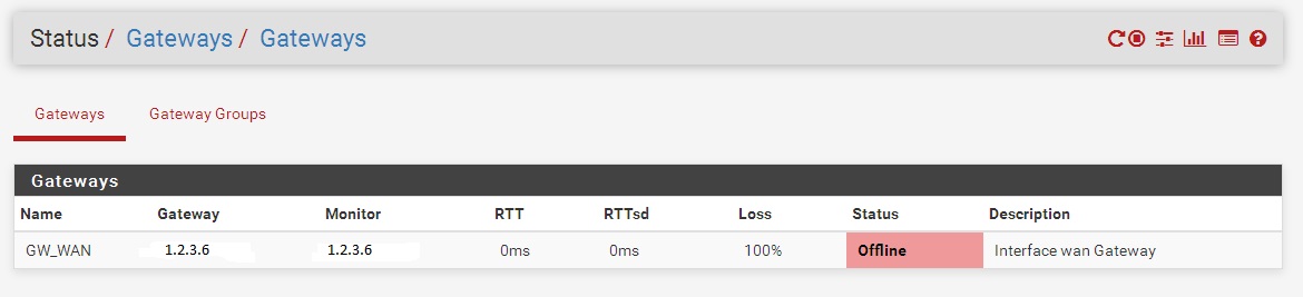

      i didn't change anything of the default firewall rules, and i can access the pfSense Web GUI normally. The status of the gateway is always OFFLINE.

          sorry, i can ping the LAN interface of pfsense. And about /16, i have tried /24 too

            when i tried to test the static public ip in a normal pc, i can ping google and i can ping the default gateway, but in pfsense gui can't ping gateway because it's status is offline

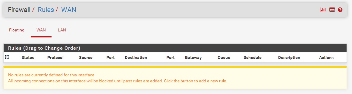

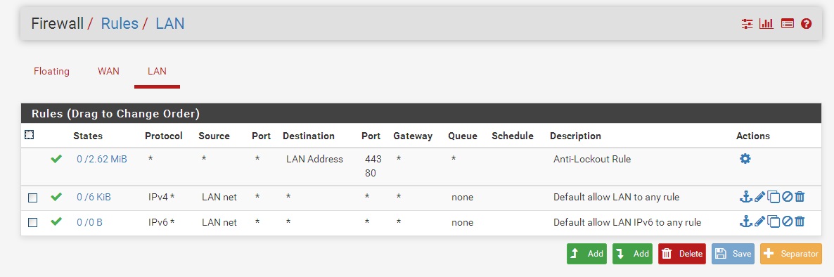

                The firewall has the default lan rule that allow everything from lan to outside. thw wan interface has no rules.

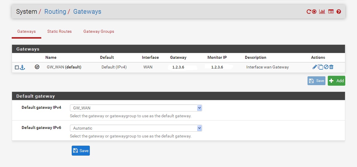

                yes, the wan gateway is the default route.

                    After finishing a new installation and set the correct IPs for wan and lan, pfsense allow everything from LAN to outside right?
