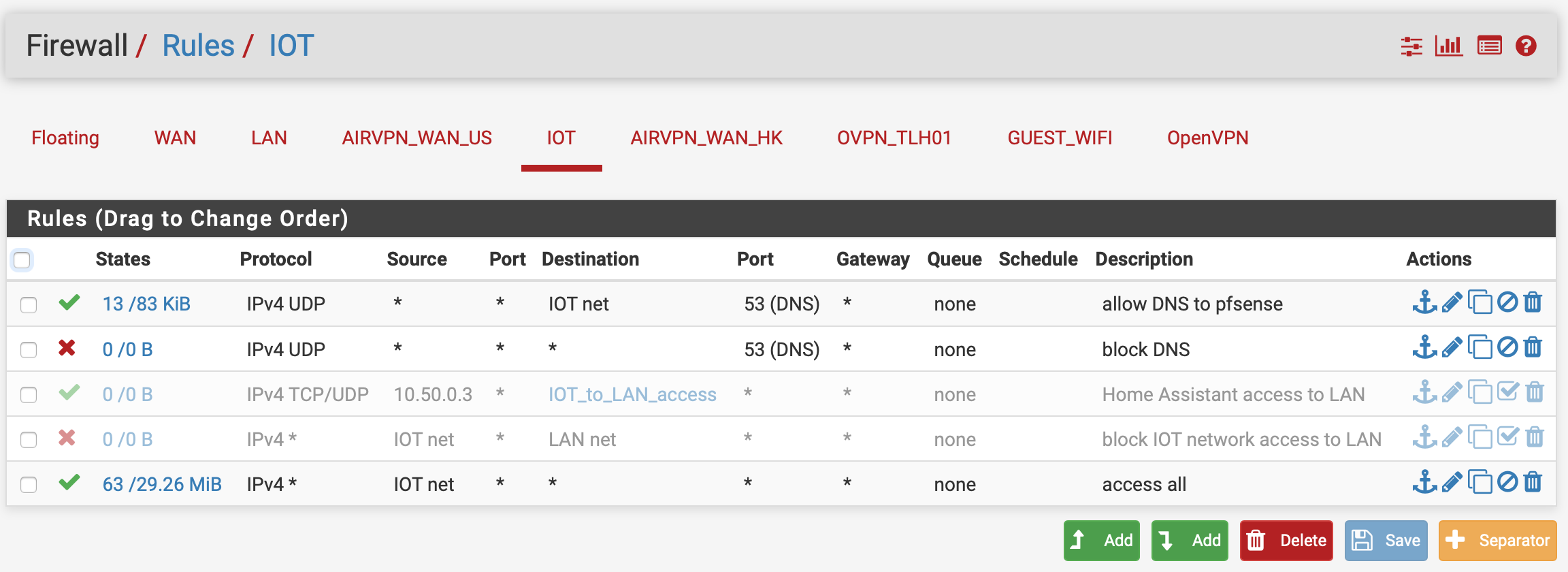

    I created a VLAN for IOT devices but am unable to ping between devices connected to the VLAN. I can ping websites and DNS is resolving domain names to addresses, but I cannot ping to other machines on the same VLAN (I'm entering the IP address of the other device on VLAN).
    I also cannot ping any device on LAN, nor can I ping the DHCP server for the IOT VLAN (10.50.0.1) when connected to the VLAN. I'm not seeing my error, any insight would be helpful.
    Here are my rules:

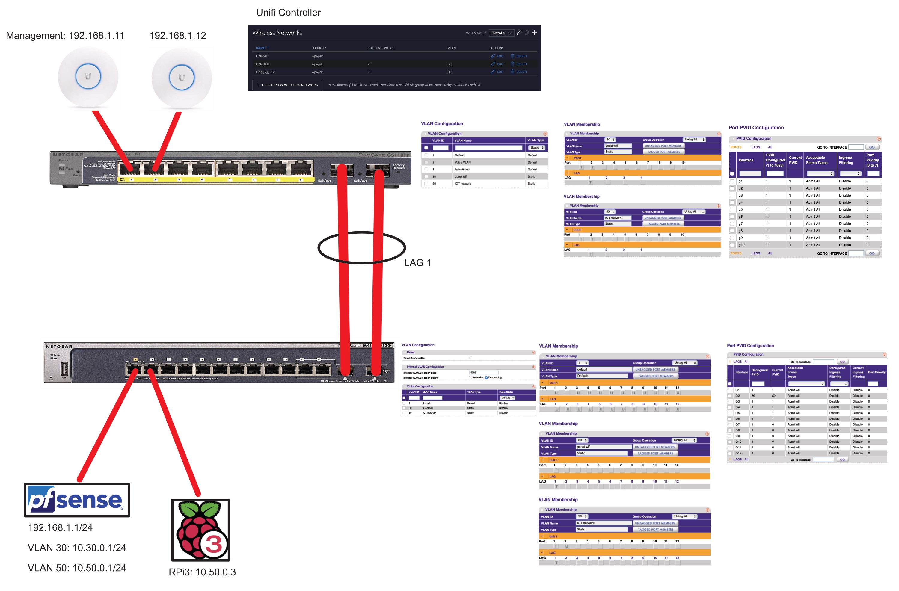

          I've done some more testing. I've removed the RPi and put a Macbook Pro wired to port 2 on 10.50.0.1/24. DHCP is working and I can ping PFSENSE, and PFSENSE can ping the Macbook Pro, and I have internet acess. I then connected a Macbook Air to the unifi AP, DHCP issued the address. From the Macbook Air, I have interenet access, however, I cannot ping PFSENSE and PFSENSE cannot ping the Macbook Air. The Macbook Air can see the Macbook Pro, but I cannot ping it, nor will it connect to the file share (both have file sharing enabled).
          I then connected my iphone to the AP and ran a scan on the network using Net Analyzer app. It found the Macbook Pro (but couldn't ping it) and the DHCP server (also couldn't ping it). It did not find the Macbook Air which is also connected to the AP. So, devices on the AP are seeing devices on the M4100 switch, but can't connect to them. However, devices on APs do not see other devices on the APs on the same subnet.
          • B
            bwanajag

                That was the issue. Once I deselected Guest Network in the UniFi controller software for VLAN 50, I was able to see/ping/access all devices on VLAN 50.
                For anyone who needs information specifically on VLANs over LAGs for Netgear switches, the following link is helpful:
                VLAN+LAG on Netgear switch
