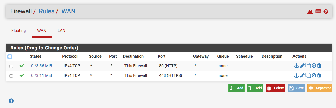

            another question is about the ports, although it is not recommended, the way I do is the following, I create a rule with port 80 and 443 and point them to pfsense itself - print below - (this is not recommended, however for me it works)

            Firewall Rules
            alt text

              Seems about the same settings as it's on my PFsense.
              I'll give it a try with an additional webserver, might be that my OWA is messing up the mappings.
