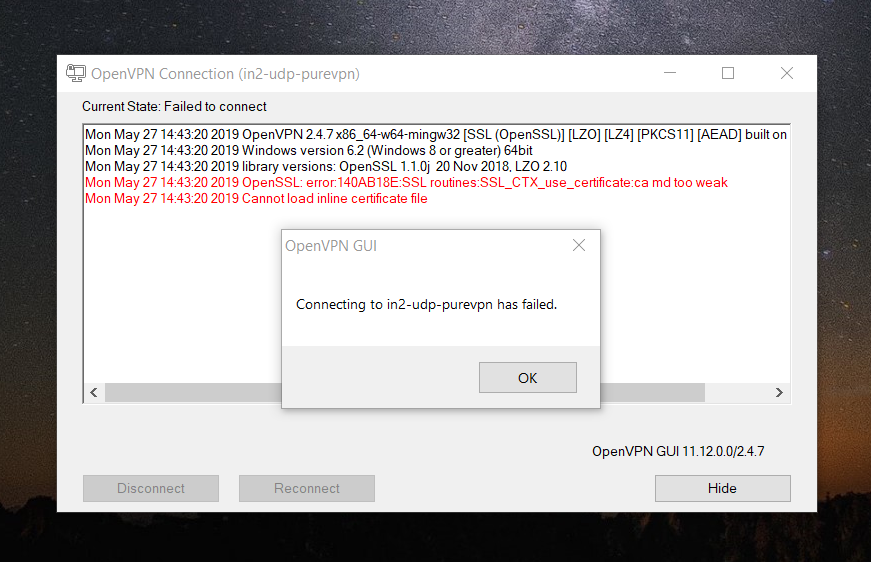

                          Which has ZERO to with wht port its on..
                          And has ZERO to do with pfsense client talking to purevpn service.
                          manjotscM 1 Reply Last reply Reply Quote 0
                          • KOMK Offline
                            KOM
                            That error has nothing to do with running VPN on port 53. It's complaining that you are using an older, insecure encryption algorithm. I think you will need to change your encryption algorithm and then regenerate all your keys again.

                              This has ZERO anything to do with pfsense... He is running current windows client on windows, trying to connect to purevpn.. Who's setup is ancient -- who would of thunk it ;)
                              These services are not in it for the "security" they are in for what phrase about money and suckers ;)
                              2 second google finds solution to his problem
                              https://forums.openvpn.net/viewtopic.php?t=23979
                              manjotscM 1 Reply Last reply Reply Quote 1

                                  There isn't going to be any mention of ports because the cert using md5 is too old for current openvpn clients - which he is running on windows.

                                    @johnpoz that's the screenshot I had shared with PureVPN they has told me port issue..
