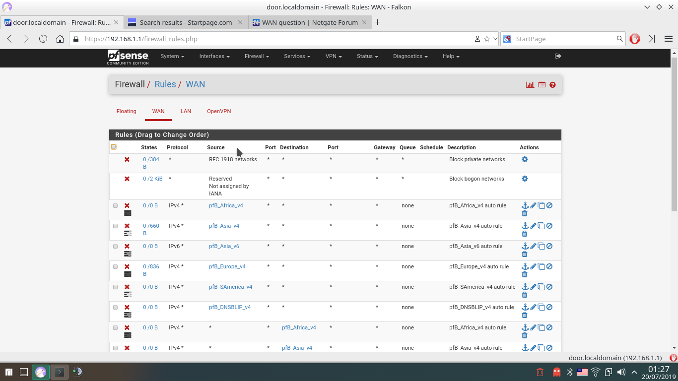

      block drop in log quick on ue0 reply-to (ue0 192.168.0.1) inet from <pfB_Europe_v4> to any label "USER_RULE: pfB_Europe_v4 auto rule"
      block drop in log quick on ue0 reply-to (ue0 192.168.0.1) inet from <pfB_SAmerica_v4> to any label "USER_RULE: pfB_SAmerica_v4 auto rule"
      block drop in log quick on ue0 reply-to (ue0 192.168.0.1) inet from <pfB_DNSBLIP_v4> to any label "USER_RULE: pfB_DNSBLIP_v4 auto rule"
      block drop in log quick on re0 inet from <pfB_Africa_v4> to any label "USER_RULE: pfB_Africa_v4 auto rule"
      block drop in log quick on re0 inet from <pfB_Asia_v4> to any label "USER_RULE: pfB_Asia_v4 auto rule"
      block drop in log quick on re0 inet6 from <pfB_Asia_v6> to any label "USER_RULE: pfB_Asia_v6 auto rule"
      block drop in log quick on re0 inet from <pfB_Europe_v4> to any label "USER_RULE: pfB_Europe_v4 auto rule"
      block drop in log quick on re0 inet from <pfB_SAmerica_v4> to any label "USER_RULE: pfB_SAmerica_v4 auto rule"
      block drop in log quick on re0 inet from <pfB_DNSBLIP_v4> to any label "USER_RULE: pfB_DNSBLIP_v4 auto rule"
      block drop in log quick on ue0 reply-to (ue0 192.168.0.1) inet from any to <pfB_Africa_v4> label "USER_RULE: pfB_Africa_v4 auto rule"
      block drop in log quick on ue0 reply-to (ue0 192.168.0.1) inet from any to <pfB_Asia_v4> label "USER_RULE: pfB_Asia_v4 auto rule"
      block drop in log quick on ue0 inet6 from any to <pfB_Asia_v6> label "USER_RULE: pfB_Asia_v6 auto rule"
      block drop in log quick on ue0 reply-to (ue0 192.168.0.1) inet from any to <pfB_Europe_v4> label "USER_RULE: pfB_Europe_v4 auto rule"
      block drop in log quick on ue0 reply-to (ue0 192.168.0.1) inet from any to <pfB_SAmerica_v4> label "USER_RULE: pfB_SAmerica_v4 auto rule"
      block drop in log quick on ue0 reply-to (ue0 192.168.0.1) inet from any to <pfB_DNSBLIP_v4> label "USER_RULE: pfB_DNSBLIP_v4 auto rule"
      block drop in log quick on re0 inet from any to <pfB_Africa_v4> label "USER_RULE: pfB_Africa_v4 auto rule"
      block drop in log quick on re0 inet from any to <pfB_Asia_v4> label "USER_RULE: pfB_Asia_v4 auto rule"
      block drop in log quick on re0 inet6 from any to <pfB_Asia_v6> label "USER_RULE: pfB_Asia_v6 auto rule"
      block drop in log quick on re0 inet from any to <pfB_Europe_v4> label "USER_RULE: pfB_Europe_v4 auto rule"
      block drop in log quick on re0 inet from any to <pfB_SAmerica_v4> label "USER_RULE: pfB_SAmerica_v4 auto rule"
      block drop in log quick on re0 inet from any to <pfB_DNSBLIP_v4> label "USER_RULE: pfB_DNSBLIP_v4 auto rule"
      block drop in quick on ue0 inet6 all label "USER_RULE: Block all IPv6"
      block drop in quick on ue0 reply-to (ue0 192.168.0.1) inet from any to 8.8.8.8 label "USER_RULE"
      block drop in quick on ue0 reply-to (ue0 192.168.0.1) inet from 8.8.8.8 to any label "USER_RULE"
      block drop in quick on ue0 reply-to (ue0 192.168.0.1) inet proto tcp from any to any port = domain label "USER_RULE: Block all non-encrypted DNS"
      block drop in quick on ue0 reply-to (ue0 192.168.0.1) inet proto udp from any to any port = domain label "USER_RULE: Block all non-encrypted DNS"
      block drop in quick on re0 inet proto tcp from any to 192.168.0.0/24 port = telnet label "USER_RULE: Block23"
      block drop in quick on re0 inet proto udp from any to 192.168.0.0/24 port = telnet label "USER_RULE: Block23"
      block drop in quick on re0 inet from 192.168.1.20 to any label "USER_RULE"
      pass in quick on re0 inet from 192.168.1.0/24 to any flags S/SA keep state label "USER_RULE: Default allow LAN to any rule"
      pass in quick on re0 inet from 10.10.10.1 to any flags S/SA keep state label "USER_RULE: Default allow LAN to any rule"
      pass in quick on re0 inet proto tcp from any to 127.0.0.1 port = domain flags S/SA keep state label "USER_RULE: NAT All DNS to pfsense"
      pass in quick on re0 inet proto udp from any to 127.0.0.1 port = domain keep state label "USER_RULE: NAT All DNS to pfsense"

          That's my rules. I don't want to stop the clients only. I want to stop clients and the router as well. And 8.8.8.8 is just example. In fact, the rules just dont work on WAN. I've got lot of addresses blocked in pfblocker, but there are not. Like 2.21.98.84 (In Africa ipv4 list) - blocked for clients, but is not for the router (pfblocker add rules in both interfaces with action "block"). I've got ping and i'm sure they have to me as well.
            Not sure what you think rules on the WAN are going to do??
            Out of the box ALL unsolicited traffic to your wan IP is dropped.. You do not have to do ANYTHING for this to happen..
            I can not even tell what interface those rules are on.. Just attach the images here.. How hard is it to show your rules?
            You mean pfsense? You can not stop pfsense from talking to what it needs to talk to.. The only thing its going to talk to is checking for updates..
            If you want to stop client from talking to ip 1.2.3.4 then those would go on your LAN.. Rules on your wan would only stop IP 4.5.6.7 from accessing some port forward you had open. If the block was above where your port forward rule was.
            Since you have Zero port forwards - every single one of those rules on your WAN are 100 percent POINTLESS!!!

              That's after states restart and computer restart.
              "Since you have Zero port forwards - every single one of those rules on your WAN are 100 percent POINTLESS!!"
              So, hot to fix it? What port to forward to where?
