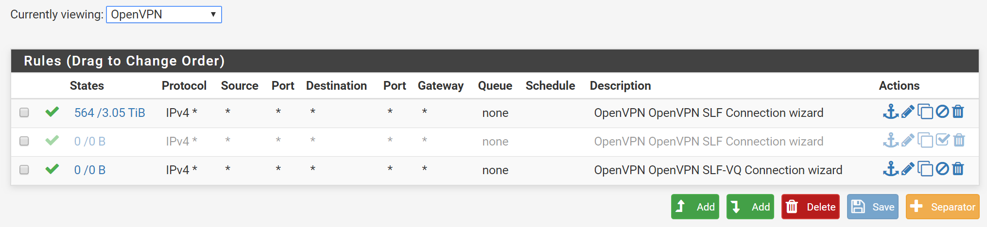

                        What are the rules in your openvpn interface on pfsense?
                        example:
                          albertmiclat @johnpoz
                          @johnpoz the usual rules..
