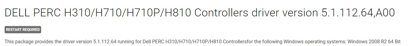

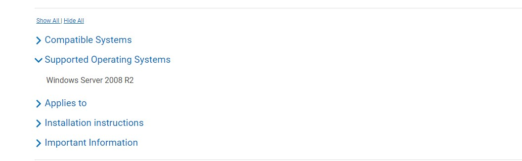

                                      "genuine Dell stuff is not supported under FreeBSD - by Dell
                                      do you see FreeBSD OP system somewhere here?"
                                      and then stating
                                      "BTW:
                                      FreeBSD supports this card (H710)
                                      otherwise, Dell will not address FreeBSD compatibility"
                                      Which completely through me for a loop not understanding if it was or it wasnt. Just cause it works sometimes doesnt mean its completely compatible.
                                      Again, the help is appreciated, after all the confusion i found a site that explained the whole process to me regarding partitions on FreeBSD then what i got outta being confused.
                                      Being nice goes a long way with others..
                                      Thanks for your assistance @DaddyGo
                                      Have a blessed day.

                                        "BTW:
                                        FreeBSD supports this card (H710) =
                                        https://www.freebsd.org/cgi/man.cgi?query=mrsas&sektion=4
                                        do you see FreeBSD OP system somewhere here?" =
