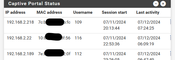

                                      Everything works, as you doing only the so called Level 2 Ethernet.
