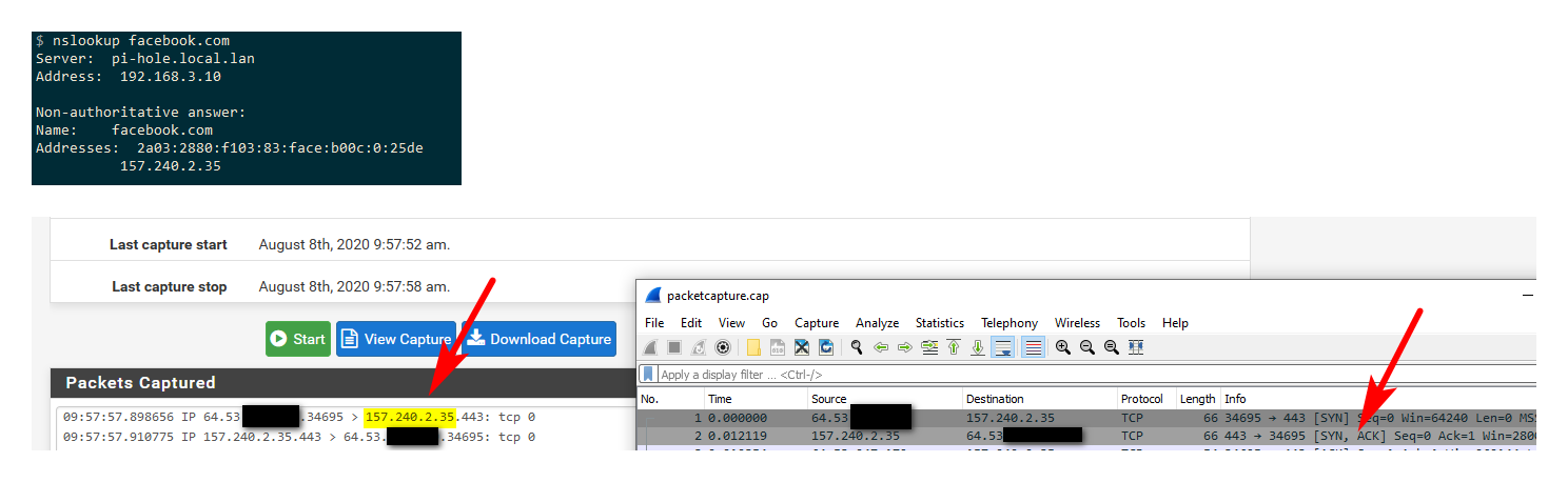

              @November said in Unable to reach facebook.com and linkedin.com:
              Also, nslookup for both domains comes back fine.
              Then you not getting there has nothing to do with dns, so why are you changing it? Do you think the IP returned is bad or something?
              Here is a simple test.. Try and go to facebook.com while sniffing on your pfsense wan.. Do you see it send a syn? What do you get back - anything? If you send and don't get anything back its not pfsense problem. If you don't send, then you have something on pfsense or your network that is causing the problem.

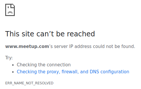

                        From Chrome:

                              Well your never going to get to www.meetup.com if it doesn't resolve.. you didn't get an answer..
                              As to why you didn't see anything in your sniff to linked in.. You didn't show how you did your sniff so not sure what your doing wrong.. Are you forcing traffic out a vpn? Did you sniff on the wrong interface? Did you sniff only tcp only and its using quic (udp) etc.
                              On pfsense do a dig +trace for www.meetup.com
                              Which has a cname that points to
                              www.meetup.com. 30 IN CNAME f4.shared.global.fastly.net.
                              So then do trace to that.. They have horriblely low TTLs - so those IPs most likely going to change all the time..
