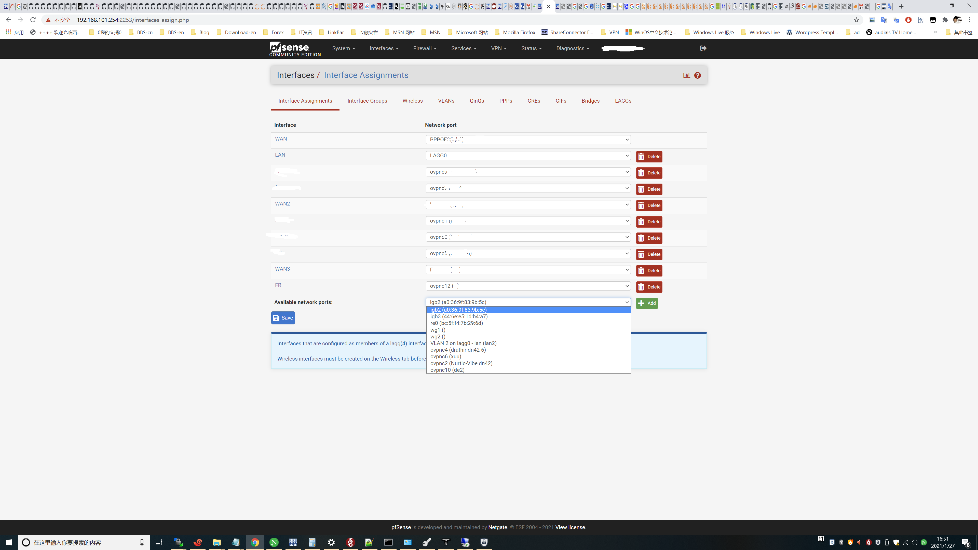

It is found that the interface will be confused.
i config two wg tunnel, when i deleted wg0 tunnel, then update wg1 tunnel data, it will auto change interface name to wg0.
the route gateway will use old deleted wg0 data for wg1.and i had deleted wg0 name still show interface list.
Can we choose to configure the interface name?
and i had deleted wg tunnel and interface, but use ifconfig command still show all old wg0 wg1 .. in interface.
wg interface config ipv4 and ipv6 address,
eg: 10.0.0.102/32, 2a0d:2400:12:c::102/128
but the interface only has ipv4.
