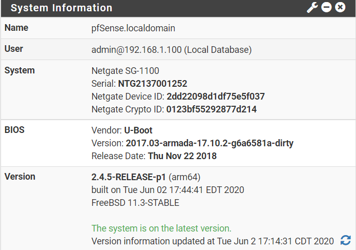

            Ok, after digging into this we were able locate an issue and developed a solution.
            A small percentage of Netgate 1100 pfSense Plus appliances have been found to be unable to perform pfSense software updates (through our update servers) beyond version 2.4.5 p1.
            Symptoms include the pfSense dashboard <Status/Dashboard> not showing any updates available beyond v2.4.5 p1. Please note that this is incorrect - the latest version of pfSense software available for the Netgate 1100 is version 21.05.2.
            This issue affects Netgate 1100 appliances within the following serial number range: NTG2137000001 - NTG2137001503. If your unit’s serial number is within this range, please take the following steps to upgrade:
            An affected system will show it to be running pfSense 2.4.5-RELEASE-p1, and state that the system is on the latest version:

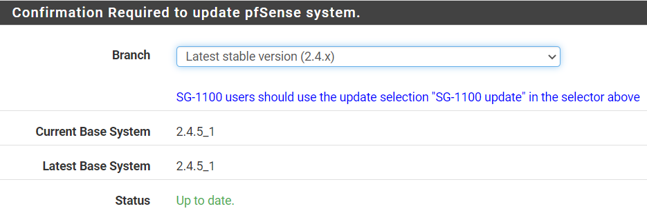

            To update an affected Netgate 1100, follow these steps:
            Navigate to System>Update on the affected firewall. Here you should see a message encouraging 1100 users to select the SG-1100 update branch as outlined below:
            Select the SG-1100 update branch from the drop-down menu and wait for the system to offer 21.05.2 as the Latest Base System:
            Select “Confirm”.
            The SG-1100 will be fully in conformance and able to perform future updates and package downloads without issue immediately after updating via the “SG-1100 update” option.
            NOTE: It may take up to 24 hours for the blue text message “SG-1100 users should use the update selection “SG-1100 update” in the selector above” to disappear.
            If you need technical assistance, please contact Netgate Support (select TAC Lite if you did not purchase a TAC subscription) .
            We apologize for any inconvenience.

              @stephenw10 that is excellent news - thanks for finding the problem! Will all new SG-1100 come with the fix? For example, if I order another one today?
              • stephenw10S Online
                Any that are in the affected range will see the new update branch. The code to allow that is at the update repo servers so nothing is required on the 1100 itself.

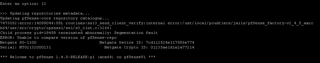

                                Jeremy11one
                                I have this problem too. When I go to System > Update, I do not see the blue message about changing to "SG-1100 update" and the Branch dropdown only shows 2.4 and 2.4.4. Serial# NTG2132000231. If we can't fix it via the GUI, can I do a clean install via putty/SSH? The firewall is installed in a remote office, so I don't have access to its USB port.
                                  Ah, that's a different problem. That is usually because the crypto hardware has become stuck in an unexpected mode. To resolve that you need to fully power cycle the device, so do a clean shutdown then remove the power for 10s.
                                  It's not possible to reinstall without access to the USB console locally.

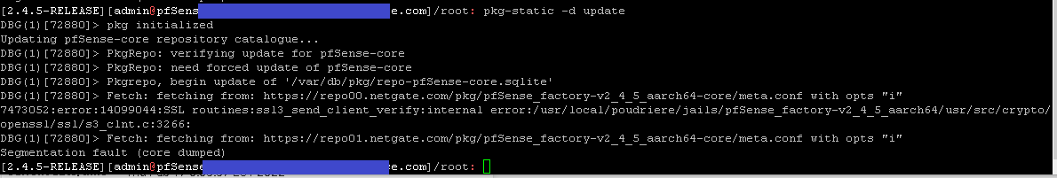

                                    Jeremy11one @stephenw10
                                    Thank you. It would be much better if we could do that crypto reset remotely somehow. And if the GUI would detect the problem and explicitly recommend resetting the crypto.
                                    I did the power cycle, and now I still get no updates but I'm getting these new errors:
                                      Unfortunately there is no way to reset the crypto device from that state in software. The driver has since been updated to stop that happening though.

                                          Unable to update repository pfSense-core
                                          DBG(1)[24465]> PkgRepo: verifying update for pfSense
                                          DBG(1)[24465]> PkgRepo: need forced update of pfSense
                                          DBG(1)[24465]> Pkgrepo, begin update of '/var/db/pkg/repo-pfSense.sqlite'
                                          DBG(1)[24465]> Fetch: fetching from: https://repo01.netgate.com/pkg/pfSense_factory-v2_4_4_aarch64-pfSense_factory-v2_4_4/meta.conf with opts "i"
                                          DBG(1)[24465]> Fetch: fetching from: https://repo00.netgate.com/pkg/pfSense_factory-v2_4_4_aarch64-pfSense_factory-v2_4_4/meta.conf with opts "i"
                                          DBG(1)[24465]> Fetch: fetching from: https://repo01.netgate.com/pkg/pfSense_factory-v2_4_4_aarch64-pfSense_factory-v2_4_4/meta.txz with opts "i"
                                          DBG(1)[24465]> Fetch: fetching from: https://repo00.netgate.com/pkg/pfSense_factory-v2_4_4_aarch64-pfSense_factory-v2_4_4/meta.txz with opts "i"
                                          pkg-static: https://repo.netgate.com/pkg/pfSense_factory-v2_4_4_aarch64-pfSense_factory-v2_4_4/meta.txz: Bad Request
                                          repository pfSense has no meta file, using default settings
                                          DBG(1)[24465]> Fetch: fetching from: https://repo01.netgate.com/pkg/pfSense_factory-v2_4_4_aarch64-pfSense_factory-v2_4_4/packagesite.txz with opts "i"
                                          DBG(1)[24465]> Fetch: fetching from: https://repo00.netgate.com/pkg/pfSense_factory-v2_4_4_aarch64-pfSense_factory-v2_4_4/packagesite.txz with opts "i"
                                          pkg-static: https://repo.netgate.com/pkg/pfSense_factory-v2_4_4_aarch64-pfSense_factory-v2_4_4/packagesite.txz: Bad Request
                                          Error updating repositories!
                                          Enter an option: 13
                                          >>> Updating repositories metadata...
                                          pkg-static: https://repo.netgate.com/pkg/pfSense_factory-v2_4_4_aarch64-core/meta.txz: Bad Request
                                          repository pfSense-core has no meta file, using default settings
                                          pkg-static: https://repo.netgate.com/pkg/pfSense_factory-v2_4_4_aarch64-core/packagesite.txz: Bad Request
                                          ERROR: Unable to compare version of pfSense-repo
                                            rcoleman-netgate Netgate @Jeremy11one
                                            What does the Update Branch say in the GUI? System->Updates
                                            Ryan
