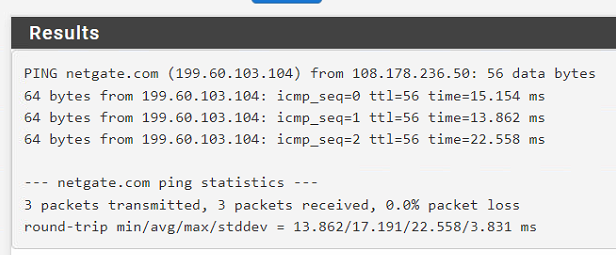

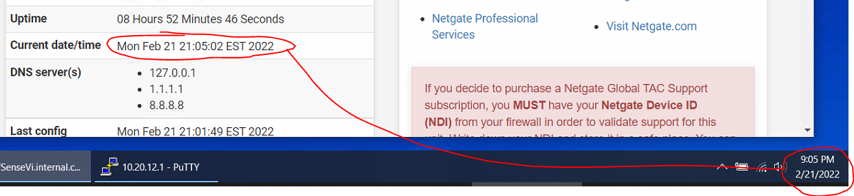

              If that 1100 able to ping out to anything now?
              Does it show the correct time and date?
              If it doesn't try entering a known ntp server directly like 216.239.35.0
                Jeremy11one @stephenw10
                @stephenw10 Yes, it can resolve and ping. And its date & time are correct.
                  Hmm, OK make sure it can resolve and ping ews.netgate.com
                  What you're seeing there looks exactly like the issue the custom update branch was created to workaround.
                  [21.05.2-RELEASE][admin@1100.stevew.lan]/root: ping -c 1 ews.netgate.com
                  PING ews.netgate.com (208.123.73.93): 56 data bytes
                  64 bytes from 208.123.73.93: icmp_seq=0 ttl=50 time=109.961 ms
                  --- ews.netgate.com ping statistics ---
                  1 packets transmitted, 1 packets received, 0.0% packet loss
                  round-trip min/avg/max/stddev = 109.961/109.961/109.961/0.000 ms
