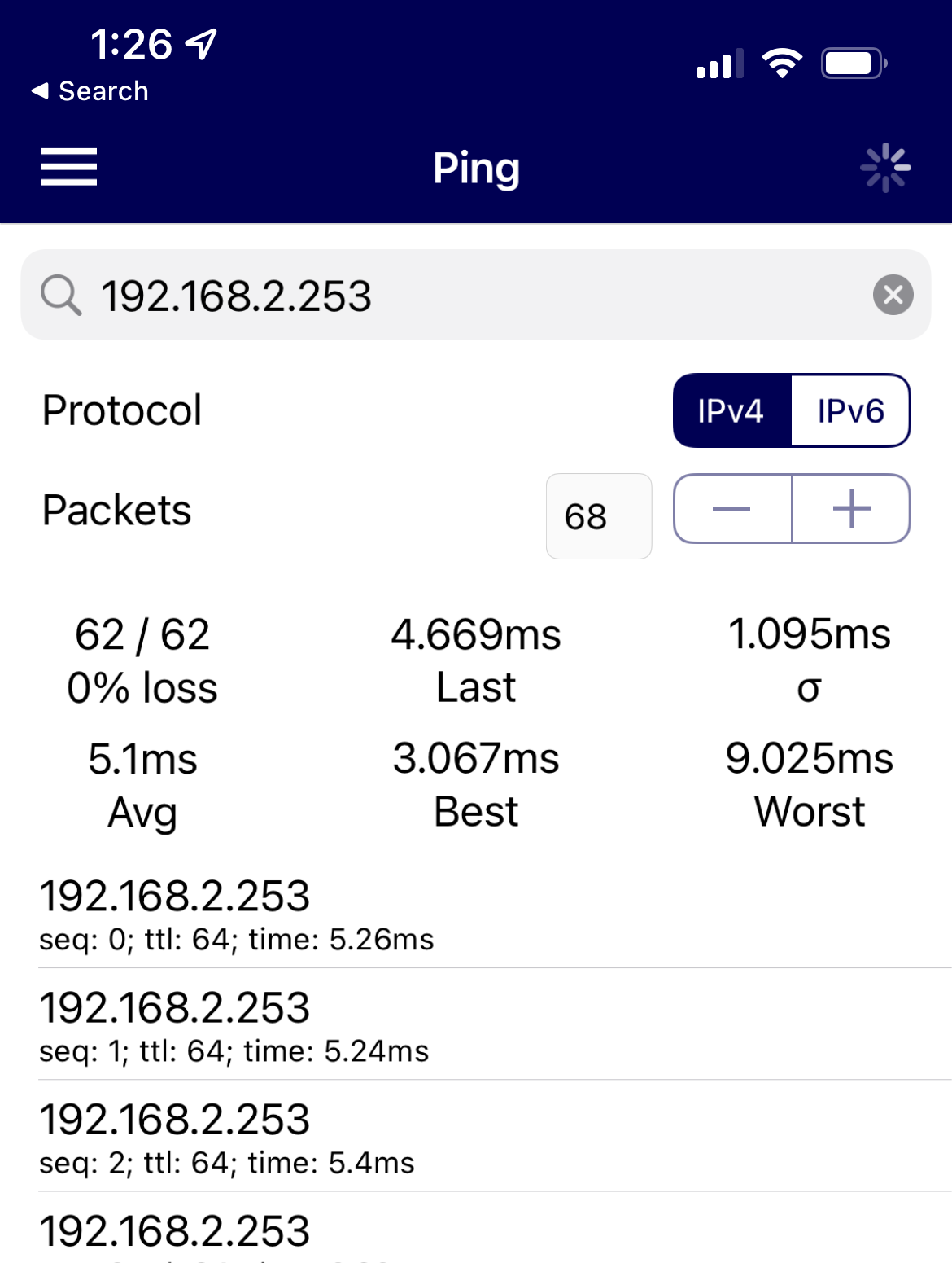

                                          @edpbettinelli ok on my iphone.. Pinging pfsense IP on that vlan.
                                          Restart unbound, reload firewall filters, restarted dhcp, etc..
                                          Not a ping lost

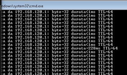

                                            Mmm, there's really no reason the iphone should react at all to dhcpd restarting.
                                            Can we see your test results so we know exactly what you're seeing?
