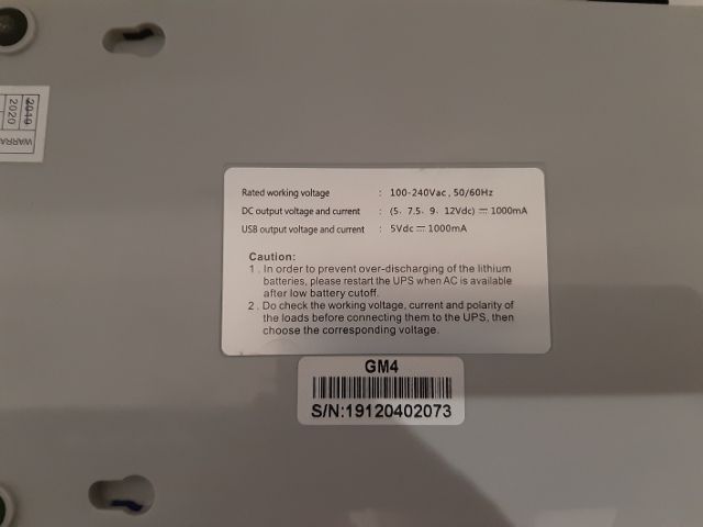

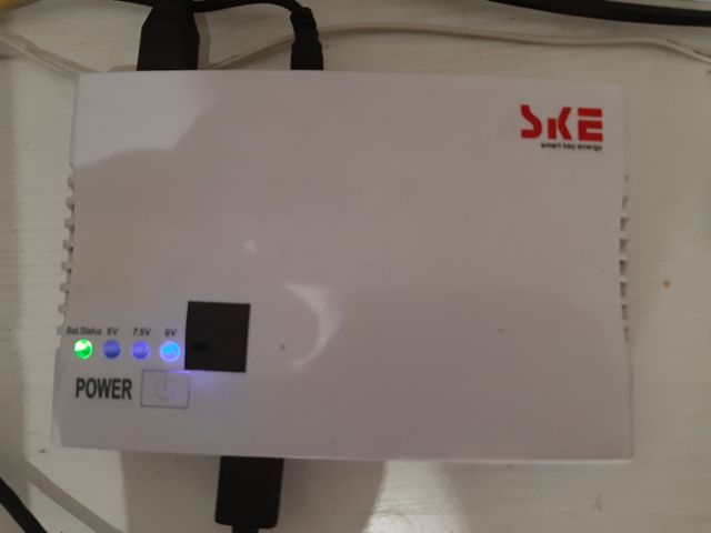

                                dandare100 @FSC830
                                @fsc830
                                Here are some pics of the PSU.
                                I am using the splitter cable that came with it. It splits the DC output into 2. One goes to the Alcatel and the other goes to the 2100.
                                It is fed by a 2 prong plug (no earth) and has a plastic casing. The only thing I can deduce is that the negative will be shared between the 2100 and the Alcatel as the ground. The Alcatel is also in a plastic case, so I cannot measure the voltage between the 2 devices.

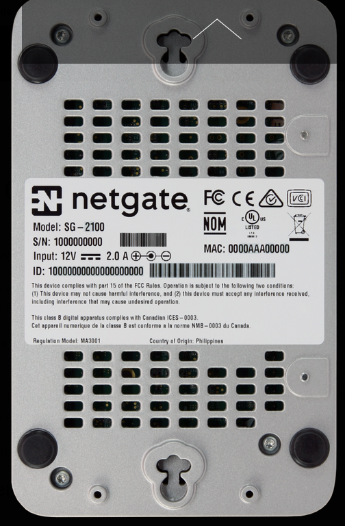

                                  Another dump question: are you sure the DC plug fits the SG-2100 tight, so if you plug in the WAN cable do not cause an short outage?
                                  BTW: DC output is 12V 1000mA referring to label. Is that sufficient for SG-2100 and the Alcatel device?
                                  Input label at SG-2100 is 12V 2.0A, so in my understanding even when running the SG alone that PSU does not provide sufficient current!?
                                  Regards
                                    dandare100 @FSC830
                                    @fsc830 That is a very good point. Thank you for that.
                                    It explains the fact that when I power the Alcatel on (this causes the 2100 to go off), the inrush for this could bring the supply to the 2100 down for a split second and because the supply is border line already, the 2100 shuts off.
                                    That must be the hassle, thank you and apologies to all for the red herring.
