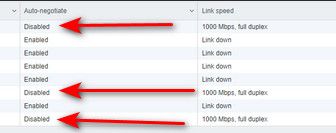

                  riahc8 @stephenw10
                  @stephenw10 said in Gigabit internet PPPoE and pfSense:
                  You should be able to see one of the links negotiated at 100M to be sure. pfSense can't see it because the VM host presents it as a 10G NIC but the host should be able to. Or whatever it's connected to.
                  Well
                  As you can see, they are all at 1000
                    Hmm, something in the config then? Setting it to present 100M?
                    Or something further upstream?

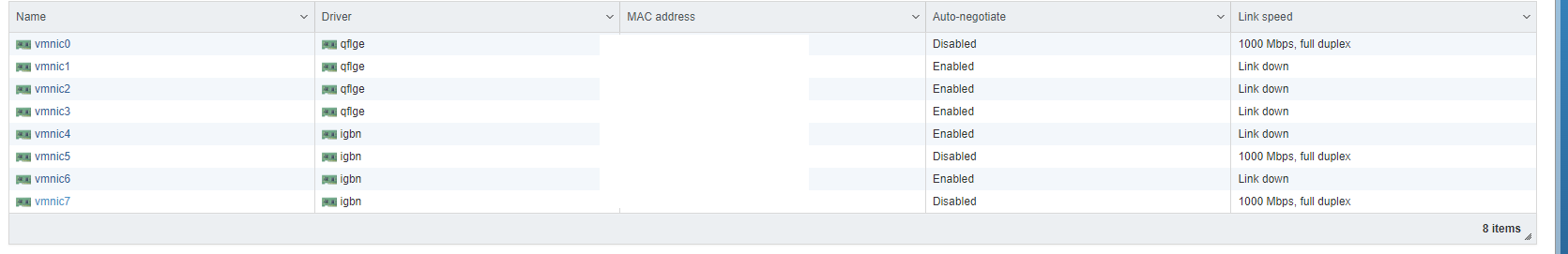

                    • johnpozJ Online
                      johnpoz LAYER 8 Global Moderator @riahc8
                      @riahc8 this is horrible idea..
                      Hard coding gig is just not good idea, if you do not auto come up gig something is WRONG! hard coding it doesn't fix that.. But it can mask underlying issues.
                      R 1 Reply Last reply Reply Quote 1
                        Ha, good catch! I missed that.
                        Yeah Gigabit Ethernet requires auto-negotiation. One of those is probably connected to something that has fallen back to 100M but you can't see it.
                          riahc8 @johnpoz
                          @johnpoz said in Gigabit internet PPPoE and pfSense:
                          Dont know since when I have this up and running but I have NEVER touched that....No idea why it isnt set to Auto MDI-X

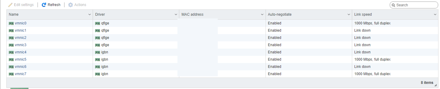

                            riahc8 @stephenw10
                            Well, nothing has really changed:

                                          Ok, so that change removed the local 100M restriction to the host. Is the PPPoE still slow?
                                            riahc8 @stephenw10
                                            Sorry that I wasnt able to get back
                                            Nothing, more or less the same speeds after making that change.
                                            I just checked that it negotiated at 1000 Mbps, full duplex
