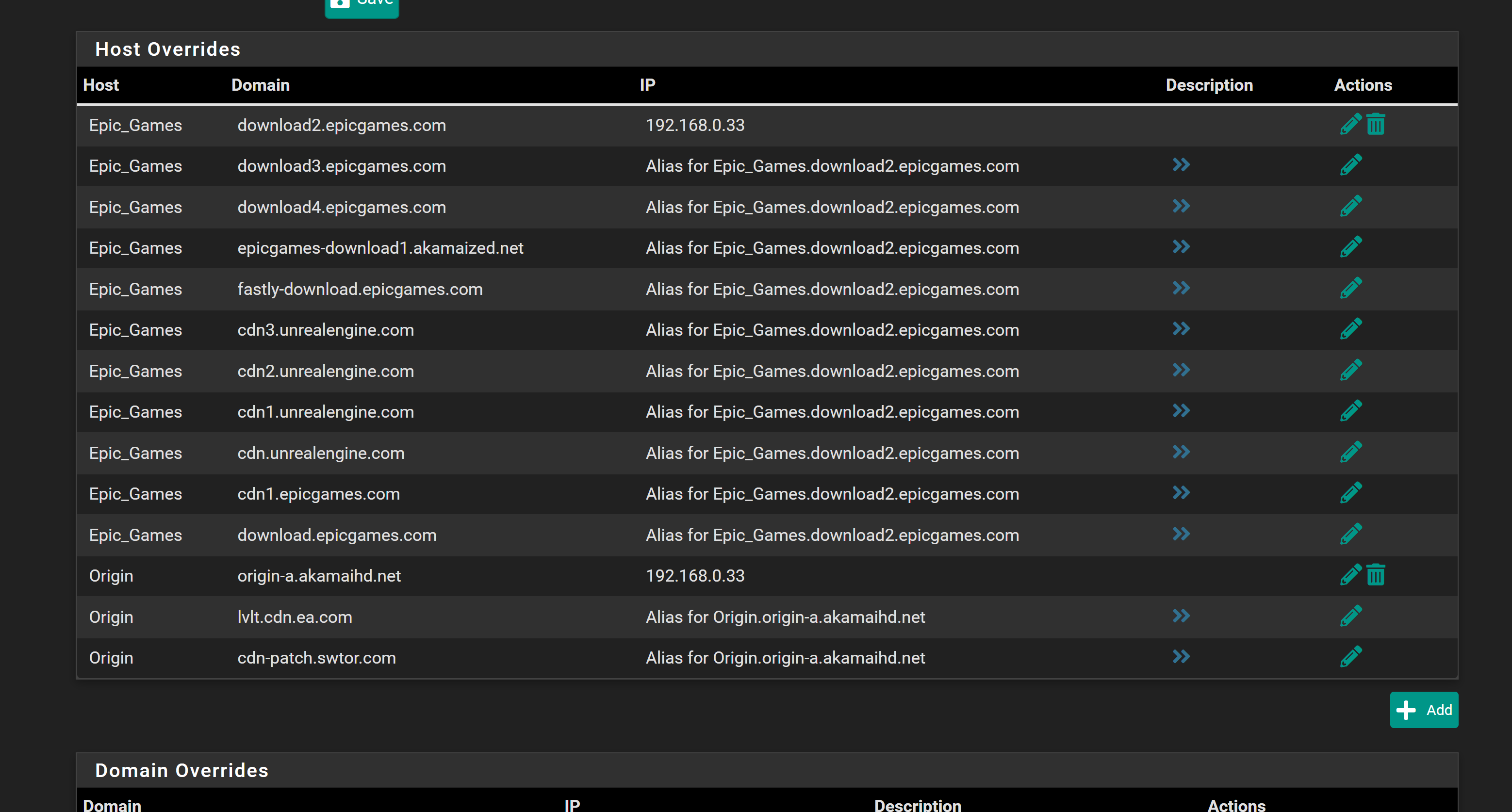

                    here in this pic.. i reset it up for just epic and Orgin games so far this is under "DNS Forwarder"
                    the script i dont think i can run that in pfsense.. as i guessing its ment for PiHole... and for unraid there is no need to run a script it has it all built in i guess you just set the DNS Bind ip and upstream IP and Host IP witch is the same as Bind IP.. and ur done.. so i would set it to 192.168.0.33 and upstream 192.168.0.3

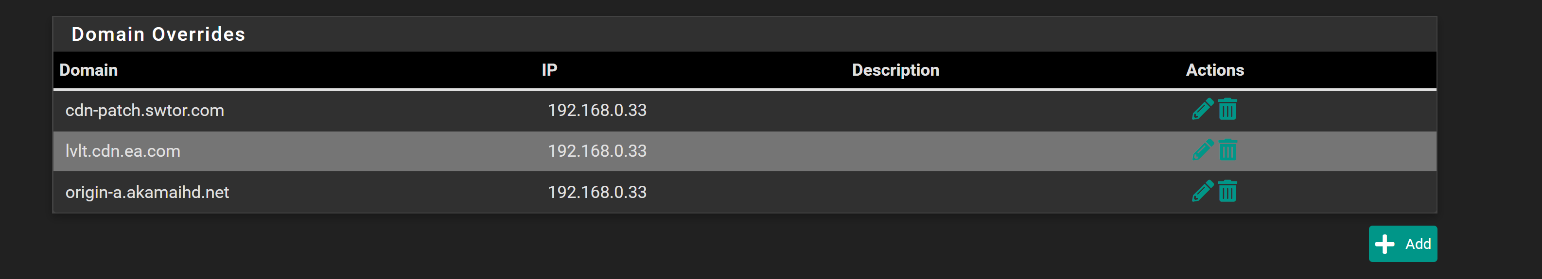

                    so here is the screen shot... and when i had steam ip address's too... Traffic Graph would show "Steam" host even though Epic or Orgin games were being updated.. and i test it by resuming a download in Epic Games Launcher or Origin Games Launcher
                    i did try also domain override but it didnt work either really... pic below those are the Origin Games servers
                    and the only check box i checked off in DNS Forwarder was Enable Forwarder... the other boxes i really didnt understand them

                        Ok, those host entries look wrong. Epic_Games.download2.epicgames.com is not a valid host.
                        That should almost certainly be:
                        Host		Domain
                        download2	epicgames.com
                        'Epic_Games' is just the entry name.
                        You almost certainly need to run that script and then insert the output in the Unbound custom conf.
                        Domain overrides have to point at another DNS server that will resolve them. Is the Cache server also a DNS server?

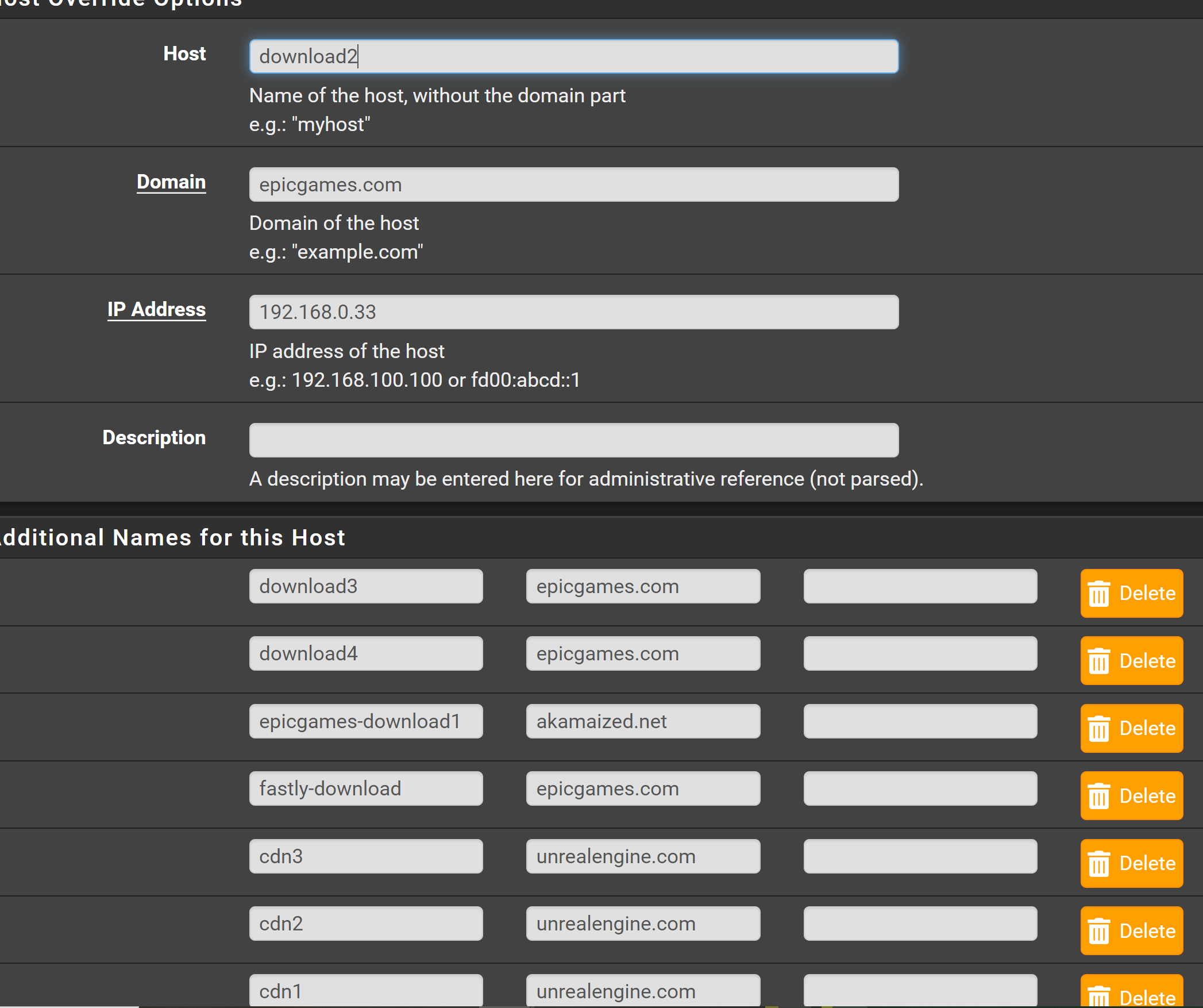

                          ok so i never typed in Epic_Games.download2.epicgames.com as host name.. guess pfsense does it... host name is "Epic_Games" it seems to attach it?? here is a pic
                          and a pic of the servers i added from the github
                          unraid runs a Docker of lancache server which itself is a DNS Server.. so it does work partially if i point dhcp server dns to 192.168.0.33 and the clients work.. but if i use the non vpn clients then i find pages cant be found amazon pages dont load properly.. as i tried to get both Non VPN and VPN clients to connect to this dns server the lancache as it also hosts Windows Updates.. caches those too. as you dont have to add any ips.. its all built in.. u just point to 192.168.0.33 and all the games are cached to it..
                          and running the script file i forget which file since ibouncing back and forth couple pages.. do you then import this custom.conf into pfsense to load into the Dns Resolver Host Overrides (Unbond)
                          ill have to re go over it. and look
                          so should have changed it then where i did "host" not use epic_games
                          but should it been
                          host              ip
                          cdn3             unrealengine.com
                          cdn2             unrealengine.com
                          was that how its supposed to be entered?

                              Yes, that's the correct format for a host override. The FQDN = hostname.domain.
                              See: https://docs.netgate.com/pfsense/en/latest/services/dns/resolver-host-overrides.html
                              If the lancache server is also a dns server then you could just use domain overrides and point to it for the whole domain. E.g. epicgames.com
                              Assuming the server will override the hosts for cached content and resolve them as itself that should work.
                              Adding host or domain overrides in the pfSense GUI is actually creating Unbound conf lines that are added in the background. When you run that script it creates raw Unbound conf intended to be used with Unbound directly. pfSense has a field for entering conf lines directly if you need to use advanced Unbound features so that's where I would expect to enter it if you are doing it that way.
                              It shouldn't matter where you run the script since you are manually using it's output anyway.
                              I would be testing this be simply trying to resolve one of the hosts and seeing what IP it returns.

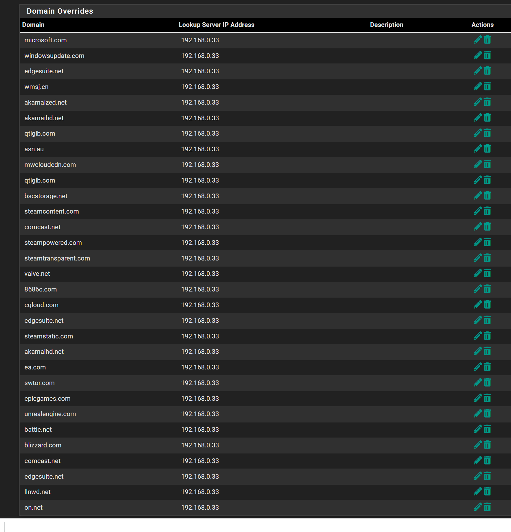

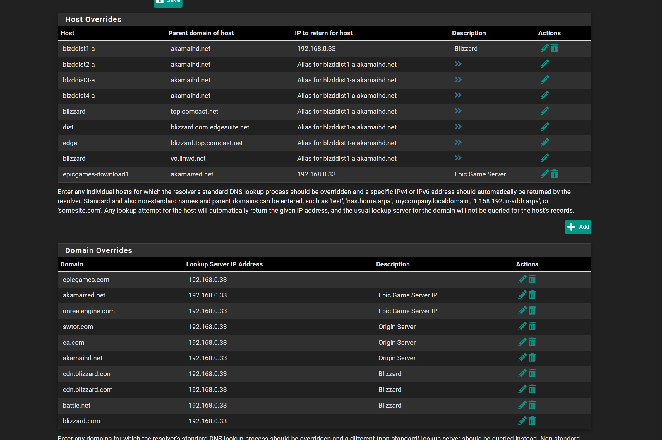

                                      i must done something wrong... with the address's i added.. i not longer have access cant long into my epic of blizzard or orgin.
                                      i must done something dumb somewhere
                                      and does the host /domain override only apply to network outgoing? or all as i have it set for nordvpn out... not for WAN for non vpns
                                      but here is the screen shots doesnt seem to be working
                                      for some reason its like blocked it now instead of allowed it.. i fixed couple things where i had domain.. but epic and blizzard used teh same servers so i added them to host override.. fixed the dup and conflicts but didnt fix it ...
                                        Ok so the script made a list of host overrides but not in the Unbound format. That looks like the DNSMasq format.
                                        Ok, yes if you used a domain override in pfSense to point at Lancache and that was itself using pfSense then you would create a loop for anything Lancache didn't override.
                                        Yes, pfBlocker can serve to block ads etc. Like PiHole.
                                        Those host and domain overrides you have added look correct. If you try to resolve one of them from a host using pfSense for DNS does it return 192.168.0.33?
                                        If so then it's probably failing because Lancache is not answering the queries.

                                          how can i import that though into resolver overrides.. but they dont break it down by host and domain though
                                          ya so my i testing on my 1 comp
                                          gateway and dns points to 192.168.0.1
                                          and i fixed a couple of the domain host overrides so they not conflicting and they all point to 192.168.0.33
                                          and i set the upstream dns to 1.1.1.1 so it wouldnt run in circles not getting internet by pointing to 192.168.0.1 on the lancache dns... but its also not working.. its like now i have those... now all internet access for blizzard launcher orgin launcher and epic launcher have no internet.. is there another check box i need to set to enable it.. and resolver is enabled.. as i use it for NordVPN
                                          ive never used pihole and i was going to but from some videos they said pfsense is better then pihole and why use a raspberry pi if you got pfsense so never tried pihole...
                                          so i not sure what you mean if i resolve from a host using pfsense for dns does it return 192.168.0.33...
                                          if you mean if i try to use epic blizzard or orgin launcher.. no it doesnt... it actually seems to not allow it.. traffic graph shows nothing..
                                          but if i set the computer ethernet connection from 192.168.0.1 dns to 192.168.0.33 then it goes back to working..
                                          as im sure when you add those overrides... you set your computers to 192.168.0.1 as the dns like normally and redirection happens at pfsense level and goes to 192.168.0.33
                                          thats what i guess..
                                          so right now only way its working is like before i set up these over rides.. 192.168.0.33 in the windows ethernet dns...
