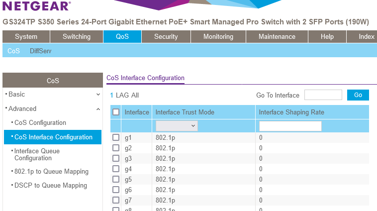

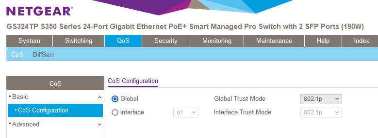

                The frame size is 1500 which is the smallest the switch allows. Flow control is disabled. I couldn't find rate control
                • johnpozJ Online
                  johnpoz LAYER 8 Global Moderator @CreationGuy

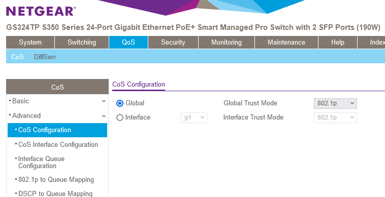

                  @creationguy click the advanced. Clearly it supports it - because its right in the manual
                  CreationGuyC 1 Reply Last reply Reply Quote 0
                  • CreationGuyC Offline

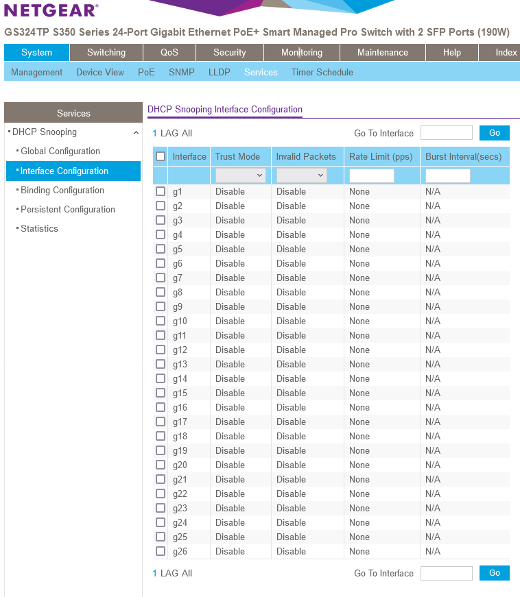

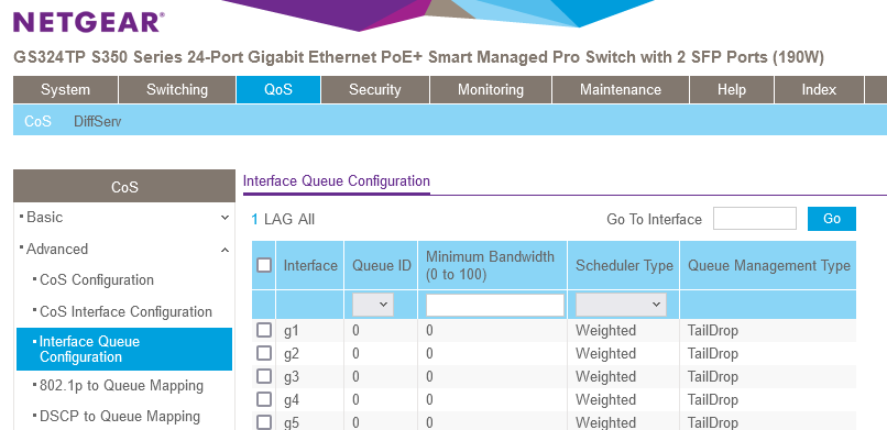

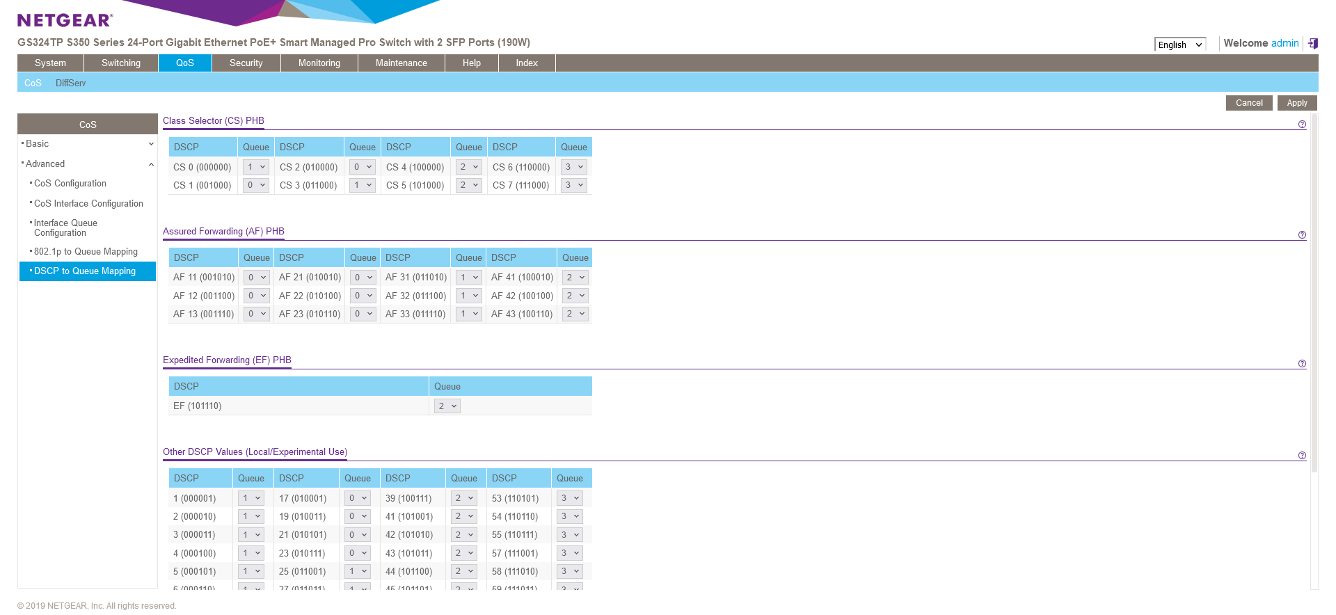

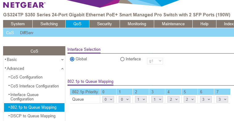

                    CreationGuy @johnpoz
                    @johnpoz Screenshot 2022-07-20 at 21-58-53 NETGEAR GS324TP.png Screenshot 2022-07-20 at 21-59-04 NETGEAR GS324TP.png Screenshot 2022-07-20 at 21-59-26 NETGEAR GS324TP.png Screenshot 2022-07-20 at 21-59-41 NETGEAR GS324TP.png Screenshot 2022-07-20 at 21-59-52 NETGEAR GS324TP.png
