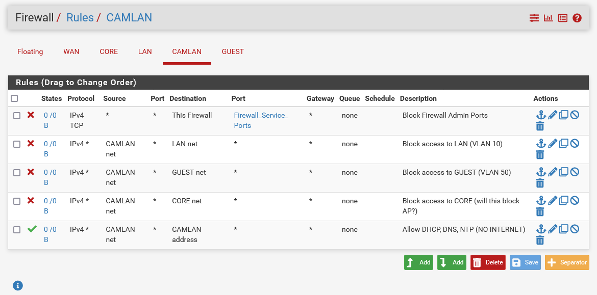

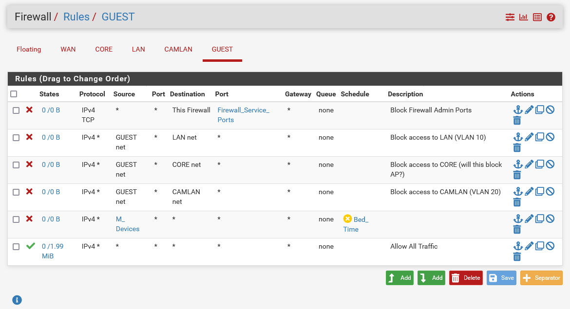

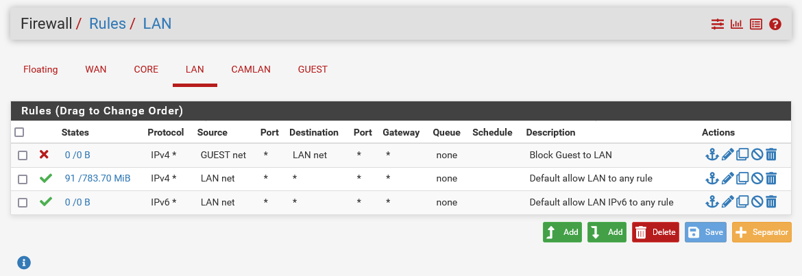

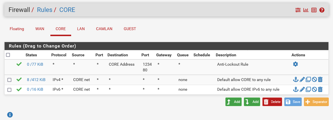

                                      Screenshot 2022-07-27 at 22-33-08 TheWall.jrfam.lan - Firewall Rules CORE.png Screenshot 2022-07-27 at 22-32-58 TheWall.jrfam.lan - Firewall Rules GUEST.png Screenshot 2022-07-27 at 22-32-51 TheWall.jrfam.lan - Firewall Rules CAMLAN.png Screenshot 2022-07-27 at 22-32-43 TheWall.jrfam.lan - Firewall Rules LAN.png

                                        The 'Block Guest to LAN' rule you have on LAN can never match anything. Traffic with source 'Guest net' should never come into the LAN.
                                        CreationGuyC 1 Reply Last reply Reply Quote 0
                                          The Dual NIC chipset was my mistake, I assumed it was by looking at it. It's removed now. I was using it prior to yesterday for testing- that was the odd cause of the inter-vlan slowness.
                                          I was wondering if that LAN rule was off; other than that, it looks fine?

                                            Yes, looks reasonable otherwise.
