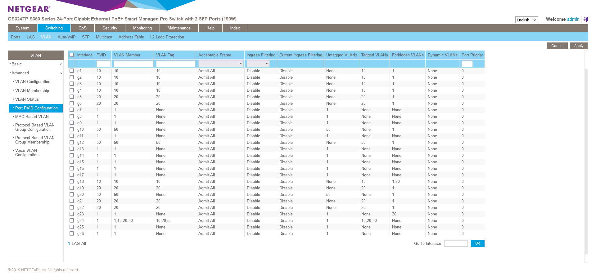

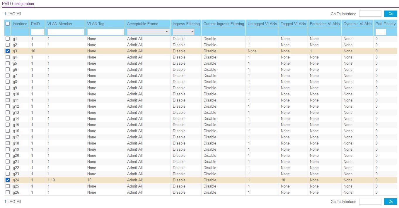

                          Roku is Port 10, ObiTalk is Port 20. 24 = the port going to pfsense.
                          @johnpoz Same VLAN speeds are fine, inter-vlans (this is not in regards to the Roku).
                            Jarhead @CreationGuy
                            @creationguy You have every port untagged with vlan 1, why?
                            You also have ports that should be in the other vlans as tagged. They should be untagged.
                            Good rule of thumb, you only tag a vlan if the device you're plugging into that port is also tagged.
                            Remove vlan 1 from ports it's not being used on and untag the ports that are not trunked.
                            So ports 1-4 should be untagged with vlan 10 ONLY.
                            Ports 5 and 6 untagged with vlan 20 only etc.
                            CreationGuyC 1 Reply Last reply Reply Quote 0
                            • CreationGuyC Offline
                              CreationGuy @Jarhead
                              @jarhead I am new to VLANs, I found a couple of guides for Netgear managed switches and that's what worked. I've updated the settings:
                              VLAN 1 is a default VLAN on the switch that I can't seem to disable.
                              In order for me to get the two devices on guest to obtain an IP, I had to:
                              Un-tag the two ports, and set their PVID to the VLAN as these devices are not 802.1q aware. I found this thread here.
                              I don't have a way though to test if these devices can reach other VLANs. I do know that desktops on this VLAN 50 can't see devices on other VLANs, but those devices are not set up the same way (Untagged None).
                              Edit: I placed a desktop in VLAN 50, the same manor as port 10 pictured above. I have a firewall rule set up so that 50 cannot access ANY, just internet. VLAN 10 can access all VLANs. This desktop cannot ping desktop in VLAN 10 until a desktop in VLAN 10 pings that VLAN 50 desktop. After awhile, VLAN 50 desktop can no longer ping VLAN 10 desktop. See below for the rules.

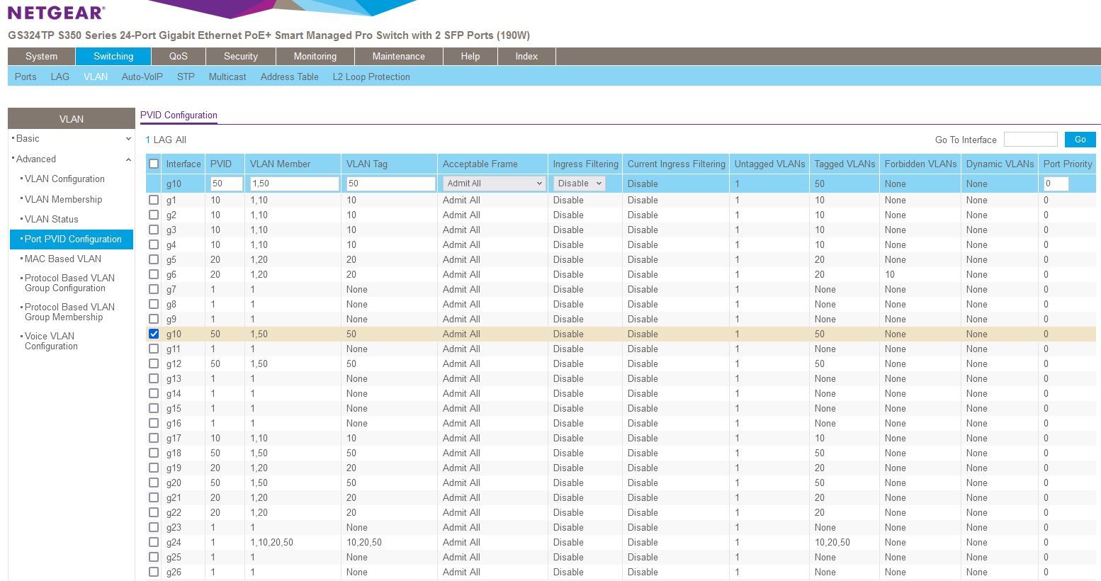

                                @creationguy You still have the ports tagged. They should be untagged unless your devices themselves are also tagged (hint: they aren't).
                                Ports 1-6 should be untagged ONLY. Nothing tagged on them. Along with all other ports that are "device" ports.
                                Only port that should be tagged is trunk ports (hint: port 24).
                                So only the port going to pfSense and any ports going to AP's that are using vlans if you have any.
                                  @jarhead I'm confused now- you should that ports 1-6, which I want on VLAN 10 should be untagged, are you saying untagged under the VLAN Tag column?
                                  I reset the switch, and configured port 7 for VLAN 10.
                                  Thank you for taking the time to help with this.
                                    @creationguy Again, only tag a port if the device connected to it is also tagged.
                                    So if you're plugging pc's into ports, they should be untagged ports.
                                    If you go back to the pic from the previous post, under the "Vlan tag" column, all ports should be NONE except the port going to pfSense (port 24).
                                    1-4 should be untagged with vlan id 10, 5 and 6 untagged with vlan id 20.
                                    They should all (except 24) look like port 20 except with the correct vlans on them.
                                    Fix the switch, then we'll get to the firewall. You have issues there with understanding rules.
                                    @johnpoz will go into much more detail for you than I will but to sum it up, putting a rule on vlan 10 does not stop other vlans from talking to vlan 10. You need a rule on the other interfaces to do that.
                                    That's why you could ping one way, which created a state that allowed you to ping the other way.

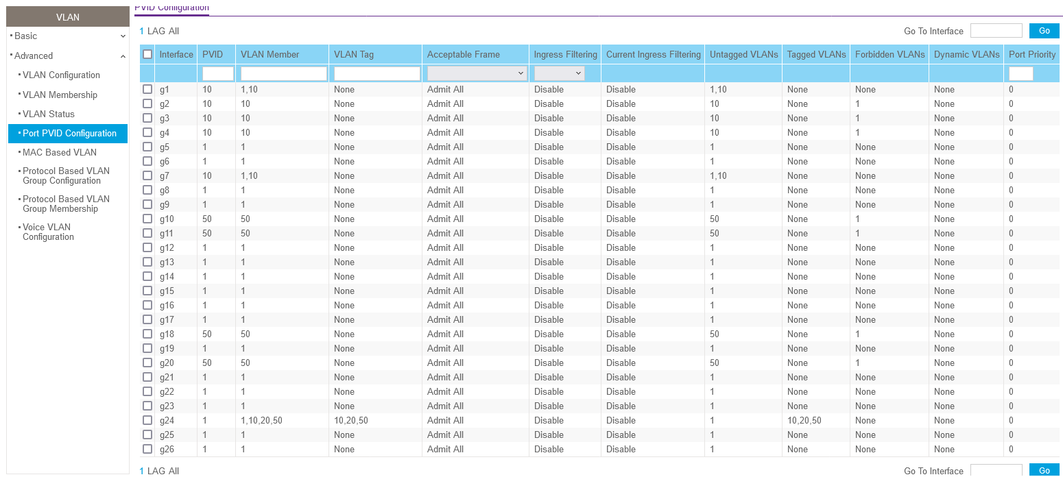

                                      @jarhead
                                      Ports 1-4 should be on VLAN 10, with port 1 needing to access VLAN 1 which is the switch (built in Netgear setting).
                                      The others shown are guest devices, of which, can't access VLAN 10, unless the device on VLAN 10 pings it. Eventually it stops being able to ping it.

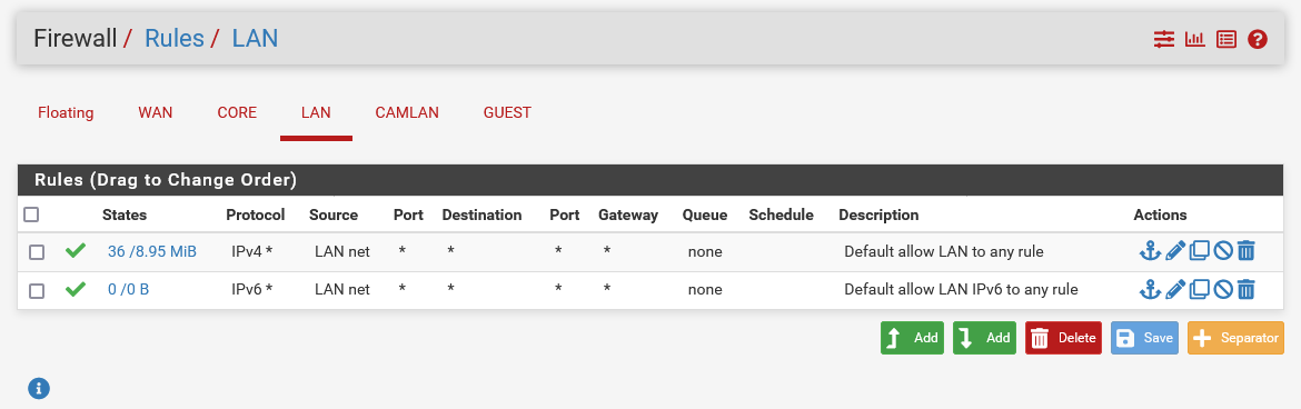

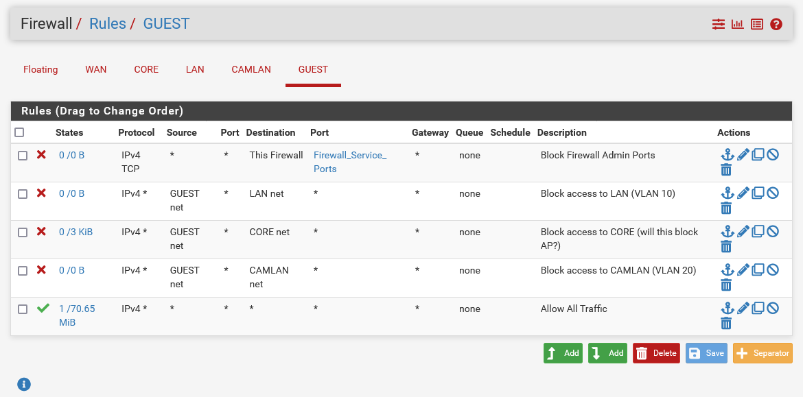

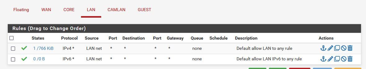

                                      I thought that my rules were fine, as shown below, I have the Guest set to not be able to communicate with the specified VLANs.
                                      Screenshot 2022-07-24 at 22-19-40 TheWall.jrfam.lan - Firewall Rules GUEST.png
                                      Screenshot 2022-07-24 at 22-19-50 TheWall.jrfam.lan - Firewall Rules LAN.png
                                      R J 2 Replies Last reply Reply Quote 0
                                        rcoleman-netgate Netgate @CreationGuy
                                        @creationguy said in Odd internet slowness with Netgear GS324TP Switch:
                                        Having port 1 as untagged on two VLANs can cause problems and could result in data leaking into VLAN 10.
                                        Ryan
                                          @creationguy Get rid of vlan 1 on ports 1 and 7. If you're saying you can't take it off of port 1, switch ports. ie leave port 1 at vlan 1 only and use port 5 as vlan 10.
                                          As I said earlier, you'll need to add a rule on your other interfaces to stop them from accessing vlan 10. You can use the copy feature of your existing rule and just change the interface it's on and source/destination as needed.
                                            How would I configure the port so that I could access the switch to manage?
                                            J R 3 Replies Last reply Reply Quote 0
