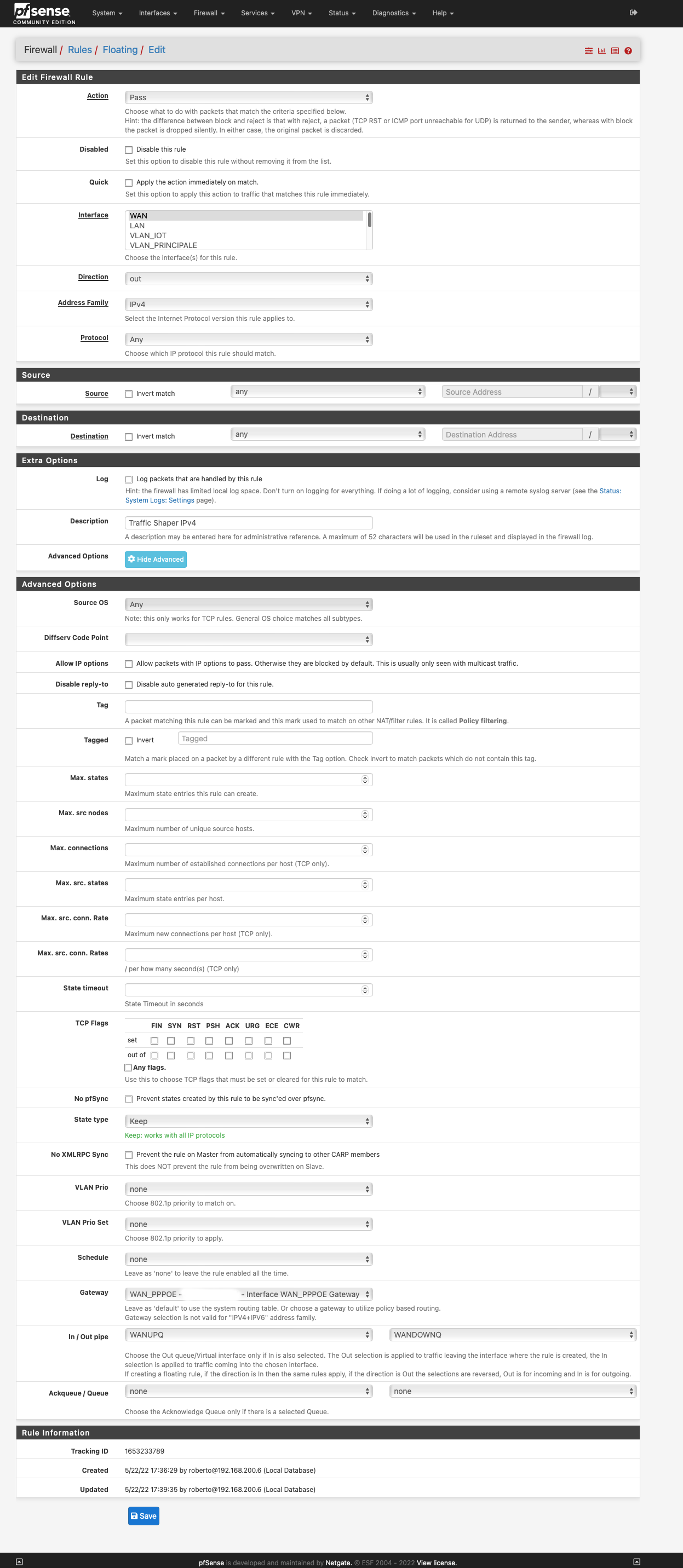

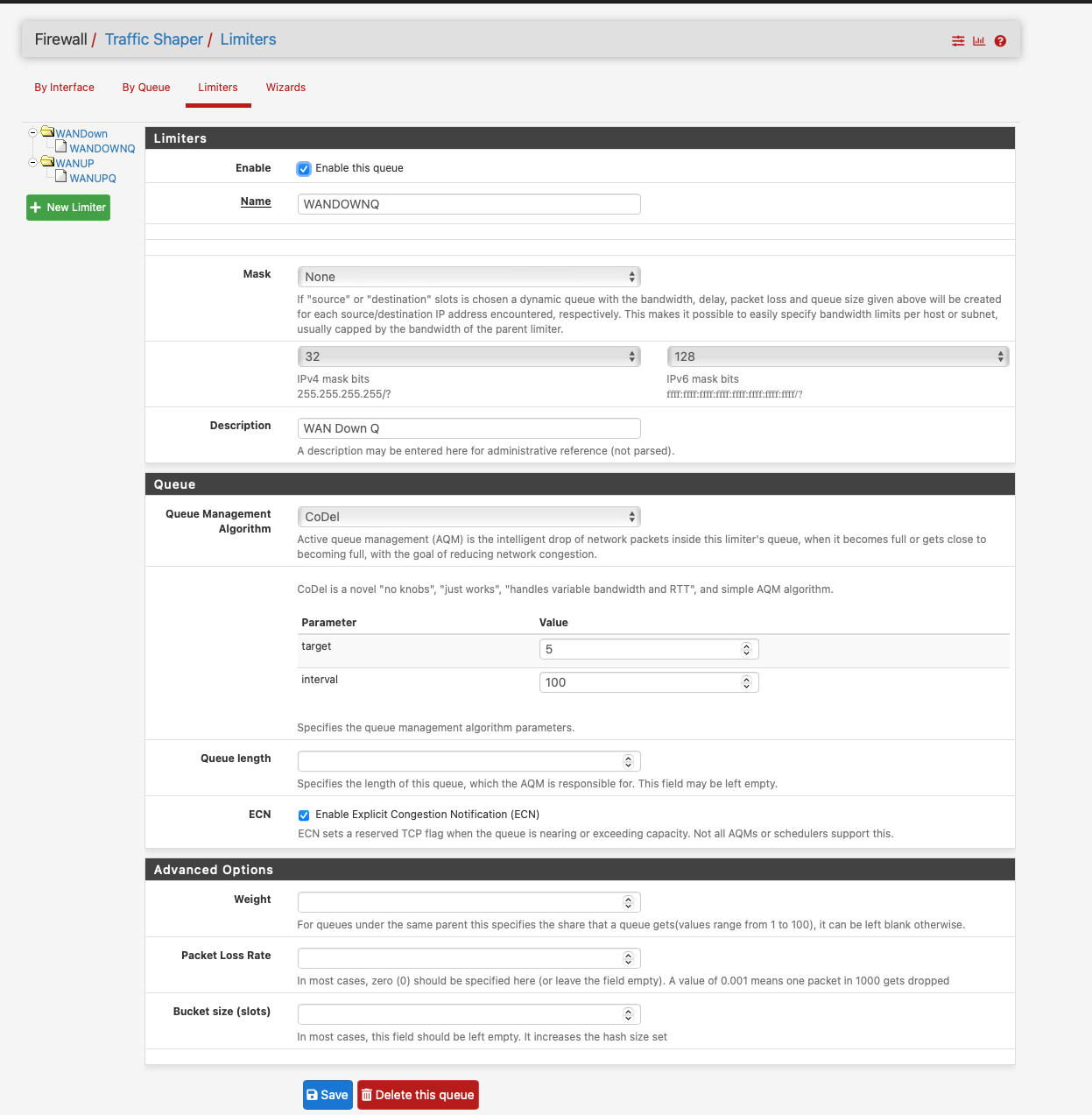

                  Yes I have limiter active on both
                  These are how them are configured
                  Down
                  Up
                  Firewall
                  I used this video as guide/base setup
                  https://www.youtube.com/watch?v=iXqExAALzR8
