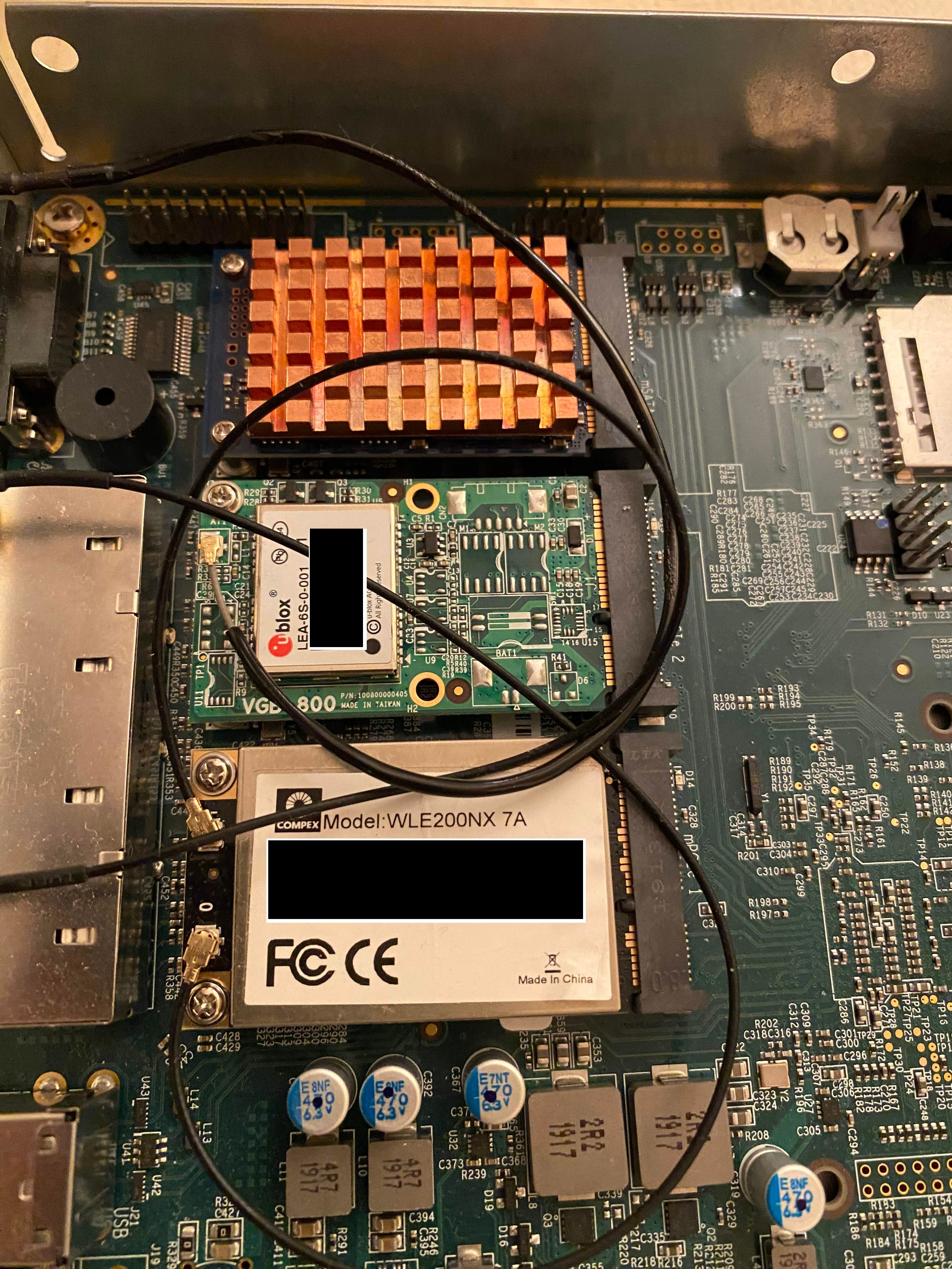

OK, until today I got it working.
A miniPCIe card with U-blox LEA6-T chipset, for ~12 ā¬ at eBay.de together with an miniCPIe to USB adapter and a active GPS antenna plus an extra connection cable from the card to the antenna. All was done and working in 45 minutes ou of the box!
[23.01-RELEASE][root@Dockmaster.Heimnetz]/root: ntpq ntpq> pe remote refid st t when poll reach delay offset jitter ============================================================================== GPS_NMEA(0) .GPS. 0 l 1564 64 0 0.000 -402.18 0.000 *GPS_NMEA(0) .GPST. 0 s 11 64 377 0.000 +13.282 2.877
[23.01-RELEASE][root@Dockmaster.Heimnetz]/root: cu -s 9600 -l /dev/cuaU1 Connected $GPRMC,220237.00,A,5225.50813,N,00928.42376,E,0.923,,200223,,,A*77 $GPGGA,220237.00,5225.50813,N,00928.42376,E,1,04,3.87,47.0,M,46.0,M,,*6B $GPGLL,5225.50813,N,00928.42376,E,220237.00,A,A*67 $GPZDA,220237.00,20,02,2023,00,00*63 $GPRMC,220238.00,A,5225.50766,N,00928.42412,E,0.941,,200223,,,A*74 $GPGGA,220238.00,5225.50766,N,00928.42412,E,1,04,3.87,47.0,M,46.0,M,,*6C $GPGLL,5225.50766,N,00928.42412,E,220238.00,A,A*60 $GPZDA,220238.00,20,02,2023,00,00*6C $GPRMC,220239.00,A,5225.50784,N,00928.42448,E,0.617,,200223,,,A*7A $GPGGA,220239.00,5225.50784,N,00928.42448,E,1,04,3.87,47.0,M,46.0,M,,*6E $GPGLL,5225.50784,N,00928.42448,E,220239.00,A,A*62 $GPZDA,220239.00,20,02,2023,00,00*6D $GPRMC,220240.00,A,5225.50754,N,00928.42476,E,0.775,,200223,,,A*71 $GPGGA,220240.00,5225.50754,N,00928.42476,E,1,04,3.88,47.0,M,46.0,M,,*6F $GPGLL,5225.50754,N,00928.42476,E,220240.00,A,A*6C $GPZDA,220240.00,20,02,2023,00,00*63 $GPRMC,220241.00,A,5225.50733,N,00928.42503,E,0.863,,200223,,,A*7A $GPGGA,220241.00,5225.50733,N,00928.42503,E,1,04,3.88,47.0,M,46.0,M,,*6C $GPGLL,5225.50733,N,00928.42503,E,220241.00,A,A*6F $GPZDA,220241.00,20,02,2023,00,00*62 $GPRMC,220242.00,A,5225.50733,N,00928.42507,E,0.905,,200223,,,A*7C $GPGGA,220242.00,5225.50733,N,00928.42507,E,1,04,3.89,47.0,M,46.0,M,,*6A $GPGLL,5225.50733,N,00928.42507,E,220242.00,A,A*68 $GPZDA,220242.00,20,02,2023,00,00*61 $GPRMC,220243.00,A,5225.50756,N,00928.42473,E,0.820,,200223,,,A*7A $GPGGA,220243.00,5225.50756,N,00928.42473,E,1,04,3.89,47.0,M,46.0,M,,*6A $GPGLL,5225.50756,N,00928.42473,E,220243.00,A,A*68 $GPZDA,220243.00,20,02,2023,00,00*60 $GPRMC,220244.00,A,5225.50759,N,00928.42473,E,0.785,,200223,,,A*72 $GPGGA,220244.00,5225.50759,N,00928.42473,E,1,04,3.89,47.0,M,46.0,M,,*62 $GPGLL,5225.50759,N,00928.42473,E,220244.00,A,A*60 $GPZDA,220244.00,20,02,2023,00,00*67 $GPRMC,220245.00,A,5225.50760,N,00928.42450,E,0.504,,200223,,,A*73 $GPGGA,220245.00,5225.50760,N,00928.42450,E,1,04,3.90,47.0,M,46.0,M,,*60 $GPGLL,5225.50760,N,00928.42450,E,220245.00,A,A*6A $GPZDA,220245.00,20,02,2023,00,00*66 $GPRMC,220246.00,A,5225.50779,N,00928.42443,E,0.451,,200223,,,A*7B $GPGGA,220246.00,5225.50779,N,00928.42443,E,1,04,3.90,47.0,M,46.0,M,,*69 $GPGLL,5225.50779,N,00928.42443,E,220246.00,A,A*63 $GPZDA,220246.00,20,02,2023,00,00*65 $GPRMC,220247.00,A,5225.50733,N,00928.42446,E,0.485,,200223,,,A*78 $GPGGA,220247.00,5225.50733,N,00928.42446,E,1,04,3.90,47.0,M,46.0,M,,*63 $GPGLL,5225.50733,N,00928.42446,E,220247.00,A,A*69 $GPZDA,220247.00,20,02,2023,00,00*64
MiniPCIe card ~12 ā¬
Antenna ~9 ā¬
Internal Connection cable ~8 ā¬
USB to miniCPIe adapter for WWAN cards for ~11 ā¬
Together with the shipping fee all in all for around 50 ā¬You must install first over the USB to miniCPIe adapter
on an Windows PC and configure the card according
and matching your needs, LEA-6S is not sorted with an ability to flash, it has only a rom, you must store the config on the PC and reload it onto the rom and save then all is fine.This can be done with the Ublox software for free from U-blox companies website
After this inserting it in pfSense choose NTP > GPS
and wait several hours. Done. Mostly it uses 4 - 6 or seldom 4 - 8 satellites.Here are some pictures from this setup.
