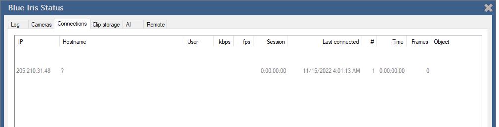

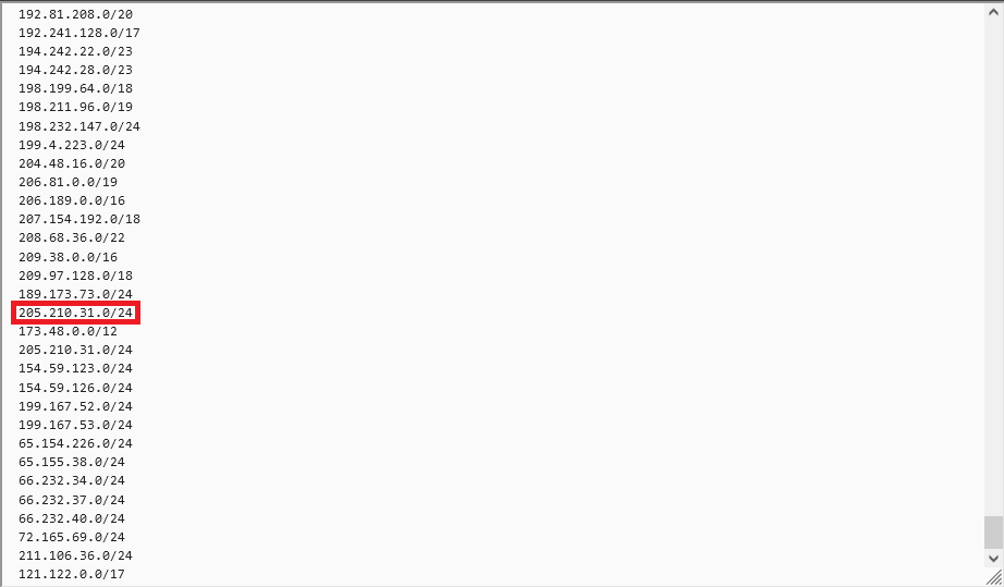

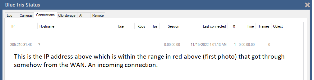

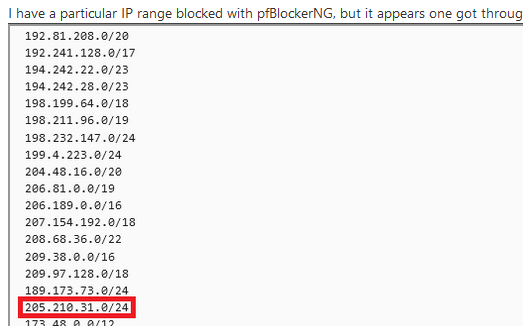

      I have a particular IP range blocked with pfBlockerNG, but it appears one got through, anyway. Thoughts?Screenshot 2022-11-15 at 17-35-02 pfSense.Colossus - Firewall pfBlockerNG IP IPv4.png BI.png
        Gertjan @OBXJeepGuy
        @obxjeepguy
        What are we looking at :
        The original IP feed ?
        The 205.210.31.0/24 could have been whitelisted - is it part of the alias popup when you inspect the pfBlockerNG firewall rule ?

          But was a connection actually made? Or is that what he showing just a connection attempt by the client? Doesn't seem like the session was actually done. There are no frames, there is no time listed for the session, etc. Looks like some sort of connection attempt?

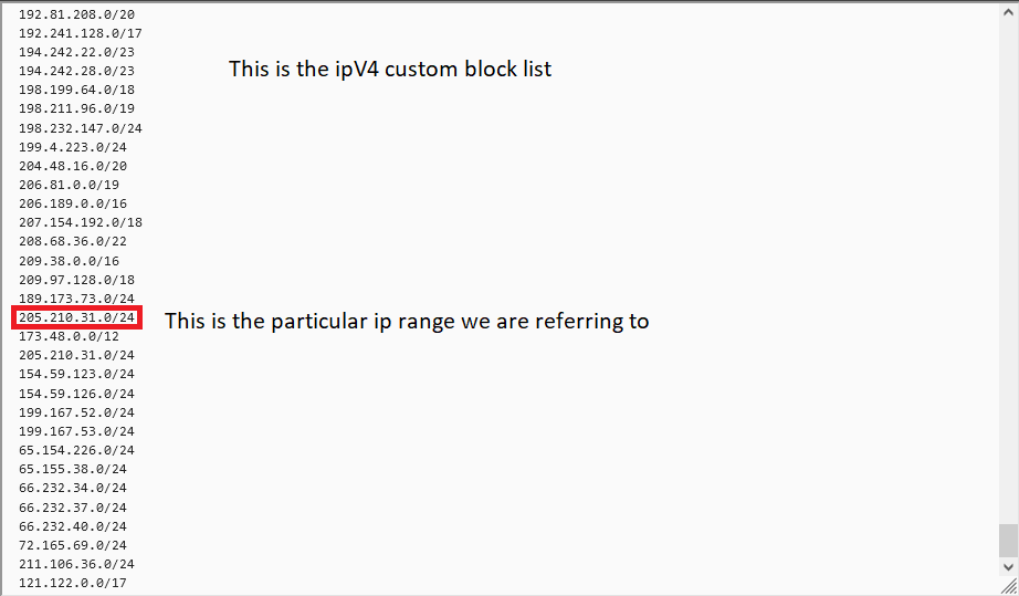

              @gertjan I meant to label everything, but did not. What you are looking at is the custom ipv4 block list in pfBlockerNG. With that in the list, nothing in that range should have gotten past the firewall, yet an ip address from that range came through to my Blue Iris server.

                No connection was actually made. However, that ip address shouldn't even be able to get that far the way it is set up. Also, I have to look into this "state already existed" everyone is talking about.

                  But from what you posted I can not really tell if that is outbound connection attempt from inside your network, or a connection attempt from outside pfsense that is forwarded in?

                      1668552951143-screenshot-2022-11-15-at-17-35-02-pfsense.colossus-firewall-pfblockerng-ip-ipv4.png 1668552958928-bi.png
                      Okay, hopefully this explains it better. I have been running this firewall for about a year now with great success. Once I block a range, I never see another attempt. This particular one is the first time I have seen something like this happen.

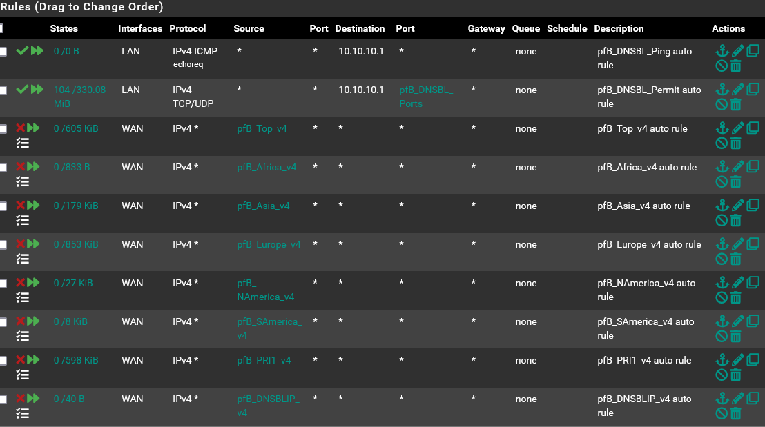

                              Yeah, we need to see the rule and where it's applied really. There are many ways to apply that incorrectly. 😉

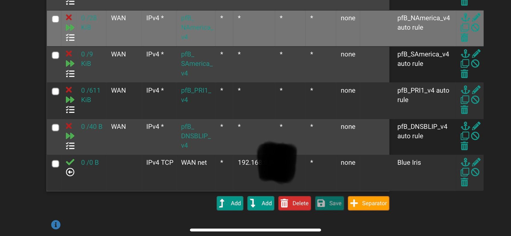

                              • OBXJeepGuyO Offline
                                OBXJeepGuy
                                I am guessing this is what you are looking for.
                                Screenshot 2022-11-17 at 17-27-47 pfSense.Colossus - Firewall Rules Floating.png
                                Screenshot 2022-11-17 at 17-32-42 pfSense.Colossus - Firewall pfBlockerNG IP.png

                                  Those all look like the included list names. Is your custom block list added to one of those?
                                  Or, what 'list action' do you have set on your custom list?

                                    @stephenw10 The custom block list is within pfB_PRI1_v4.

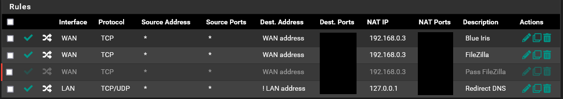

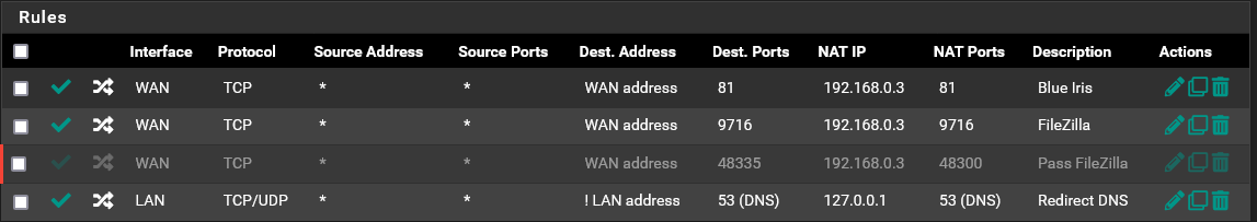

                                      Ok, so that would block connections from that subnet inbound on WAN. And since it's a floating rule it would do so before and pass rules you might have on the WAN tab. You haven't explicitly confirmed it but I assume you have a port forward to the server on WAN with linked firewall rules there?
                                      OBXJeepGuyO 2 Replies Last reply Reply Quote 1
                                        Yes, I do have a port forward going to the server. I should have included that. I’ll post an image as soon as I get back to a PC.

                                          Okay. There it is. Been quite busy at work.
                                            OBXJeepGuy @stephenw10

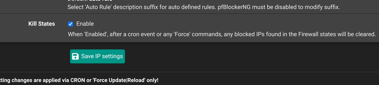

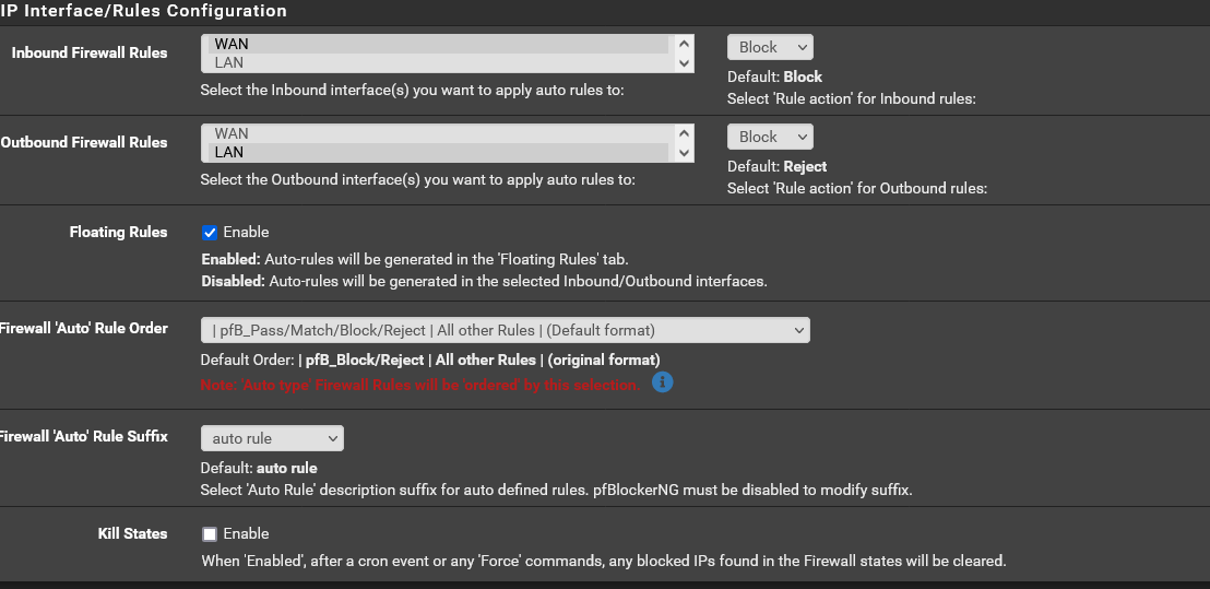

                                            @stephenw10 Now that I look at it, something seems off. I'm not quite sure.
