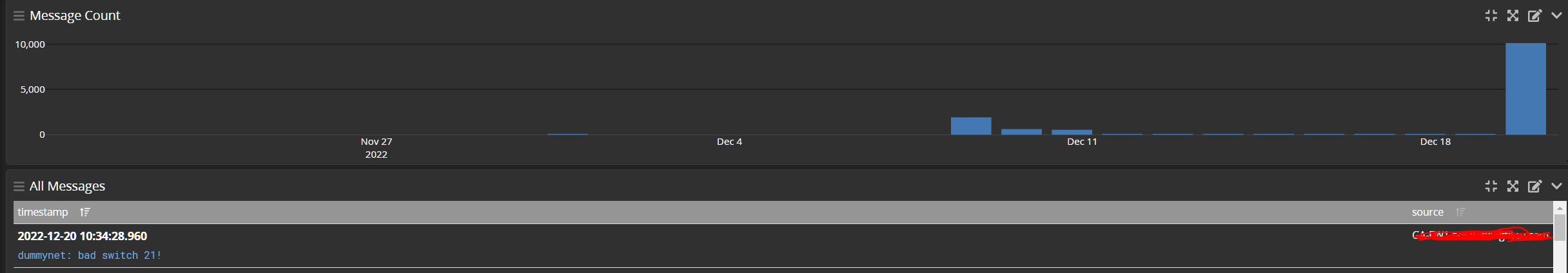

                                          michmoor LAYER 8 Rebel Alliance @marcosm
                                          @marcosm I will say i am getting these messages in my syslog in abundance now.
                                          Checking the last 30 days it hasnt been as present but a huge uptick since last night testing.
                                          @Gertjan I am on 22.05
