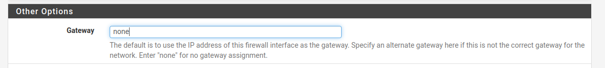

        johnpoz LAYER 8 Global Moderator @Teke
        @teke yeah it should be handing out the gateway out of the box for the lan interface you enabled dhcp on.. So unless you put in "none" in the box I posted above.
        If me I would do a sniff of the dhcp, and look to see if the dhcp server handed that out..
        You can do a sniff (packet capture) under diagnostic menu.. Pick you lan interface and port 67, this will capture dhcp traffic.
        You can then see what the client is asking for - and what the dhcp server returned..

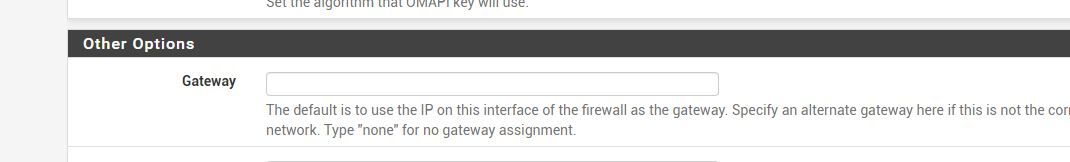

                                    Hmm curious.
                                    Yes, the DHCP server should hand out the interface IP as a gateway for connected clients by default and whether or not the WAN is connected.
                                    The only way I'm aware of to prevent it is to enter none for the gateway IP specifically.
                                    Is it possible you entered that at some point and your browser is auto-filling it?
                                    I assume you're running pfSense 2.6?

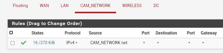

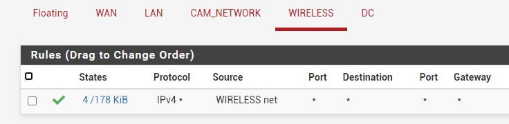

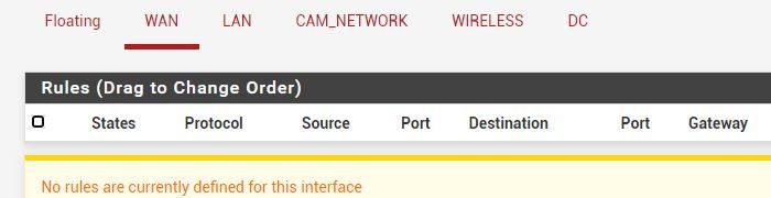

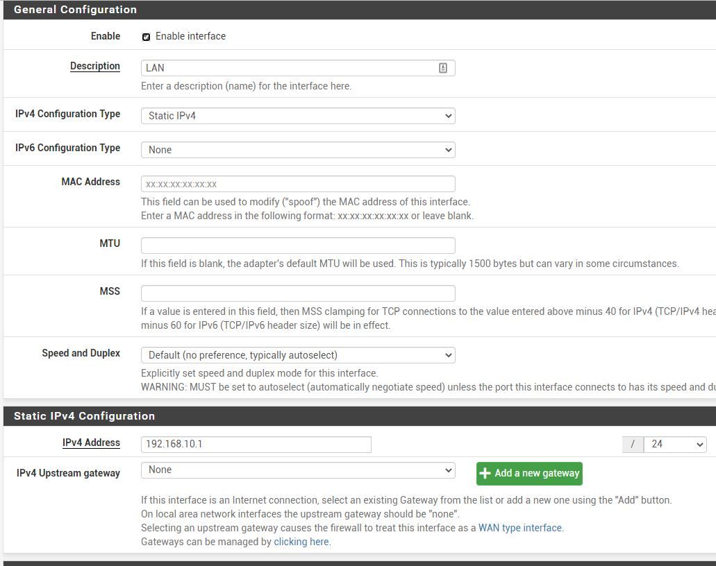

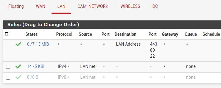

                                      Also Pictures of my firewall settings, dhcp settings.WanFW.JPG LANFW.JPG CAMFW.JPG WirelessFW.JPG DCFW.JPG LANInterface.JPG LANDHCP.JPG capture30.pcapng
                                        With that config any client on LAN should be passed 192.168.10.1 as it's gateway/default route. And that should happen with or without a WAN connection.
                                          @teke not sure what any of that has to do with anything? the only picture that helps is that you don't have none set in the dhcp.
                                          where is the pcap showing your dhcp - so can see if the gateway was offered or even asked for by the client, etc.
