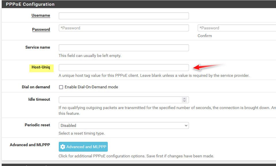

        johnpoz LAYER 8 Global Moderator @craigcpc
        @craigcpc maybe this?
                @craigcpc not a dsl or pppoe user but the host-uniq would be my guess. Good Luck.
                • jimpJ Offline
                  You might also need to put it on the PPPoE username, for example username@domain.tld or in some rarer cases domain\username
                  Do not Chat/PM for help!
                    Is this actually PPPoE? The first post reads like it's DHCP or static...
                    In which case those might be DHCP options. Hostname is one of the defaults, you might need to use the advanced option to send a 'domain' as part of the client request.
