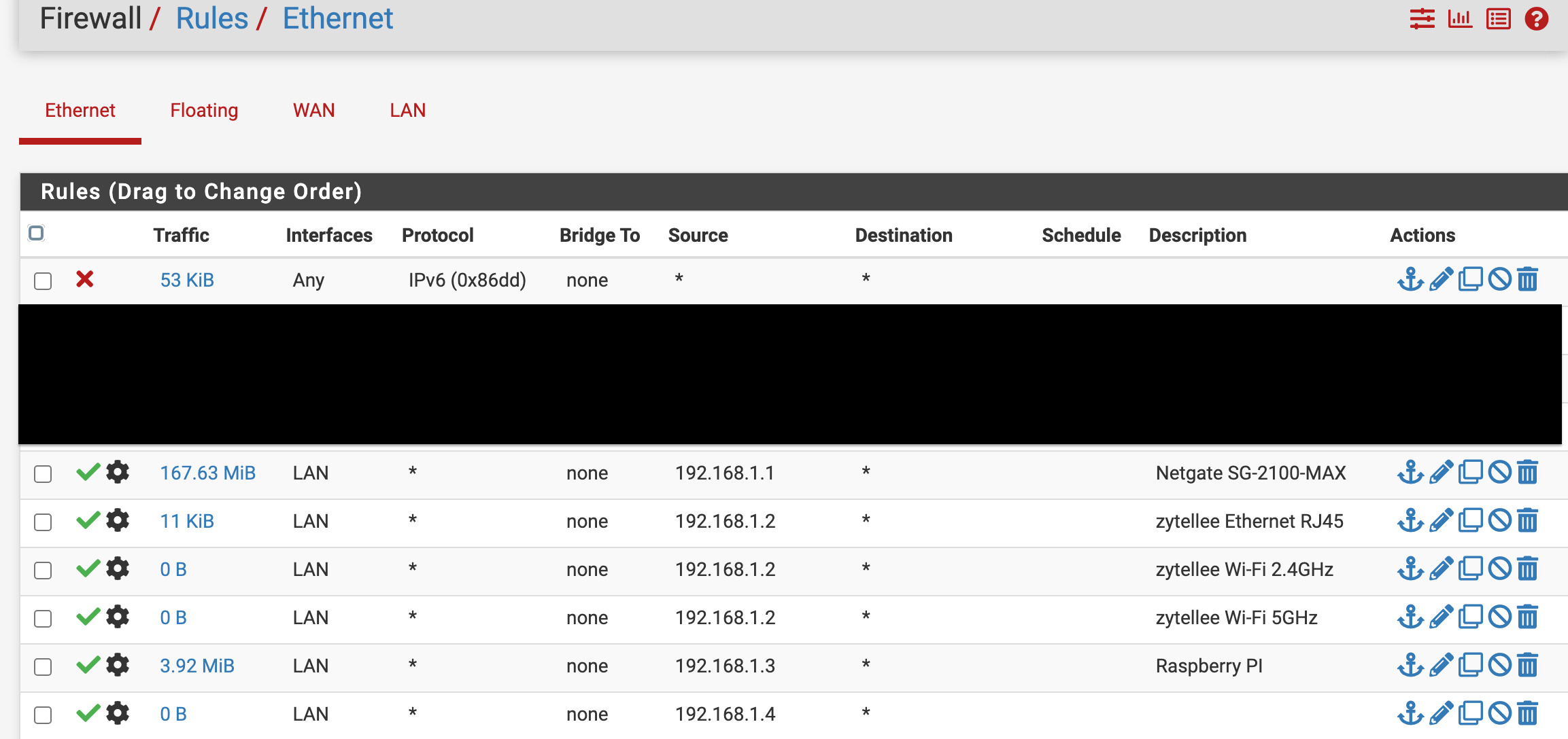

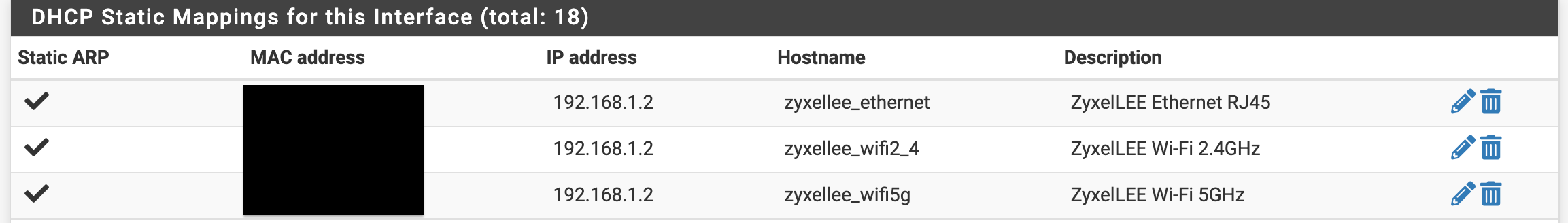

                    It's still using the Ethernet MAC in that screenshot. But because you have 3 hostnames configured for the same IP address it's probably just showing the last matched.
                    • JonathanLeeJ Offline
                      JonathanLee @stephenw10
                      @stephenw10 yeahhh that was the goal so it could find the MAC-IP map when needed and the Ethernet MAC-IP map. Yeahhh ๐Ÿ˜Š so it's updating when needed again it leaves the hostname when it updated to the other MAC in the Arp table but the point is the wireless AP's NAS is mapped.

                          @stephenw10 I made a Redmine ticket for the hostname mix ups because it should update the hostname or block inputting different ones because logs could be wrong if it doesn't use the right hostnames.
                          Make sure to upvote
                          • johnpozJ Online
                            johnpoz LAYER 8 Global Moderator @JonathanLee
                            @JonathanLee said in AP with onboard built in NAS abilities/multiple MAC Hardware Layer 2 addresses:
                            And what is this redmine number? Seems like lack of understanding of basic concepts if you ask me vs some issue with pfsense.
                              If there's a bug here it's probably that you shouldn't be able to add the same IP address to multiple dhcp static mappings.
                              But you can't ever prevent all config errors. ๐Ÿ˜‰

                                  • johnpozJ Online
                                    @JonathanLee
                                    "With Multiple static ARP MAC-IP pairing to the same IP address"
                                    So you don't see the problem with this? Thought you wanted to reduce traffic?
                                    So if I create multiple entries for say 192.168.1.100 for like 3 different mac addresses.. And then I want to send traffic to 192.168.1.100 - so I will put 3 packets on the wire? Sending to all 3 mac addresses?
                                    Like I said lack of understanding of basic concepts is the issue here.
