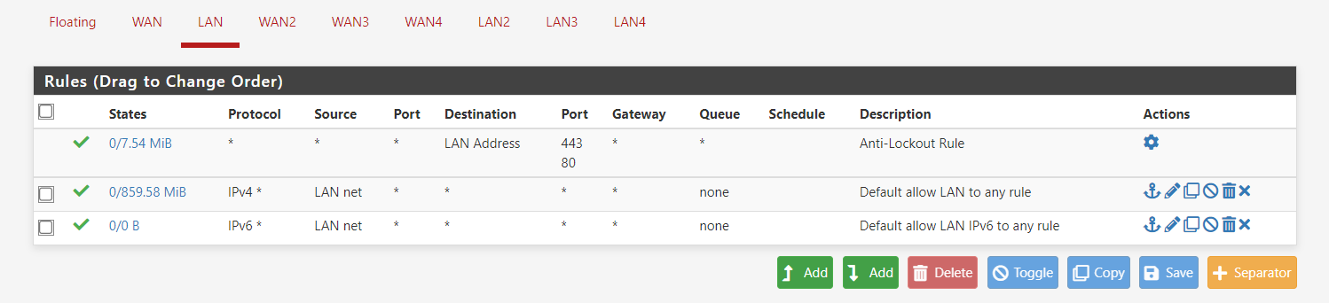

                      here are the LAN firewall rules:

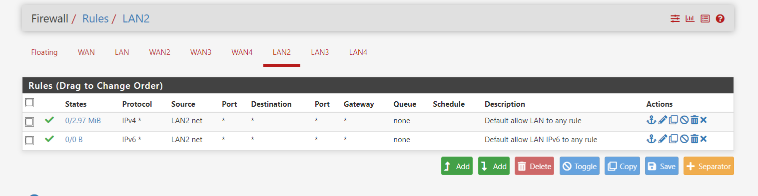

                      Here are the LAN2 firewall rules (duplicated from LAN)

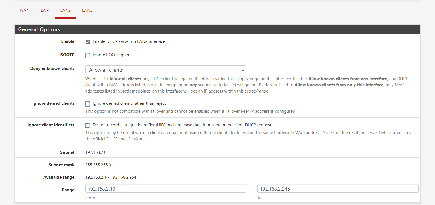

                      Here is the LAN2 DHCP Server setup:

                        UPDATED LAN2 Firewall Rules:
                        The DNS issue persists with these rules set as they are.
                        Thanks for all the help. I am really appreciative.

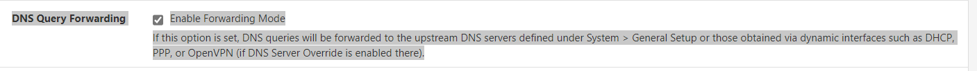

                                I think I solved it. Enable DNS Forwarding Mode under: Services/DNSResolver/General Settings
                                Curious - if there is any issue with this setting?
                                Thanks.
                                  johnpoz LAYER 8 Global Moderator @tonydutt
                                  @tonydutt you shouldn't need to enable forwarding mode, how was lan working without forwarding mode? Was your lan clients pointing to something else for dns other than pfsense?
