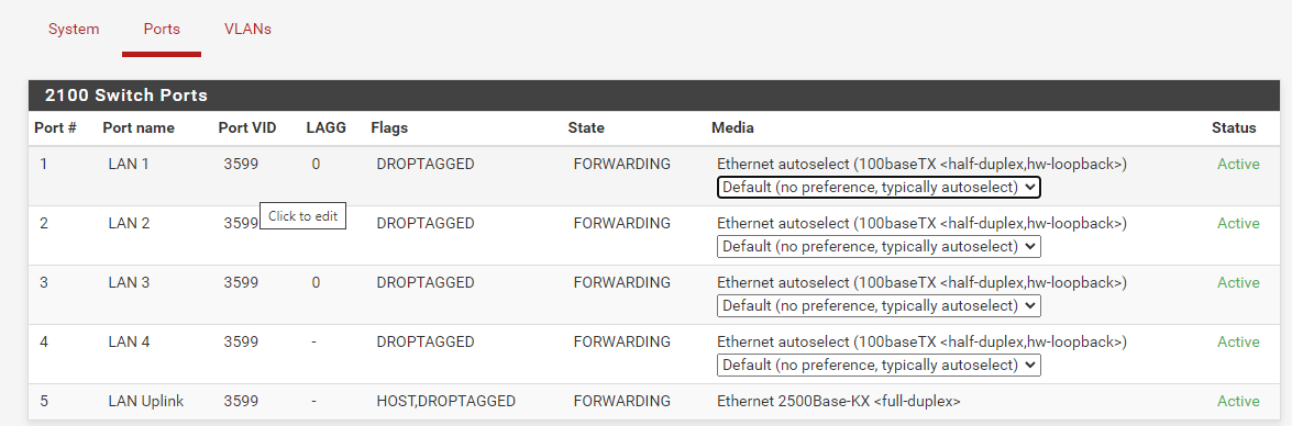

One of our 2100 deployments switch appears to have failed. We use 802.1q vlans on port 4 but today all 4 LAN ports show as active with PVID 3599 and flags DROPTAGGED and media as 100baseTX <half-duplex, hw-loopback>

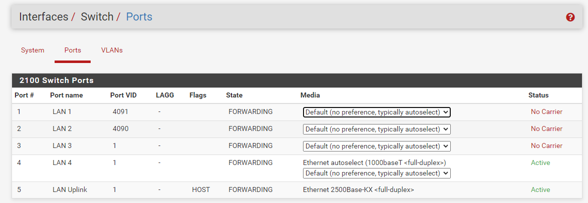

What it usually looks like;
What it currently looks like;
etherswitchcfg output;
etherswitch0: VLAN mode: DOT1Q
port1:
pvid: 3599
state=8<FORWARDING>
flags=80<DROPTAGGED>
media: Ethernet autoselect (100baseTX <half-duplex,hw-loopback>)
status: active
port2:
pvid: 3599
state=8<FORWARDING>
status: active
port3:
pvid: 3599
state=8<FORWARDING>
status: active
port4:
pvid: 3599
state=8<FORWARDING>
status: active
port5:
pvid: 3599
state=8<FORWARDING>
flags=81<CPUPORT,DROPTAGGED>
media: Ethernet 2500Base-KX <full-duplex>
status: active
laggroup0:
members 0,1,2,3
laggroup1:
members 0,1,2,3
laggroup2:
members 0,1,2,3
laggroup3:
members 0,1,2,3
laggroup4:
members 0,1,2,3
laggroup5:
members 0,1,2,3
laggroup6:
members 0,1,2,3
laggroup7:
members 0,1,2,3
laggroup8:
members 0,1,2,3
laggroup9:
members 0,1,2,3
laggroup10:
members 0,1,2,3
laggroup11:
members 0,1,2,3
laggroup12:
members 0,1,2,3
laggroup13:
members 0,1,2,3
laggroup14:
members 0,1,2,3
laggroup15:
members 0,1,2,3
etherswitchcfg: ioctl(IOETHERSWITCHGETVLANGROUP): Invalid argumentUsually etherswitchcfg looks like this;
port1:
pvid: 4091
state=8<FORWARDING>
flags=0<>
media: Ethernet autoselect (none)
status: no carrier
port2:
pvid: 4090
state=8<FORWARDING>
flags=0<>
status: no carrier
port3:
pvid: 1
state=8<FORWARDING>
flags=0<>
status: no carrier
port4:
pvid: 1
state=8<FORWARDING>
flags=0<>
media: Ethernet autoselect (1000baseT <full-duplex>)
status: active
port5:
pvid: 1
state=8<FORWARDING>
flags=1<CPUPORT>
status: active
vlangroup0:
vlan: 1
members 3,4,5
vlangroup1:
vlan: 4090
members 2,5t
vlangroup2:
vlan: 4091
members 1,5t
vlangroup3:
vlan: 2
members 4t,5t
vlangroup4:
vlan: 10
members 4t,5t
vlangroup5:
vlan: 20
members 4t,5t
vlangroup6:
vlan: 30
members 4t,5t
vlangroup7:
vlan: 1000
members 4t,5t
vlangroup8:
vlan: 50
members 4t,5tetherswitchcfg is unable to change the droptagged status on any port, but is seeing all ports.
