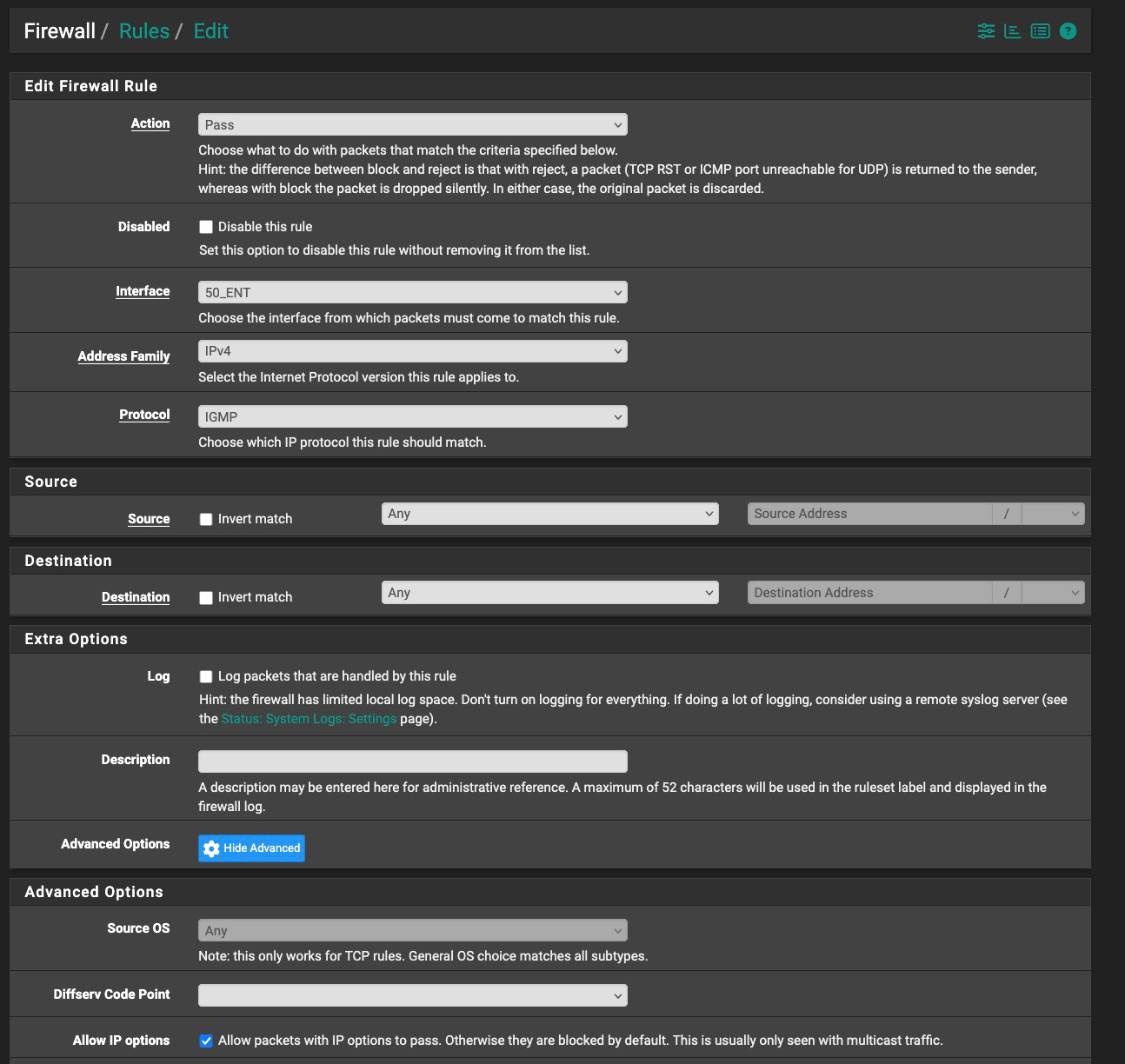

                        @JeremyJ-0 You have to have IP options enabled in the pass rule.
                        Edit: Mine is a floating rule, but here's what it looks like:

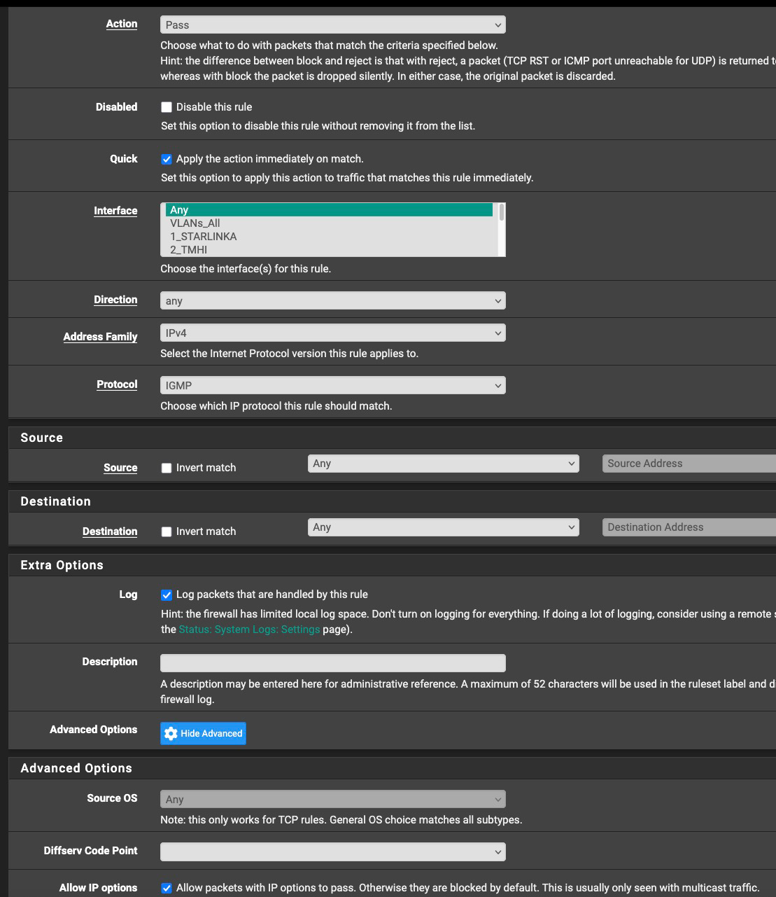

                            @JeremyJ-0 Source should be any rather than LAN subnets.
                            I edited my post above and put in my floating rule which handles IGMP.
                              JeremyJ 0 @dennypage
                              @dennypage did my level best to match your rule: made mine floating, checked 'quick', changed direction to 'in'. It's not exact because I need it to apply to multiple sources where yours is specific to one so left source as 'all'.
                              Still getting deny entries in the log.
                              dennypageD 2 Replies Last reply Reply Quote 0
                              • dennypageD Offline
                                dennypage @JeremyJ 0
                                @JeremyJ-0 You do not need to restrict it. You can, and should, use "any" unless you have a good reason not to.
                                Do exactly this:
                                Make sure the rule is above your default allow.

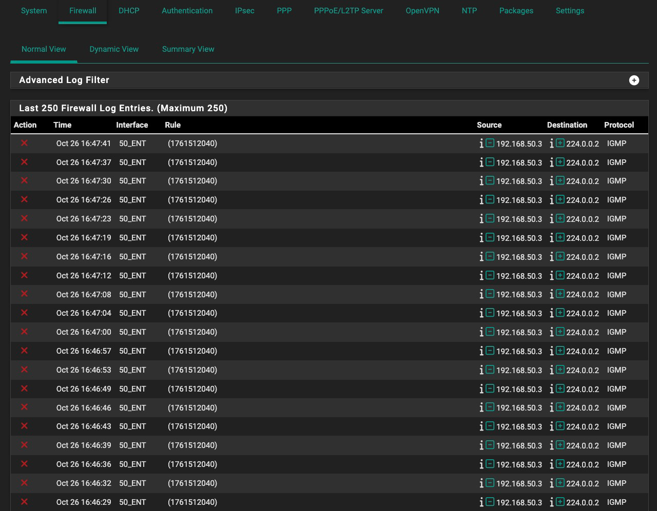

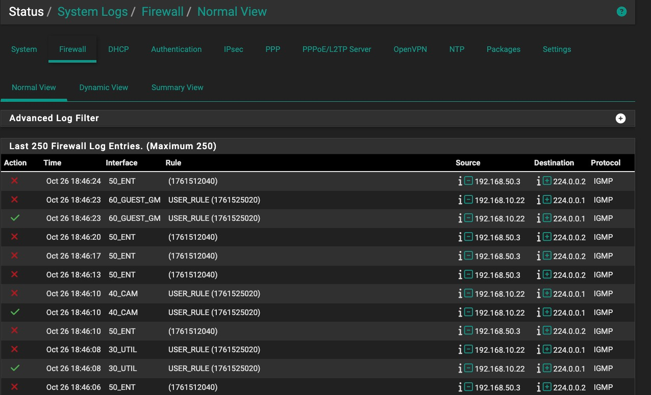

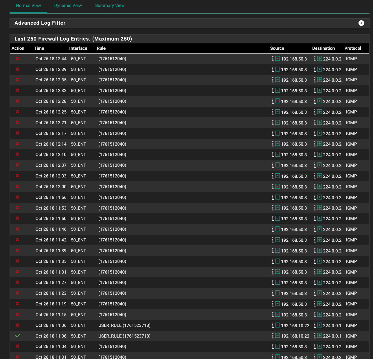

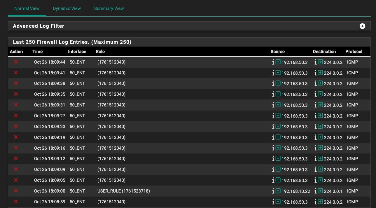

                                          Mission-Ghost

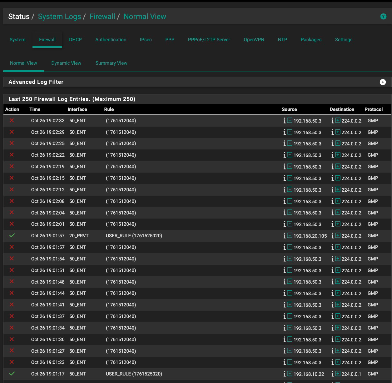

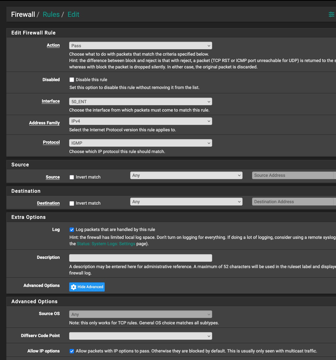

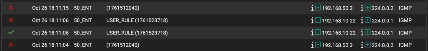

                                          Ran into the same problem today. I tried the suggestions in this thread, short of rebooting, but none work for me on 25.07.1.
                                          I was trying to get the rules and packages right to pass HDHomeRun traffic from my Entertainment VLAN to the other VLANs.
                                          I have had no logging of IGMP packets before doing the following:
                                          I added package avahi but that didn't do it, so I removed that.
                                          I then found and did discussed in the following referenced Reddit thread that solved the problem with passing HDHomeRun traffic to my other VLANs:
                                          https://www.reddit.com/r/PFSENSE/comments/1g2c9qb/hd_homerun_across_vlans/
                                          1. Added package udpbroadcastrelay, which, by itself did not allow the HDHomeRun traffic to pass across my VLANs.
                                          2. Added a floating rule as specified. This rule does not log and allows the desired traffic.
                                          Doing the above seems to have triggered the IGMP logging and there seems to be nowhere to turn it off. I get IGMP packet blocks on the Entertainment VLAN interface logged with a rule number I cannot locate anywhere. I went through all of my explicitly defined rules and none have the number referenced in the logs. (Aside: it would be EXTREMELY helpful to make these numbers hyperlinks that link back to the rule definition.)
                                          I cannot reboot now but maybe will get a maintenance time at some point in the not-too-distant future.
                                          This appears to be a noxious bug that would be valuable to fix. It consumes disk and log space with no value added, no request to do so, and no way to shut it off short of disrupting production with a reboot...assuming that works.
                                          I'll be happy to take a stab at any other ideas to try to find this rule and shut off the logging.
                                          Thanks in advance!

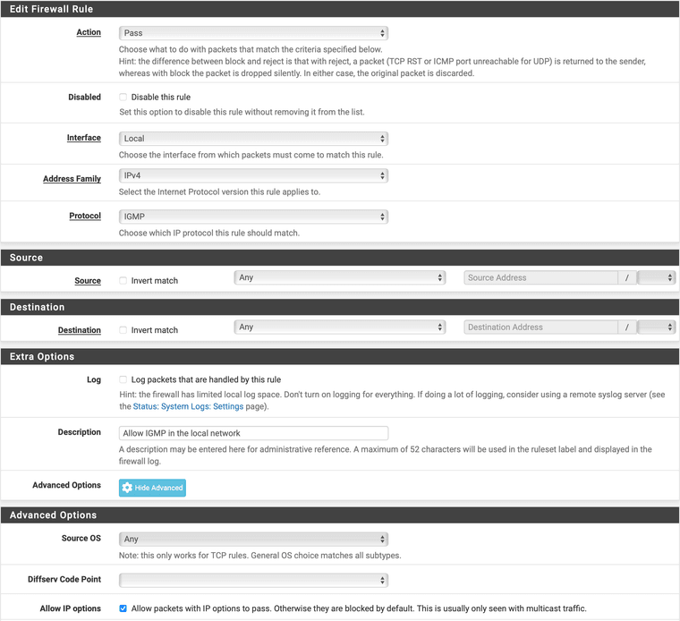

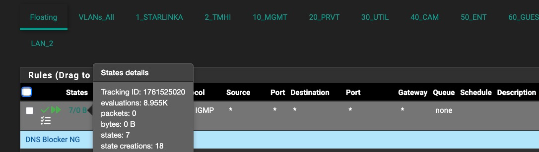

                                            dennypage @Mission-Ghost

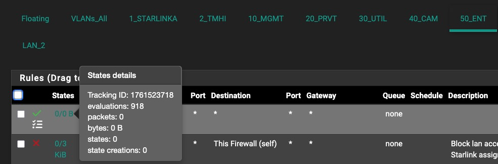

                                            @Mission-Ghost Specifically on the IGMP issue, you have to add a pass rule for IGMP with IP options enabled. Like this:
                                            NB: Local on my firewall is an interface group that contains all the local networks (non WANs).
