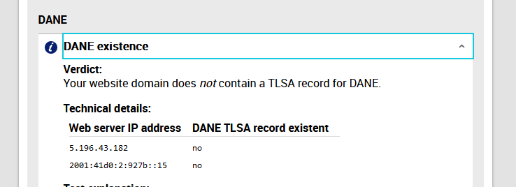

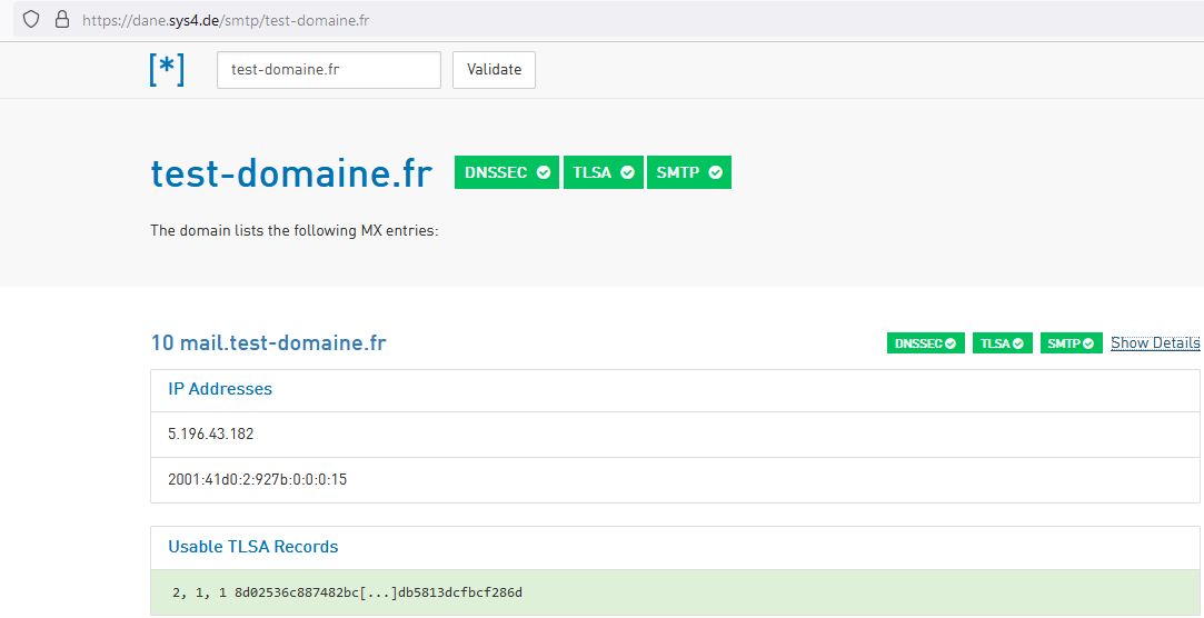

                          When you see him next time, show him this :
                          compared to :
                          Mails I send to gmail (example) confirm that my domain name, my mail server supports DANE.
                          This makes me doubt about the "internet.nl" DANE test.
