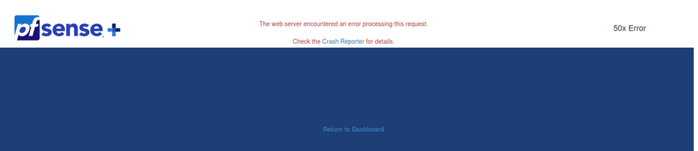

I'm experiencing an issue with the pfSense Plus GUI—it crashes and becomes inaccessible. When this happens, several firewall services such as VPN and the DHCP server also stop working, requiring me to reboot the firewall to restore functionality.
This problem occurs frequently, around 3 to 5 times a day.
Could you please help identify the cause of this issue and advise on how to resolve it?

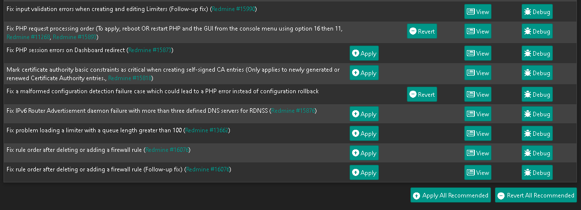

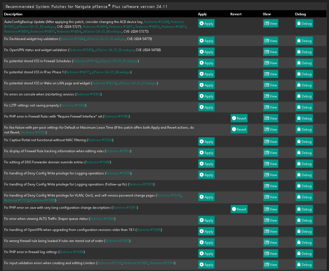

System Patches
Should i apply all the recommended patches?
@smsigroupit Check the main system log.
You can apply the patches but I doubt they will change your symptoms.

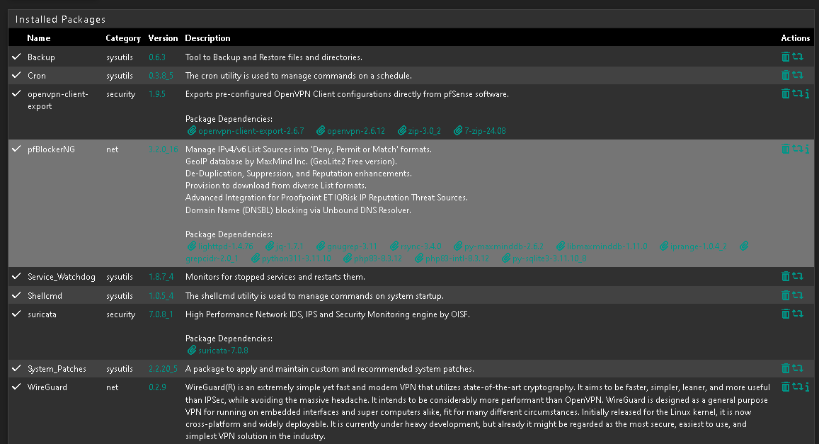

What packages are you running?
Do yo have the service watchdog enabled? If so what things is it checking?
That is really only supposed to be used for troubleshooting and doesn't play nice with everything. If you have it set to watch Suricata for example you can end up with numerous instances running.
But, yes, something is probably using the available php threads and I'd expect to see something in the system logs in the run up to it ceasing to respond.
I assume it' doesn't actually 'crash'? You don't see a kernel panic and crash report?
i already remove the service watchdog, will monitor the system status

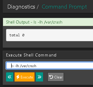

Hmm, check in /var/crash if you can. Any crash report that's still on the system should be there.
there is no files

After applying all the patches, I no longer encountered any crashes in the pfSense GUI.
