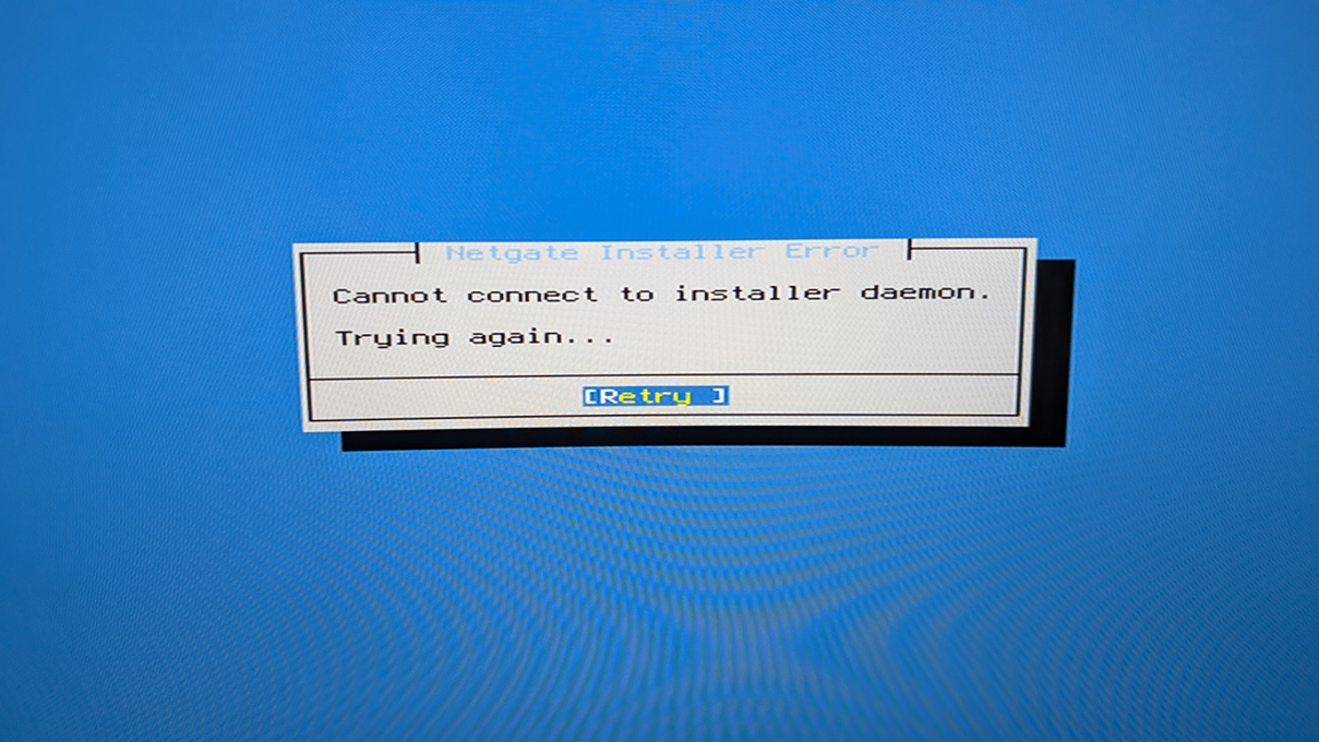

Cannot connect to installer daemon
I am trying to install a fresh install of netgate-installer-v1.0-RC-amd64-20240919-1435.img from USB stick Kingston Datatraveler 100 G3 64 GB.
On this Qotom Q350G4 pc I get "Cannot connect to installer daemon".

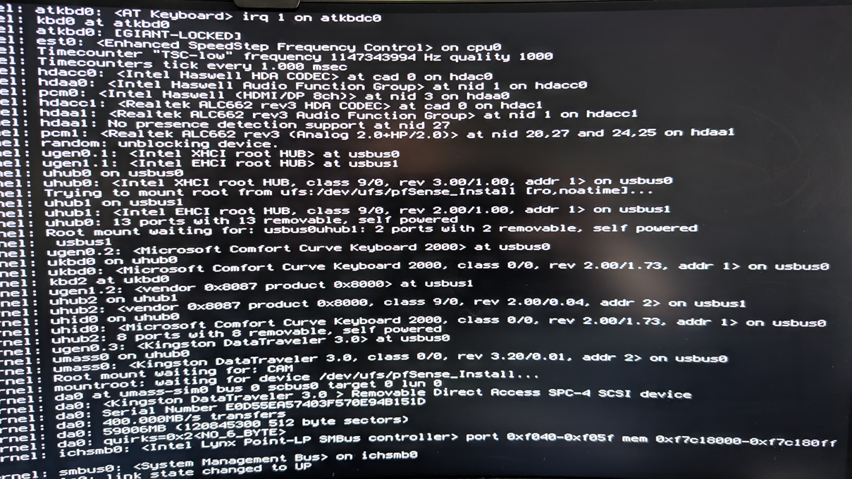

The below picture shows last logs of messages:

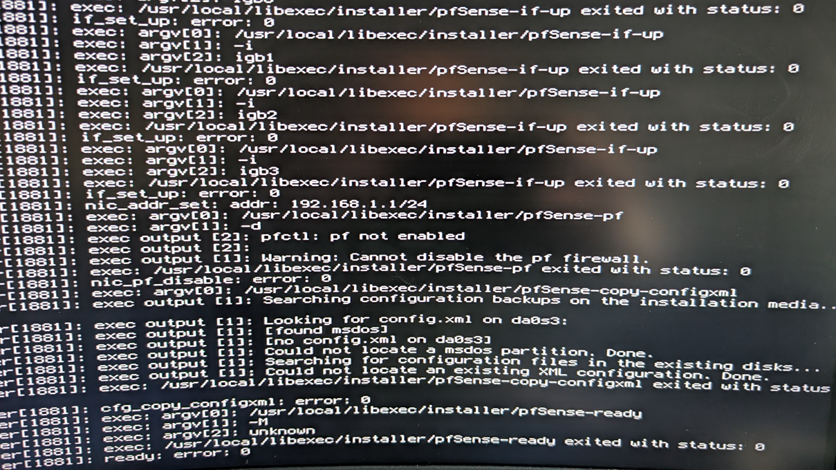

The below picture shows last logs of daemon.log:
From the daemon.log the only strange thing I can find is that the config.xml file can not be found. Could it be that is making the installer halt on "Cannot connect to installer daemon"?

It's looking for a config.xml file to use for restore during the install. So either something on the USB drive or recovered from a previous install. It doesn't find one but that's fine it will still just install with the default values.
I don't see the daemon error there. And the log shows it clearly was running at some point. Where are you seeing that?

It looks like that has a serial console. Have you tried using that?
At least it would make it easy to copy/paste the logs out. -
@stephenw10, sorry for the delay needed to fix a serial to USB adapter.
I tried what you proposed but with same result see below logs from console:
---<<BOOT>>--- Copyright (c) 1992-2024 The FreeBSD Project. Copyright (c) 1979, 1980, 1983, 1986, 1988, 1989, 1991, 1992, 1993, 1994 The Regents of the University of California. All rights reserved. FreeBSD is a registered trademark of The FreeBSD Foundation. FreeBSD 15.0-CURRENT #0 installer-RELENG_v1_0-n256387-33bc50df25b: Thu Sep 19 15:09:47 UTC 2024 root@freebsd:/var/jenkins/workspace/pfSense-installer-snapshots-v1_0-main/obj/amd64/S5t4JeUd/var/jenkins/workspace/pfSense-installer-snapshots-v1_0-main/sources/FreeBSD-src-installer-RELENG_v1_0/amd64.amd64/sys/pfSense-Installer amd64 FreeBSD clang version 18.1.6 (https://github.com/llvm/llvm-project.git llvmorg-18.1.6-0-g1118c2e05e67) VT(efifb): resolution 800x600 CPU: Intel(R) Core(TM) i5-4200U CPU @ 1.60GHz (2294.83-MHz K8-class CPU) Origin="GenuineIntel" Id=0x40651 Family=0x6 Model=0x45 Stepping=1 Features=0xbfebfbff<FPU,VME,DE,PSE,TSC,MSR,PAE,MCE,CX8,APIC,SEP,MTRR,PGE,MCA,CMOV,PAT,PSE36,CLFLUSH,DTS,ACPI,MMX,FXSR,SSE,SSE2,SS,HTT,TM,PBE> Features2=0x7fdafbbf<SSE3,PCLMULQDQ,DTES64,MON,DS_CPL,VMX,EST,TM2,SSSE3,SDBG,FMA,CX16,xTPR,PDCM,PCID,SSE4.1,SSE4.2,MOVBE,POPCNT,TSCDLT,AESNI,XSAVE,OSXSAVE,AVX,F16C,RDRAND> AMD Features=0x2c100800<SYSCALL,NX,Page1GB,RDTSCP,LM> AMD Features2=0x21<LAHF,ABM> Structured Extended Features=0x27ab<FSGSBASE,TSCADJ,BMI1,AVX2,SMEP,BMI2,ERMS,INVPCID,NFPUSG> Structured Extended Features3=0x9c000000<IBPB,STIBP,L1DFL,SSBD> XSAVE Features=0x1<XSAVEOPT> VT-x: PAT,HLT,MTF,PAUSE,EPT,UG,VPID TSC: P-state invariant, performance statistics real memory = 8589934592 (8192 MB) avail memory = 8182452224 (7803 MB) Event timer "LAPIC" quality 600 ACPI APIC Table: <ALASKA A M I > FreeBSD/SMP: Multiprocessor System Detected: 4 CPUs FreeBSD/SMP: 1 package(s) x 2 core(s) x 2 hardware threads random: registering fast source Intel Secure Key RNG random: fast provider: "Intel Secure Key RNG" arc4random: WARNING: initial seeding bypassed the cryptographic random device because it was not yet seeded and the knob 'bypass_before_seeding' was enabled. WARNING: Bogus Interrupt Trigger Mode. Assume CONFORMS. WARNING: Bogus Interrupt Polarity. Assume CONFORMS WARNING: Bogus Interrupt Polarity. Assume CONFORMS ioapic0 <Version 2.0> irqs 0-39 Launching APs: 1 2 3 TCP_ratelimit: Is now initialized ipw_bss: You need to read the LICENSE file in /usr/share/doc/legal/intel_ipw.LICENSE. ipw_bss: If you agree with the license, set legal.intel_ipw.license_ack=1 in /boot/loader.conf. module_register_init: MOD_LOAD (ipw_bss_fw, 0xffffffff807524f0, 0) error 1 ipw_ibss: You need to read the LICENSE file in /usr/share/doc/legal/intel_ipw.LICENSE. ipw_ibss: If you agree with the license, set legal.intel_ipw.license_ack=1 in /boot/loader.conf. module_register_init: MOD_LOAD (ipw_ibss_fw, 0xffffffff807525a0, 0) error 1 ipw_monitor: You need to read the LICENSE file in /usr/share/doc/legal/intel_ipw.LICENSE. ipw_monitor: If you agree with the license, set legal.intel_ipw.license_ack=1 in /boot/loader.conf. module_register_init: MOD_LOAD (ipw_monitor_fw, 0xffffffff80752650, 0) error 1 iwi_bss: You need to read the LICENSE file in /usr/share/doc/legal/intel_iwi.LICENSE. iwi_bss: If you agree with the license, set legal.intel_iwi.license_ack=1 in /boot/loader.conf. module_register_init: MOD_LOAD (iwi_bss_fw, 0xffffffff80772100, 0) error 1 iwi_ibss: You need to read the LICENSE file in /usr/share/doc/legal/intel_iwi.LICENSE. iwi_ibss: If you agree with the license, set legal.intel_iwi.license_ack=1 in /boot/loader.conf. module_register_init: MOD_LOAD (iwi_ibss_fw, 0xffffffff807721b0, 0) error 1 iwi_monitor: You need to read the LICENSE file in /usr/share/doc/legal/intel_iwi.LICENSE. iwi_monitor: If you agree with the license, set legal.intel_iwi.license_ack=1 in /boot/loader.conf. module_register_init: MOD_LOAD (iwi_monitor_fw, 0xffffffff80772260, 0) error 1 random: entropy device external interface wlan: mac acl policy registered kbd1 at kbdmux0 WARNING: Device "spkr" is Giant locked and may be deleted before FreeBSD 15.0. efirtc0: <EFI Realtime Clock> efirtc0: registered as a time-of-day clock, resolution 1.000000s netgate0: <unknown hardware> smbios0: <System Management BIOS> at iomem 0xf0560-0xf057e smbios0: Version: 2.8, BCD Revision: 2.7 acpi0: <ALASKA A M I > acpi0: Power Button (fixed) cpu0: <ACPI CPU> on acpi0 hpet0: <High Precision Event Timer> iomem 0xfed00000-0xfed003ff on acpi0 Timecounter "HPET" frequency 14318180 Hz quality 950 Event timer "HPET" frequency 14318180 Hz quality 550 Event timer "HPET1" frequency 14318180 Hz quality 440 Event timer "HPET2" frequency 14318180 Hz quality 440 Event timer "HPET3" frequency 14318180 Hz quality 440 Event timer "HPET4" frequency 14318180 Hz quality 440 atrtc0: <AT realtime clock> port 0x70-0x77 irq 8 on acpi0 atrtc0: Warning: Couldn't map I/O. atrtc0: registered as a time-of-day clock, resolution 1.000000s Event timer "RTC" frequency 32768 Hz quality 0 attimer0: <AT timer> port 0x40-0x43,0x50-0x53 irq 0 on acpi0 Timecounter "i8254" frequency 1193182 Hz quality 0 Event timer "i8254" frequency 1193182 Hz quality 100 Timecounter "ACPI-fast" frequency 3579545 Hz quality 900 acpi_timer0: <24-bit timer at 3.579545MHz> port 0x1808-0x180b on acpi0 pcib0: <ACPI Host-PCI bridge> port 0xcf8-0xcff on acpi0 pci0: <ACPI PCI bus> on pcib0 vgapci0: <VGA-compatible display> port 0xf000-0xf03f mem 0xf7400000-0xf77fffff,0xe0000000-0xefffffff irq 16 at device 2.0 on pci0 vgapci0: Boot video device hdac0: <Intel Haswell HDA Controller> mem 0xf7c14000-0xf7c17fff irq 16 at device 3.0 on pci0 xhci0: <Intel Panther Point USB 3.0 controller> mem 0xf7c00000-0xf7c0ffff irq 21 at device 20.0 on pci0 xhci0: 32 bytes context size, 64-bit DMA xhci0: Port routing mask set to 0xffffffff usbus0 on xhci0 usbus0: 5.0Gbps Super Speed USB v3.0 pci0: <simple comms> at device 22.0 (no driver attached) hdac1: <Intel Lynx Point-LP HDA Controller> mem 0xf7c10000-0xf7c13fff irq 22 at device 27.0 on pci0 pcib1: <ACPI PCI-PCI bridge> irq 16 at device 28.0 on pci0 pci1: <ACPI PCI bus> on pcib1 igb0: <Intel(R) I211 (Copper)> port 0xe000-0xe01f mem 0xf7b00000-0xf7b1ffff,0xf7b20000-0xf7b23fff irq 16 at device 0.0 on pci1 igb0: NVM V0.6 imgtype1 igb0: Using 1024 TX descriptors and 1024 RX descriptors igb0: Using 2 RX queues 2 TX queues igb0: Using MSI-X interrupts with 3 vectors igb0: Ethernet address: 40:62:xx:yy:zz:0e igb0: netmap queues/slots: TX 2/1024, RX 2/1024 pcib2: <ACPI PCI-PCI bridge> irq 17 at device 28.1 on pci0 pci2: <ACPI PCI bus> on pcib2 igb1: <Intel(R) I211 (Copper)> port 0xd000-0xd01f mem 0xf7a00000-0xf7a1ffff,0xf7a20000-0xf7a23fff irq 17 at device 0.0 on pci2 igb1: NVM V0.6 imgtype1 igb1: Using 1024 TX descriptors and 1024 RX descriptors igb1: Using 2 RX queues 2 TX queues igb1: Using MSI-X interrupts with 3 vectors igb1: Ethernet address: 40:62:xx:yy:zz:0f igb1: netmap queues/slots: TX 2/1024, RX 2/1024 pcib3: <ACPI PCI-PCI bridge> irq 18 at device 28.2 on pci0 pci3: <ACPI PCI bus> on pcib3 igb2: <Intel(R) I211 (Copper)> port 0xc000-0xc01f mem 0xf7900000-0xf791ffff,0xf7920000-0xf7923fff irq 18 at device 0.0 on pci3 igb2: NVM V0.6 imgtype1 igb2: Using 1024 TX descriptors and 1024 RX descriptors igb2: Using 2 RX queues 2 TX queues igb2: Using MSI-X interrupts with 3 vectors igb2: Ethernet address: 40:62:xx:yy:zz:10 igb2: netmap queues/slots: TX 2/1024, RX 2/1024 pcib4: <ACPI PCI-PCI bridge> irq 19 at device 28.3 on pci0 pci4: <ACPI PCI bus> on pcib4 igb3: <Intel(R) I211 (Copper)> port 0xb000-0xb01f mem 0xf7800000-0xf781ffff,0xf7820000-0xf7823fff irq 19 at device 0.0 on pci4 igb3: NVM V0.6 imgtype1 igb3: Using 1024 TX descriptors and 1024 RX descriptors igb3: Using 2 RX queues 2 TX queues igb3: Using MSI-X interrupts with 3 vectors igb3: Ethernet address: 40:62:xx:yy:zz:11 igb3: netmap queues/slots: TX 2/1024, RX 2/1024 ehci0: <Intel Lynx Point-LP USB 2.0 controller> mem 0xf7c19000-0xf7c193ff irq 23 at device 29.0 on pci0 usbus1: EHCI version 1.0 usbus1 on ehci0 usbus1: 480Mbps High Speed USB v2.0 isab0: <PCI-ISA bridge> at device 31.0 on pci0 isa0: <ISA bus> on isab0 acpi_button0: <Sleep Button> on acpi0 acpi_button1: <Power Button> on acpi0 acpi_tz0: <Thermal Zone> on acpi0 acpi_tz1: <Thermal Zone> on acpi0 ns8250: UART FCR is broken ns8250: UART FCR is broken uart0: <16950 or compatible> port 0x3f8-0x3ff irq 4 flags 0x10 on acpi0 ns8250: UART FCR is broken uart0: console (115200,n,8,1) ns8250: UART FCR is broken ns8250: UART FCR is broken uart1: <16950 or compatible> port 0x2f8-0x2ff irq 3 on acpi0 atkbdc0: <Keyboard controller (i8042)> at port 0x60,0x64 on isa0 atkbd0: <AT Keyboard> irq 1 on atkbdc0 kbd0 at atkbd0 atkbd0: [GIANT-LOCKED] est0: <Enhanced SpeedStep Frequency Control> on cpu0 Timecounter "TSC-low" frequency 1147343871 Hz quality 1000 Timecounters tick every 1.000 msec hdacc0: <Intel Haswell HDA CODEC> at cad 0 on hdac0 hdaa0: <Intel Haswell Audio Function Group> at nid 1 on hdacc0 pcm0: <Intel Haswell (HDMI/DP 8ch)> at nid 3 on hdaa0 hdacc1: <Realtek ALC662 rev3 HDA CODEC> at cad 0 on hdac1 hdaa1: <Realtek ALC662 rev3 Audio Function Group> at nid 1 on hdacc1 hdaa1: No presence detection support at nid 27 pcm1: <Realtek ALC662 rev3 (Analog 2.0+HP/2.0)> at nid 20,27 and 24,25 on hdaa1 ugen0.1: <Intel XHCI root HUB> at usbus0 ugen1.1: <Intel EHCI root HUB> at usbus1 random: unblocking device. uhub0Trying to mount root from ufs:/dev/ufs/pfSense_Install [ro,noatime]... on usbus0 uhub0: <Intel XHCI root HUB, class 9/0, rev 3.00/1.00, addr 1> on usbus0 uhub1 on usbus1 uhub1: <Intel EHCI root HUB, class 9/0, rev 2.00/1.00, addr 1> on usbus1 uhub0: 13 ports with 13 removable, self powered Root mount waiting for: usbus0 usbus1 uhub1: 2 ports with 2 removable, self powered ugen0.2: <Kingston DataTraveler 3.0> at usbus0 umass0 on uhub0 umass0: <Kingston DataTraveler 3.0, class 0/0, rev 3.20/0.01, addr 1> on usbus0 da0 at umass-sim0 bus 0 scbus0 target 0 lun 0 da0: <Kingston DataTraveler 3.0 > Removable Direct Access SPC-4 SCSI device da0: Serial Number E0D55EA57403F570E94B151D da0: 400.000MB/s transfers da0: 59006MB (120845300 512 byte sectors) da0: quirks=0x2<NO_6_BYTE> ugen1.2: <vendor 0x8087 product 0x8000> at usbus1 uhub2 on uhub1 uhub2: <vendor 0x8087 product 0x8000, class 9/0, rev 2.00/0.04, addr 2> on usbus1 uhub2: 8 ports with 8 removable, self powered Dual Console: Video Primary, Serial Secondary ichsmb0: <Intel Lynx Point-LP SMBus controller> port 0xf040-0xf05f mem 0xf7c18000-0xf7c180ff irq 18 at device 31.3 on pci0 smbus0: <System Management Bus> on ichsmb0 lo0: link state changed to UP FreeBSD/amd64 (pfSense-install) (ttyu0) Welcome to pfSense! unknown hardware Please choose the appropriate terminal type for your system. Common console types are: ansi Standard ANSI terminal vt100 VT100 or compatible terminal xterm xterm terminal emulator (or compatible) cons25w cons25w terminal Console type [vt100]:I do not find anyting strange in the console that I notice would block the installer. Can you find anything that catches your eye?
Thanks!
No nothing there looks incorrect.
So where exactly does it fail?

It looks like instead of bringing up the installer menu it fails for some reason.

@stephenw10 I get the picture below both on console and direct connected display and keyboard. No difference.
So I can exit this screen if i choose retry and then I land in the shell.
