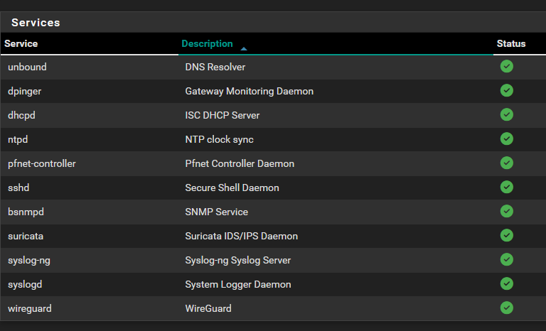

      I noticed for the endpoints
      /services/status
      and
      /system/package/installed
      they are not reporting the status correctly.
      for /services/status it's showing the enabled and status as "False" but the webgui is showing it as enabled and running.
      {'name': 'wireguard', 'description': 'WireGuard', 'enabled': False, 'status': False}
      {'name': 'syslog-ng', 'description': 'Syslog-ng Syslog Server', 'enabled': False, 'status': False}
      {'name': 'suricata', 'description': 'Suricata IDS/IPS Daemon', 'enabled': False, 'status': False}
      for /system/package/installed
      it's showing the latest version of the package available and not the "installed" version of the package.
        marcosm Netgate
        Thanks for testing! This will be resolved in the upcoming pfSense+ release.
