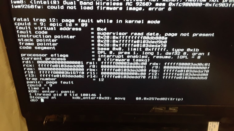

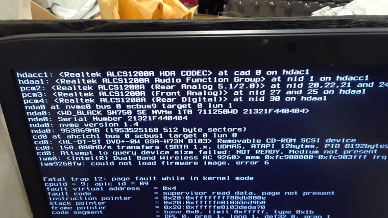

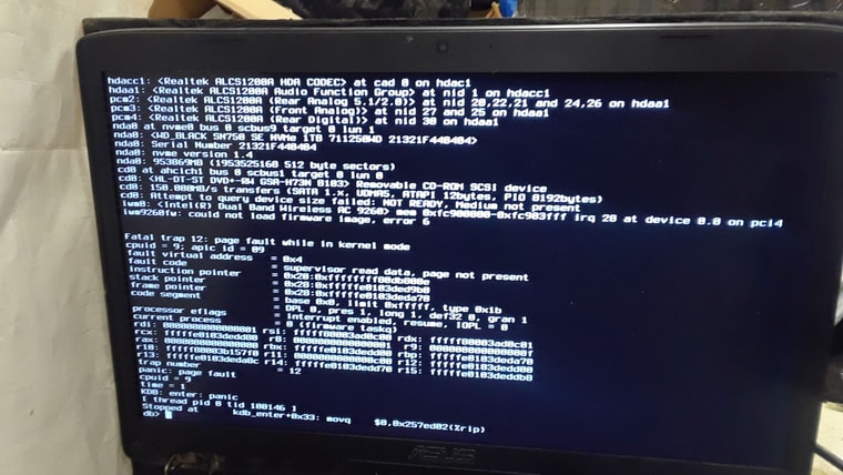

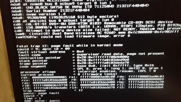

                here some cell phone screen caps cell sucks.. but i spent all day and just got fed up trying.. to try a different comp asus tuf x570 gaming 32 gig ram and i think its a 5600G cpu
                  That's a known issue with the upstream firmware API. See: https://redmine.pfsense.org/issues/16237
                  Pretty easy workaround shown there until it's fixed.

                    ah ok i read that link i not sure how you disable what in the bios
                    ill give it a try tommorow
                    create a file
                    /boot/loader.conf.local
                    and place in it
                    hint.iwm.0.disabled="1"
                    and thats all i need to do ?
                    not sure how you interupt the boot proccess
                    and then you type
                    set hint.iwm.0.disabled="1"
                    boot
                    right now it locks up the comp when it boots so i ended up saying i had enough of it today and had a drink lol...
                    so is it a freebsd issue or is it a pfsense issue?
                    and i never got the routing to not stop crapping out desktop was locked out again. makes you wanna drink too lol
                    and is there a time frame when they fix it.. i guess the next release of pfsense 6 months down the road? but like 2.8.1 probablly
                      stephenw10 Netgate Administrator @comet424
                      @comet424 said in Port Forwarding stopped working after upgrading to 2.8.0:
                      create a file
                      and place in it
                      Yes. Do that in 2.7.2 before upgrading.
                      When you see the loader menu with the 3 second countdown press ESC to reach the loader prompt:
