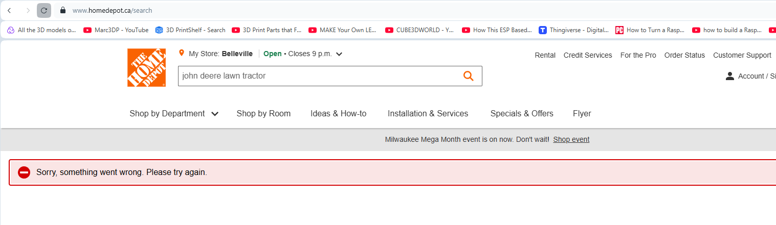

                          so i was looking at the logs and my desktop is slugish and it cant work homedepot website right it only partially loads websites or it will give me error that something went wrong... can that also be the pfsense acting up giving me issues? i also have a my vpn fail over issue or so could it be causing trouble? i have a vpn fail over i have one for canada 1 for usa but i disabled the one because everytime i try to do something in canada i get this stupid geo location garbage so i disabled the usa one.. as if i just run canada its fine for certain things if i have usa and canada then it gives me issues with geo location...
                          but here is the logs anyways
                          and i still have a 3mbs internet connction where i live they still burry lines for rural country folks and maybe by end of year i can get 1gb which i guess is like 1000 or 8000mbs
                          but can you see in the logs its just acting like crap
                          and do you think the current comp i have even though below the minium i googled is still ok?

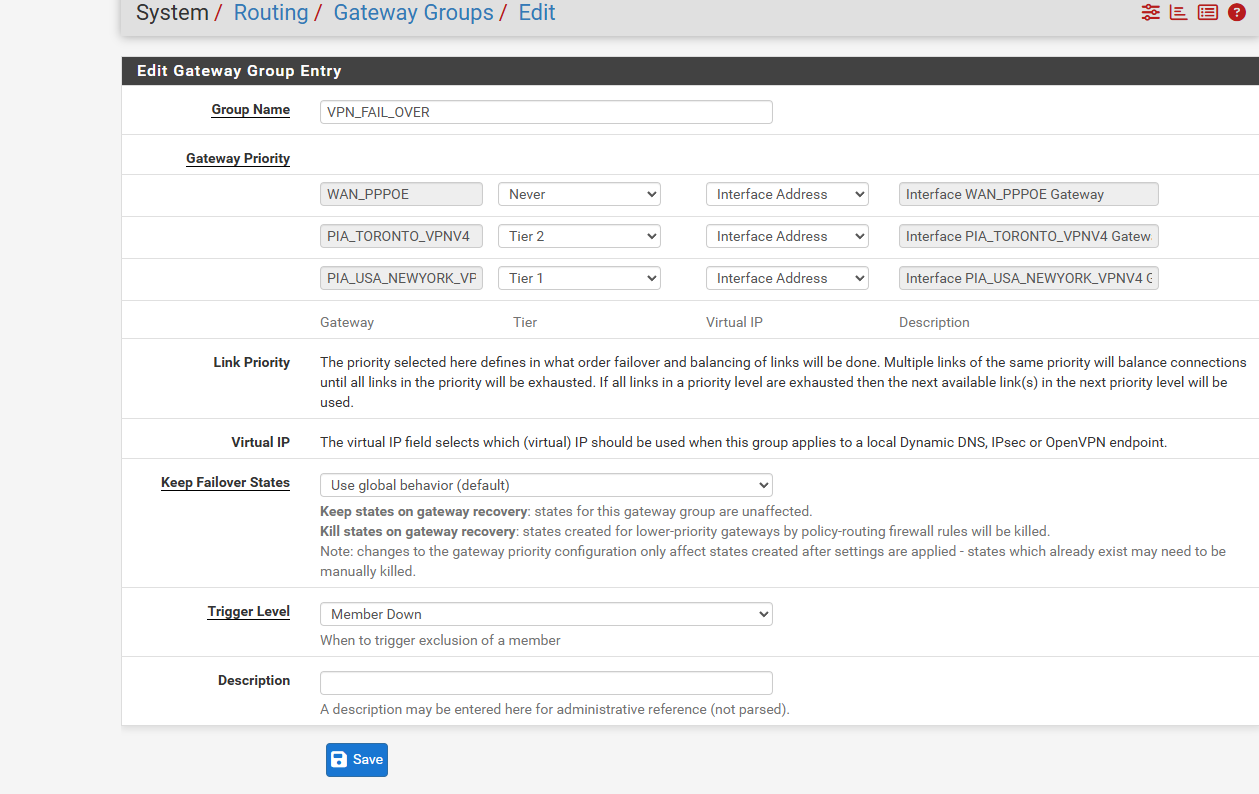

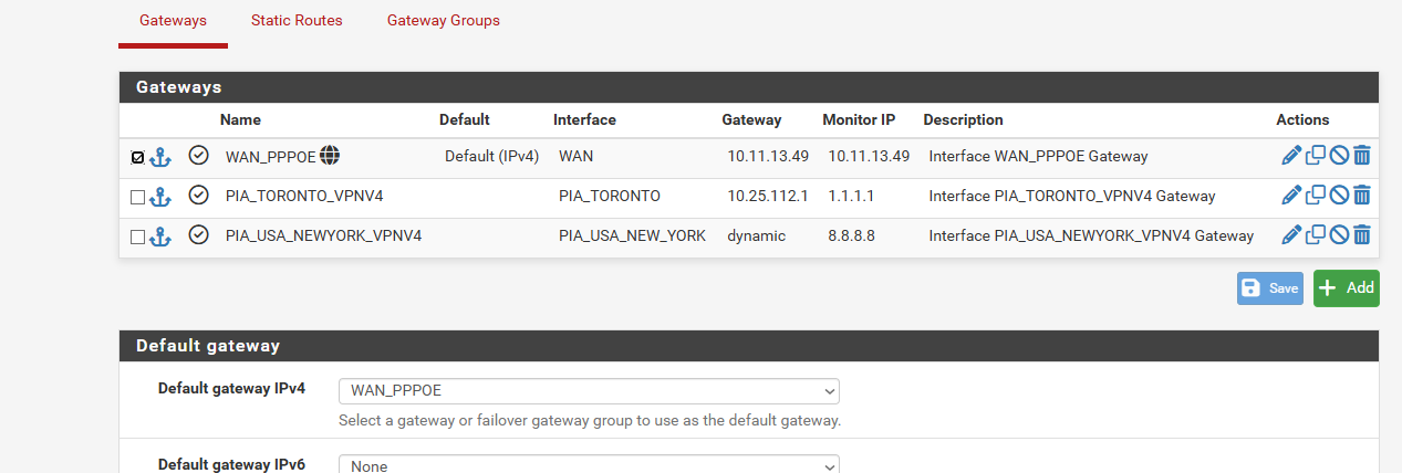

                            here is a screen shot for the vpn gateway fail over
                            so i used to have both to tier 1 in the past but i watched another video they said
                            you do Tier 1 and Tier 2 so you have the usa first and if it fails it moves to 2nd one..
                            i also enabled the interface for new york vpn but i still get those gateway errors... do you think its killing the php stalling it from all those errors of the tier 1 no gateway?
                            as i made this this way so i can switch back and forth from usa to canada if needed but mostly stick on the canada one
                              The logs look like you're seeing packet loss on the PPPoE WAN and then obviously seeing similar loss on all the VPNs that are over the WAN.
                              That in turn is triggering other processes for each gateway event.
                              The first thing I would do there is set an external monitoring IP on the WAN so you're not reliant on the ISP gateway responding to pings.
                              Are you routing all traffic via that VPN gateway group?

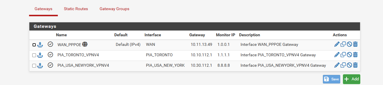

                                comet424 @stephenw10
                                so i have my network split so some IPs go out the VPN and others go out the WAN
                                so the WAN has a built in monitor IP the 2 vpns i set the monitor ips from setups setting up PIA
                                and what does the monitor IP actually do?
                                and what ip should i set it?

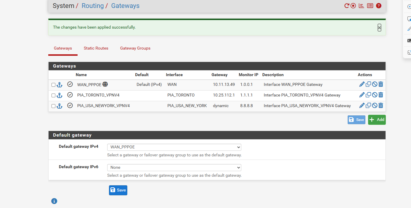

                                so you mentioned to change the monitor ip from the isp whats the purpose of that.. for like when i mention it seems to stall out and then i can sometimes ping 1.1.1.1 but i cant ping google.ca or any dns name just ip address..

                                    i added some new logs
                                    i set the Wan monitor to 1.0.0.1 i couldnt set it to 1.1.1.1 and i lost interent nothing worked.. i could ping 1.1.1.1 from the desktop but i couldnt ping google.ca
                                    i had to reboot pfsense
                                    so i got a log of the wan monitor ip 1.0.0.1 and one after i rebooted same link as i sent ya
                                      The gateway monitoring serves two purposes. It generates data for the WAN quality logging in Status > Monitoring so you can see how your WAN varies over time. It is used to detect a connection that has failed (depending how that is defined) so in a gateway group it can be added or removed; like you have with the VPN group.
                                      Since you only have one real WAN you don't need a failover action with that so you could set Disable Gateway Monitoring Action on that. That way it won't trigger unnecessary service starts when there is packet loss on it. You need that action on the VPN gateways in order to failover between them but you could set the thresholds higher so 20% packet loss doesn't trigger it if you regularly see that.
                                      The NY VPN shows as 'dynamic' because it's not connected. That gateway IP is pushed by the server when it connects.
                                      1.0.0.1 should be valid as a monitoring IP, I would expect that to work fine normally.

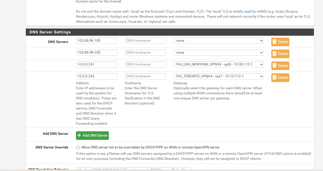

                                      How do you have DNS configured? Is it setup to only use the VPN gateways for example? That would explain why you could ping an IP but not resolve anything if the VPN is reconnecting.
                                      Also when you set those monitoring IPs pfSense adds a static route to them via the gateway they're on. So when testing connectivity from a LAN side client you should avoid any of those IPs in order to not get static routed via that.

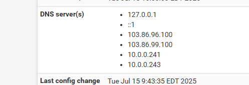

                                        3.. i must have a Routing issues on my Desktop i use like 192.168.0.49 for No VPN and 192.168.0.151 to be on the VPN as i have it split vpn and no vpn ips... and i got vlans

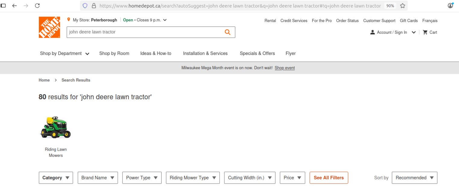

                                        now what i mentioned before on my desktop if i try to search on Homedepot.ca and i get error from there site saying something went wrong... now i can test on my ubuntu VM on my dmz vlan 192.168.40.x which uses WAN and it can search fine... so then i went and tested on my laptop i connect to my LAN and search same item on home depot and i get that same error something went wrong... but if i connect laptop which running windows 11 like the desktop then the search works fine... as i thought maybe its a windows 11 vs ubuntu issue but it wasnt
                                        as for DNS this is what i got setup but i dunno if its the Routing Bypass Policy causing the issue?
                                        but here is what i got
                                        and the 103.x.x.x DNS thats i still got in there from nordvpn i can delete those i guess i didnt yet
                                        so i thinking i got couple issues that routing you meentioned that could be killing php or i thinking comp not powerful enough and its just stalling out
                                        but cpu usage at moment is just 7%
                                        but here is some screen shots maybe i configured things wrong
                                        and i wish on the DNS page you could set like 1.1.1.1 for WAN interface but then keeps VPN and WAN seperate so there is no vpn leakage but it doesnt work that way.. i do have a no wan egreess too

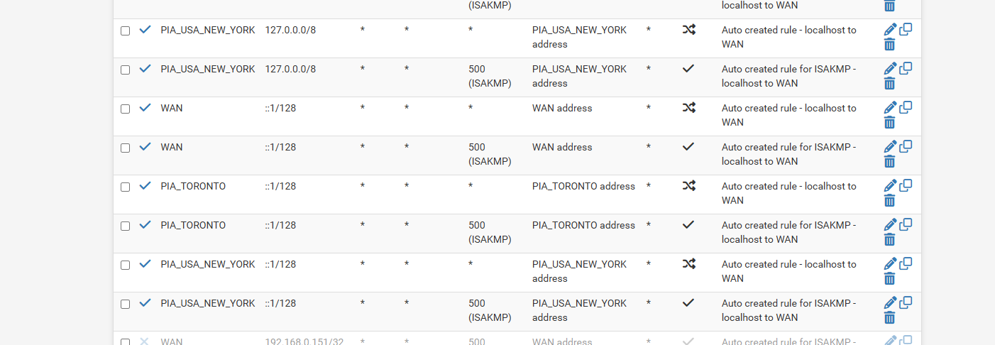

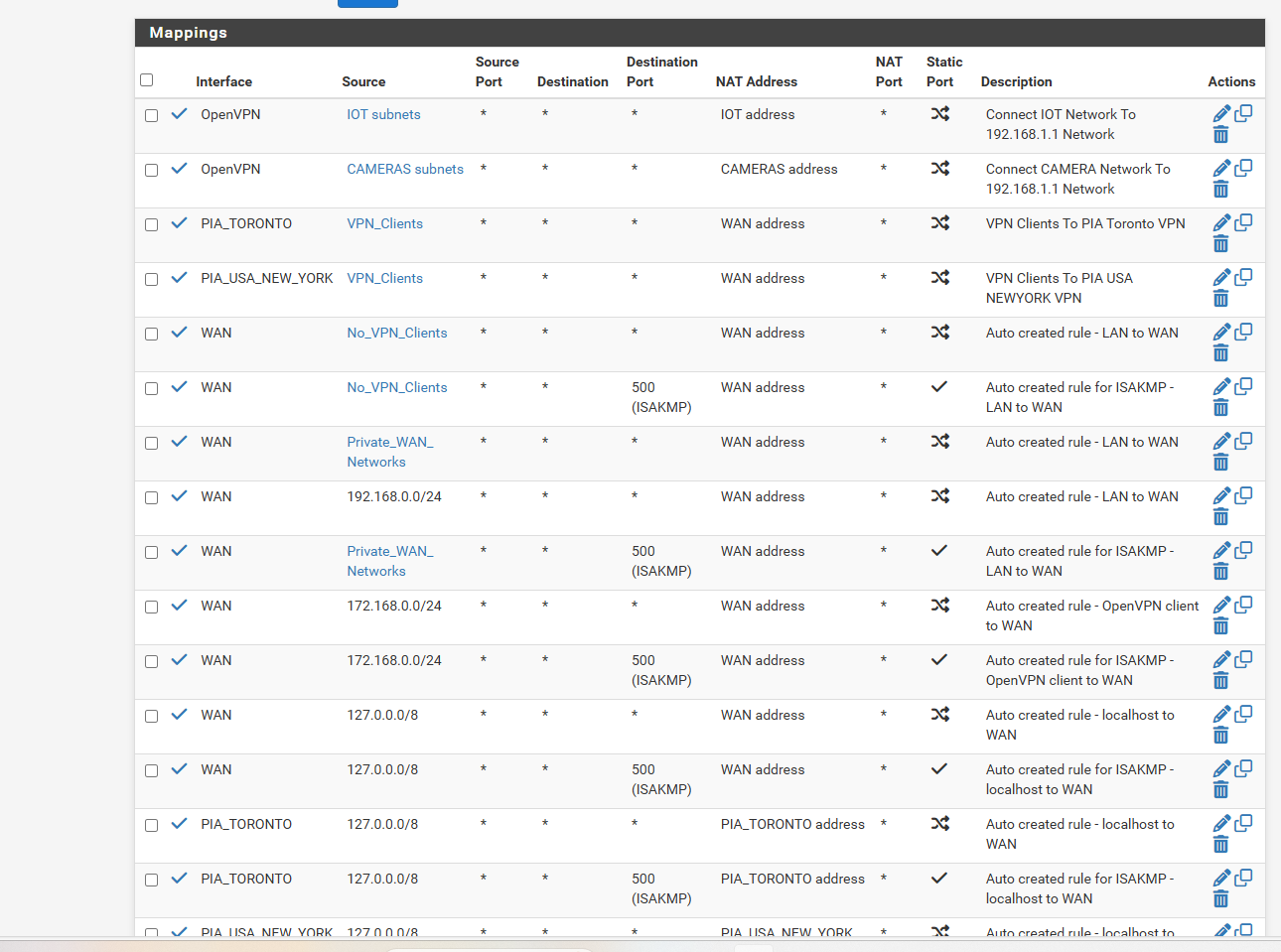

                                        but here is my screen shots. you probably see something i configured wrong
                                        pfsense 1.png pfsense 2.png pfsense 3.png pfsense 4.png pfsense 5.png pfsense 6.png pfsense 7.png ![pfsense 8.png]
                                        (/assets/uploads/files/1752588584425-pfsense-8.png)
                                        oh so when i have 1.1.1.1 1.0.0.1 monitoring ips dont test those ips for pining ping some other ip as it always knows that route there so gives a false postivie i take it

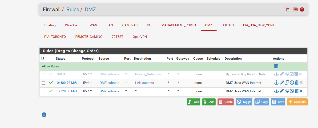

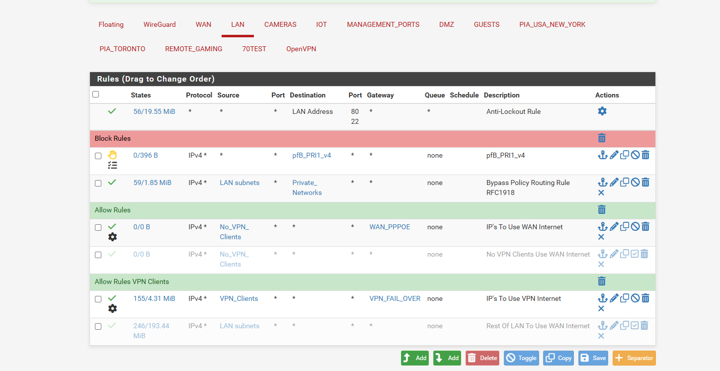

                                            so here is searching home depot on the LAN this is with or without behind the vpn
                                            and this here is same search HD on the DMZ network
                                            so definitely i got something configured wrong
