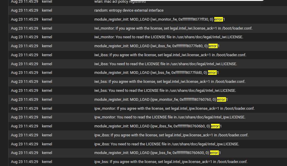

I see those:
Are they harmful?
No those are all expected and harmless even if you are using those wifi drivers.

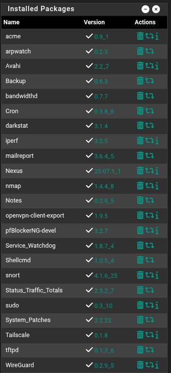

Packages are apcupsd, cron, mailreport, pfBlocker_NG, Status_traffic_totals, System_patches.

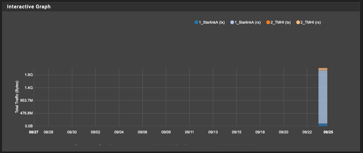

The only problem I can see is it appears all my history for Status_traffic_totals is gone.
I thought all packages left their data intact upon removal/reinstallation unless explicitly directed otherwise. What happened in this case?

I had months of usage measurements and now they're gone:
Before the upgrade, I removed the status_traffic_totals package in accordance with the best practices, and after I added it back. I did not see nor choose any other options. Other packages, like cron, email reports and pfBlocker retained all their configurations and data.
Hmm, I'm not sure Traffic Totals does back it up. That would be a lot of data in the config. The RRD data is not saved by default.

Yes, I would leave Traffic Totals installed across an upgrade. It's not a 'heavy' package that might consume enough resources to cause a problem at upgrade. I run it here and never remove it.
In fact in general it should not be necessary to remove any packages. I upgrade with Snort and pfBlocker installed and don't see problems. I would advise removing high resource packages (snort, suricata, pfblocker, squid) if you see or have seen problems upgrading.
