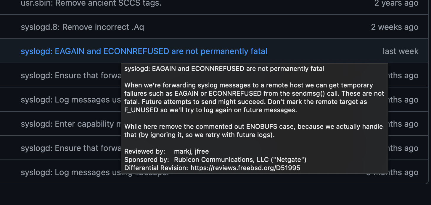

          I noticed that 2.8.1 RC released with a note about syslogd so I went to track down what actually changed from the redmine numbers final looked here to see "this change and description last week"
          did this make the 2.8.1 RC release ? wasn't clear from the timing and notes. I had previously upgraded / tested 2.8 as part of this issue and confirmed the failure there --
          the diff associated specifically with 2.8.1 RC doesn't list this so I'm guess it is not there.? (but sometimes stuff gets built and not include in the notes)
          if this noted change made the cut I'll jump through the hoops on 2.8.1 RC and test it, but if it for sure missed the cut not in this RC, I'll wait..

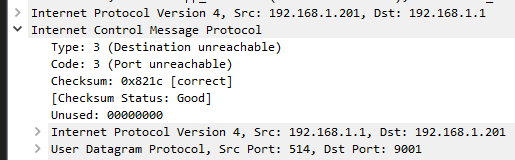

              Im sending to elastic angent and each time I kill the elastic angent and it stops listening on port 9001 the syslog stops sending.
              I do see a weird destination unreachable ICMP before that on my log collector host.

                It would be the recovery from that -- look at the code referenced - syslogd and the changes are specifically related to EGAIN and ECONNREFUSED messages (they were not being handled) -

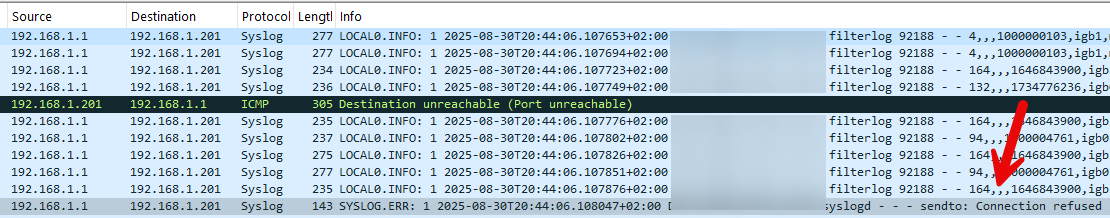

                  I see this in my logs:
                  2025-09-02 10:51:05.870660-07:00	syslogd	-	kernel boot file is /boot/kernel/kernel
                  2025-08-30 04:48:40.984805-07:00	syslogd	-	sendto: Connection refused
                  2025-08-29 02:28:48.148564-07:00	syslogd	-	kernel boot file is /boot/kernel/kernel
                  2025-08-23 04:47:30.000287-07:00	syslogd	-	sendto: Connection refused
                  2025-08-19 11:35:12.527643-07:00	syslogd	-	kernel boot file is /boot/kernel/kernel
                  2025-08-19 11:30:45.904435-07:00	syslogd	-	exiting on signal 15
                  2025-08-18 18:21:26.032560-07:00	syslogd	-	kernel boot file is /boot/kernel/kernel
                  2025-08-16 04:47:40.955468-07:00	syslogd	-	sendto: Connection refused
                  I get sendto: Connection refused in my logs, and that's when syslogd dies.
                  You can see this almost always happens for me around the same time at 4:48AM. It's also every 7 days.
                  I run Graylog via docker on my server. Every Saturday morning I backup all of my docker containers starting at 4 AM, and this means stopping each container while it's being backed up.
                  I tested this today by stopping my Graylog container, and in less than 2 hours syslogd had stopped running on pfSense.
