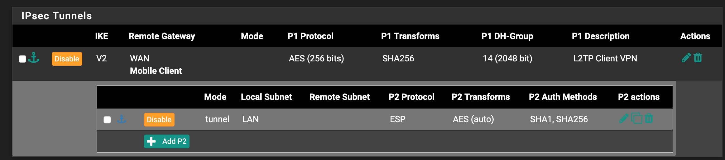

  • IPSEC won't connect beyond Phase 1
    7k Views
    K
    @gh0stwr1ter Documentation PFSense is also written that the possible problems with connection of L2TP/IPsec clients behind a NAT. And it is recommended to use IKEv2. received packet: from 75.129.232.186[4500] to 144.202.66.15[4500] (92 bytes) I also recommend setup remote access using IKEv2 For example, https://docs.netgate.com/pfsense/en/latest/vpn/ipsec/configuring-an-ipsec-remote-access-mobile-vpn-using-ikev2-with-eap-mschapv2.html
