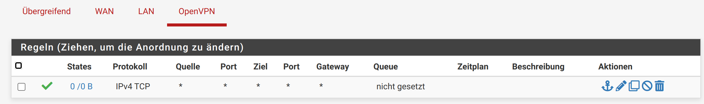

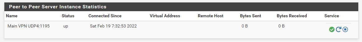

  • peer-to-peer and site-to-site
    867 Views
    @trever
    So you fail to access VPN clients?
    Consider that each client run its own firewall. And firewalls of different operating systems can have different default settings naturally.
    Maybe you noticed that your issues concerns Android devices only.
